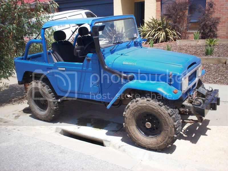

It has got some leaves taken out and does flex OK. Height wise I am guided by Matt Mcinnes who likes them lower to keep centre of gravity down. I am about to do a 60 series power steering conversion from the oem power steering it has now though, gods knows where I start :D
