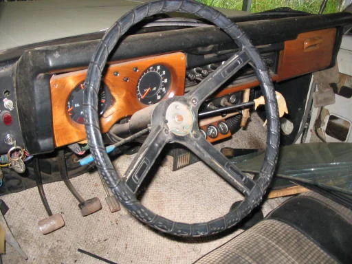

The dash looks like:
attachment.php
I'm curious if this was stock. Also, is it a veiner, wood "colored" plastic, or chunk of wood?
Getting hyped up on a "good" solid replacement to the Tacoma:doh: Okay, only a good replacement to a cruiser junky:lol:
Memorex. Not a fan of wood there, but it looks like a nice job of it.
The 55 didnt come with a wood dash. It was the first real Stationwagon that served a dual purpose so the interior was kept as spartan as Toyota could to keep costs down and also give some sorta creature comforts to families. It was still used in military and industry around the world. I prefer the Toyota HD Clutch kits as they were the ones used for military and industrial use. My last kit I bought at Toyota wasn't any more money then the standard kit.
Anyway wood dashes are custom or they are homemade to replace the heat wrapped stock dash panels.
Nicely done, if you like a wood dash but definitely NOT stock.
did those gauge come from the 71? neither of those are 71 vintage gauges, both are later, speedo is late 76 or later, and the other cluster looks like 78 or later.
the metal rings around the gauges arent chrome. they are actually hidden by the stock dash pad, and are just zinc plated. PS on the speedo one, there are three very small flat head screws holding the ring on the metal housing.
