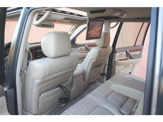

If u have an overhead dvd screen, check to see that there is no dvd in the rear player. Even if ejected and left in place, it will continually try to eject it. Had this issue myself.
