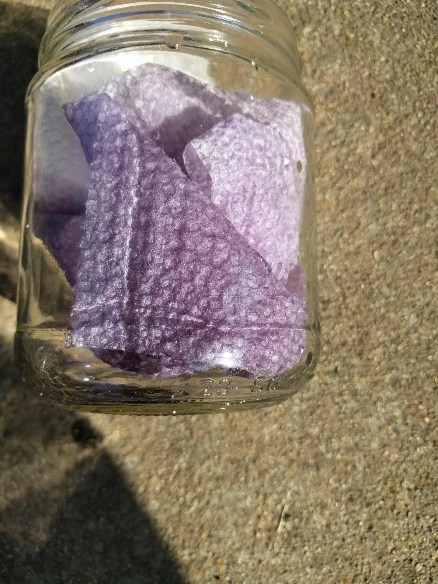

I am preparing to follow the steps outlined in this thread to change the fluid in my 2004 LX470. I checked the fluid a couple days ago and it was a Purple color. Do you think the PO used royal purple or is this the color that WS ATF will turn over time? It may not matter switching between WS ATF and Synthetic, but I just wanted to double check. If PO used something other than WS ATF will I need to do an even more thorough flush? Any advice is greatly appreciated.
Now I fill with Dexron VI that is back compatible with Toyota WS, it's also red not purple.
