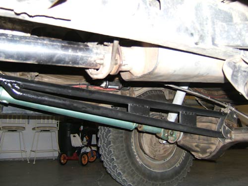

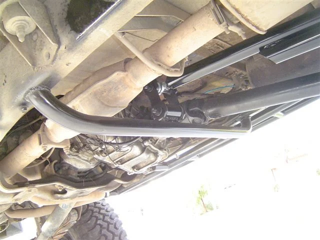

here a pic of my bar I just built.. its not nearly as long as it looks.
attachment.php
attachment.php
I have no gussets since the forces on the bars are compression & tension & all major bending will be near the shackle.
Hopefully I'll get it offroad in the next few weeks to put it thru its paces.
attachment.php
attachment.php
I think the end of the lower tube will be a major stress riser for the top bar. Let us know if it bends like JDay's did. I personally like Woody's design, and thats what I used.
Edit: if you are worried about AS, mount the bar to the shackle as low as posible to reduce it. That is prolly why some people experience wheel hop after intalling a wrap bar.
the reason I bent the bottom bar & ran it parallel to the top bar was to hopefull spread the load evenly over the length of the top bar & keep stress points to a min. Its all made from 1.25" sched. 40 (1.7" od.) so I think it will be ok.
John says his is made from 1.5" sched 40 (1.9" o.d.) but to me it looks more like 1".
I can detect no AS in my bar.

The AS comment was thrown in for the people talking about it in earlier posts.

Are yur drive shafts on backwards?
No..
The CV is at the tcase end
