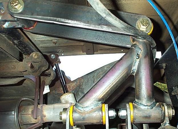

check this out'?
bandy rooster said:
check this out'?
Looks like a good bar, but will it work under atriculation?
I see the bushing on the lower part, but wouldn't the centre of the diff move under flex,v ie side to side?
or again, the centre of the diff moving 1-2 inches from full flex to full flex on the opposite side?
ANy one understand me? Clear as mud?
Scott

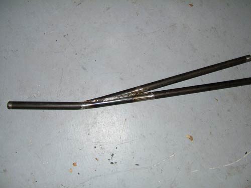

The y-shaped bar I built like you have shown, bent right after the point where the two pieces are joined. I imagine it would have eventually broke. I replaced it with a full length triangulated member with gussets along the center.
Bent like this:
