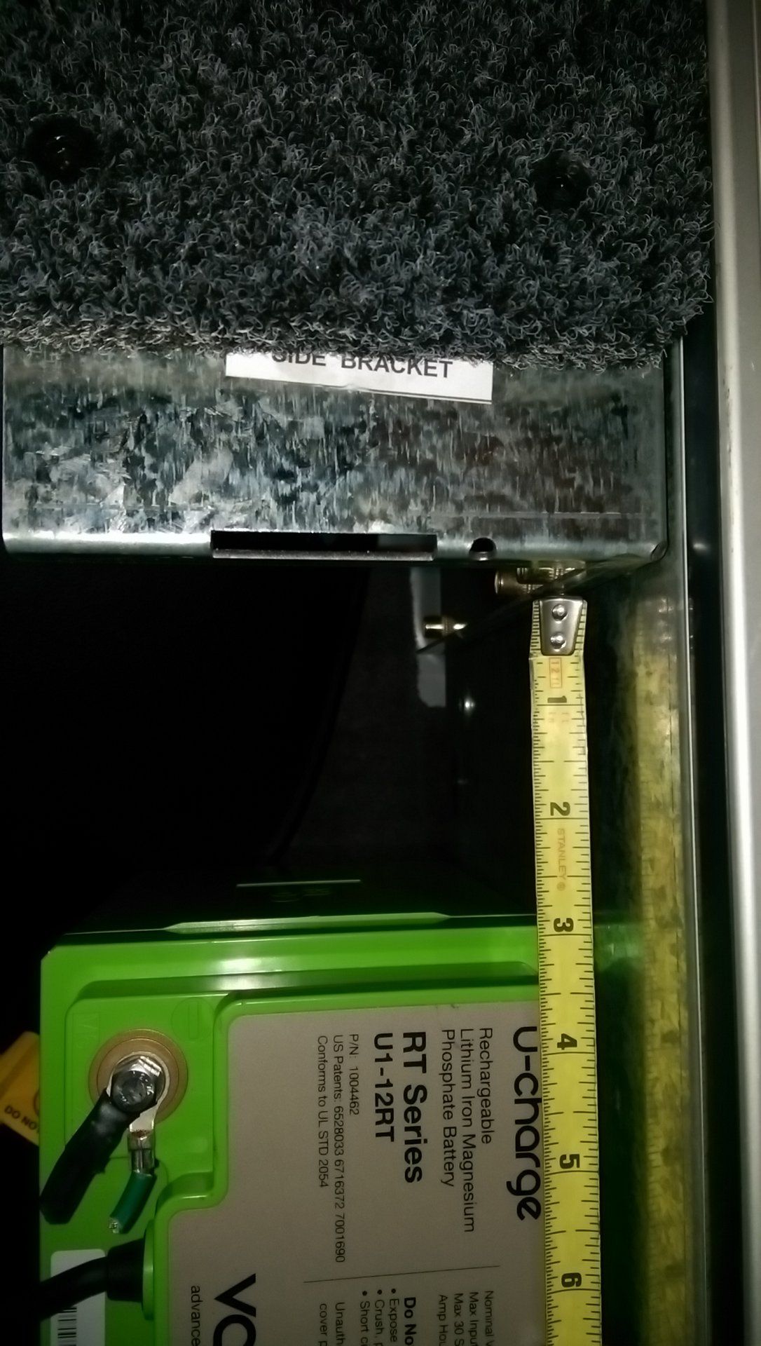

Honestly its such a close fit that if not for the rounded corners on the battery it wouldn't have worked. I'll probably bend some metal to put a brace over the top, and maybe some heavy strength velcro on the bottom. Outside of a violent flip/rollover with more than one rotation, this thing isn't going anywhere as-is.
To tie down the batteries, I bolted a flat tie down handle from Lowes to the side of and near the bottom of the ARB box, and then used a couple of long 175 lb zip ties. So if you need to take them out just cut the zip ties and replace them.
