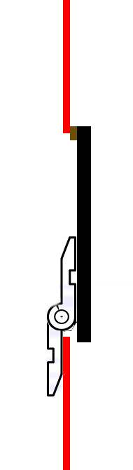

I'm definitely thinking of fold down. Maybe using a simple small acrylic hinge with good quality double sided tape holding it to the plate and the dash. I don't want to drill any holes. And then hold it in place with some thin adhesive backed magnet. It would stick out a little bit but I think that would be okay as I don't want to put a knob on it and you need a little space to get your finger/fingernail behind it to pull it down.

What I need to do is to be able to flip flop one side so that there is an offset. Then I would affix the lower part to the inside of the dash and then the other piece would stick out a little which would be perfect to affix the delete plate to.
Plastics are not my forte, so that's out of my experience. I've never seen anything like that hinge before, but if not having a hidden hinge works for you I would have to say that it looks do-able to me.

It will be hidden behind the radio delete plate if I can swap the hinge. I'm assuming I should be able to disassemble to get the configuration I want. They're super cheap so I'll probably buy a couple just in case I end up breaking one.
Here's kind of what I'm thinking. Not to scale. Again, double sided tape to hold everything together. Super lightweight so should be easy to hold it up. I watched a video at Tap Plastics and the pin is easily removable so I could likely do this offset.
