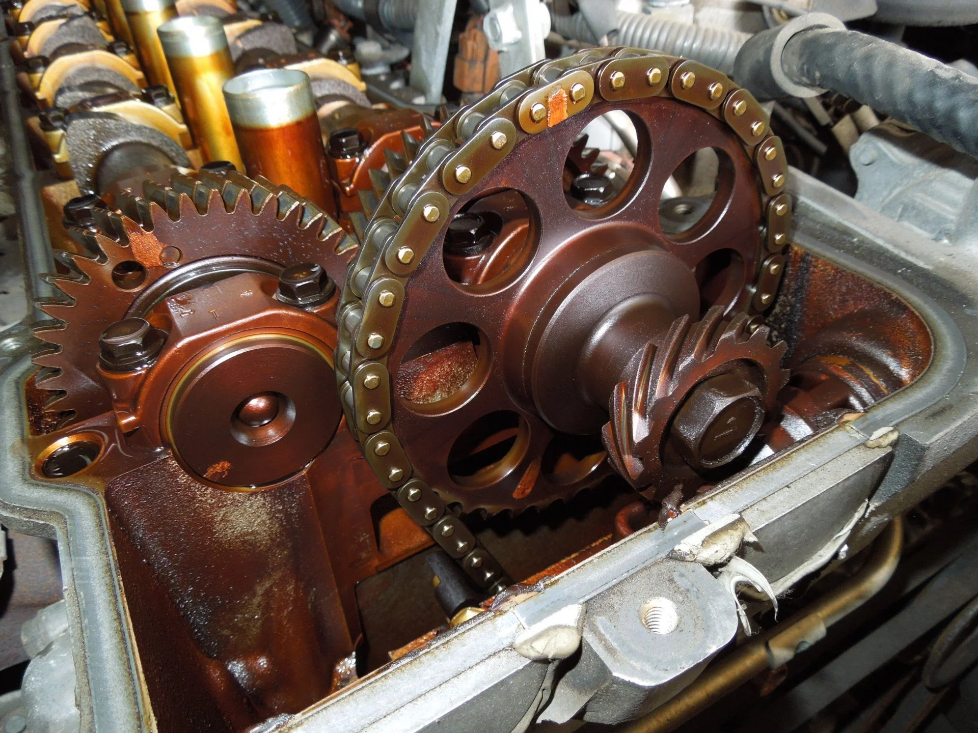

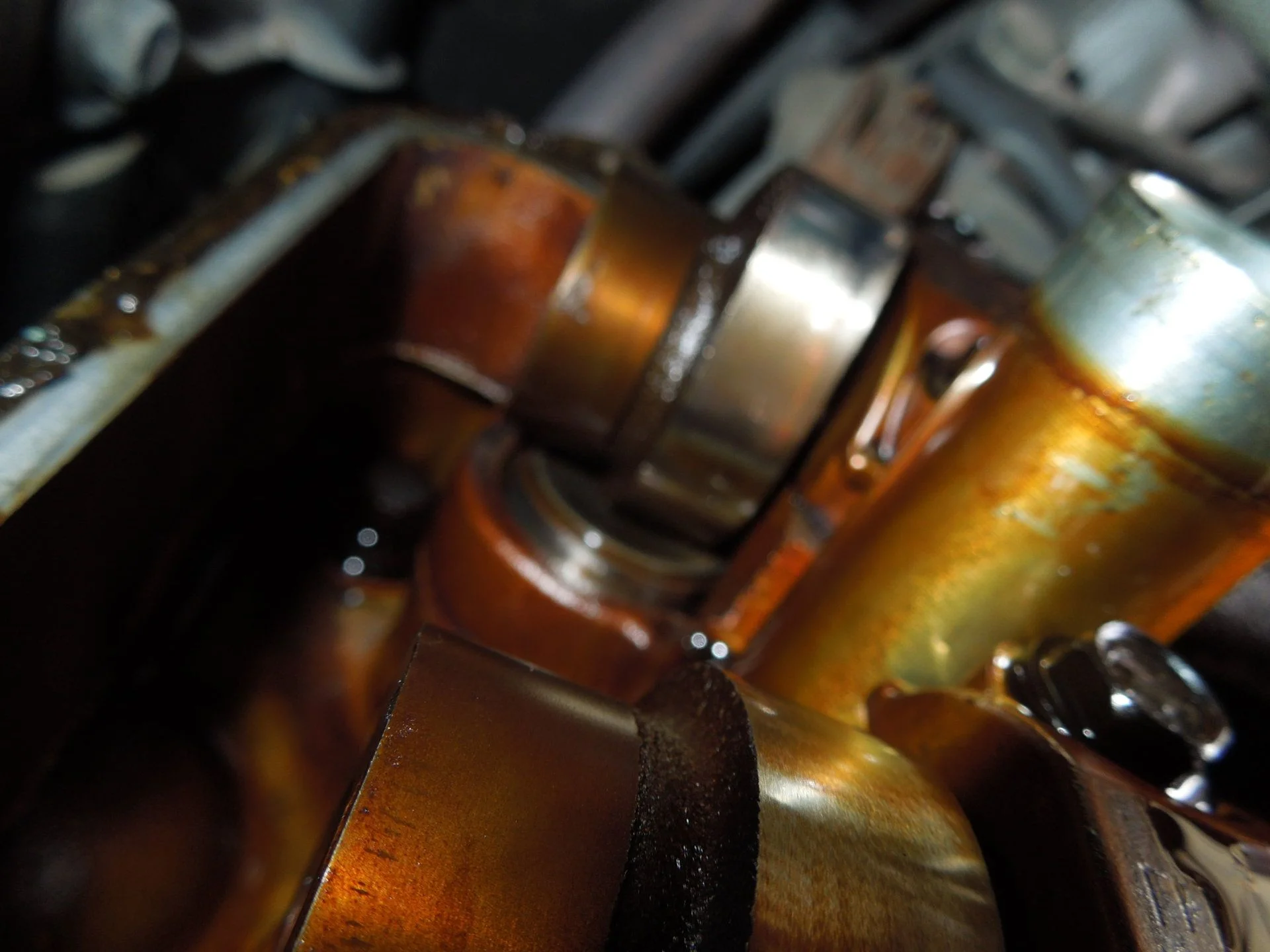

Sounds like a valve stuck open- hits the top of the piston and stops it. Could just be rusted from sitting? Looking at your borescope pics it might be on the #4 cylinder- looks like a valve print on the left side. Worth checking out before you do a massive teardown anyway, just pull the valve cover and take a look. You might be able to free it up without pulling the whole thing apart.

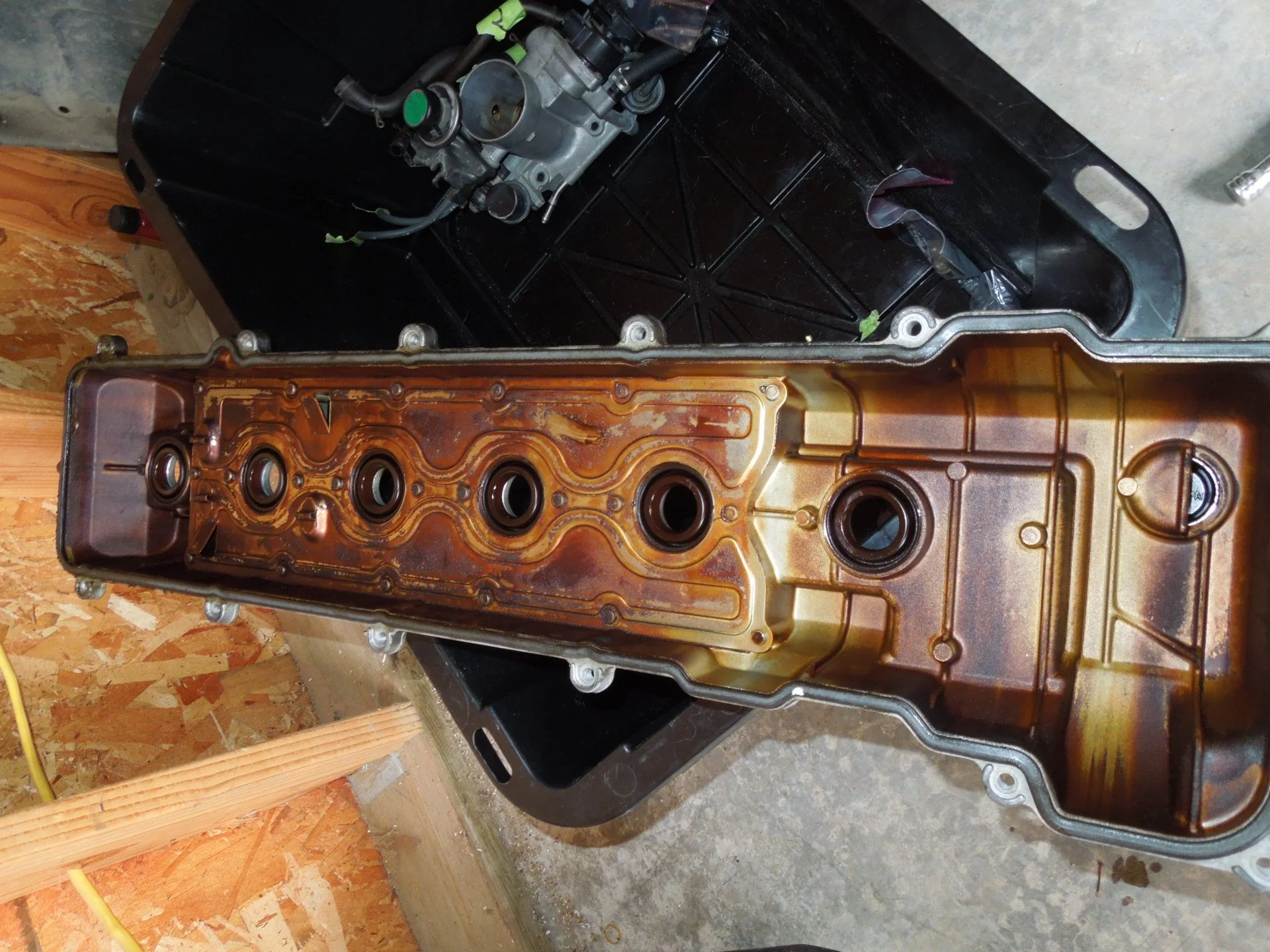

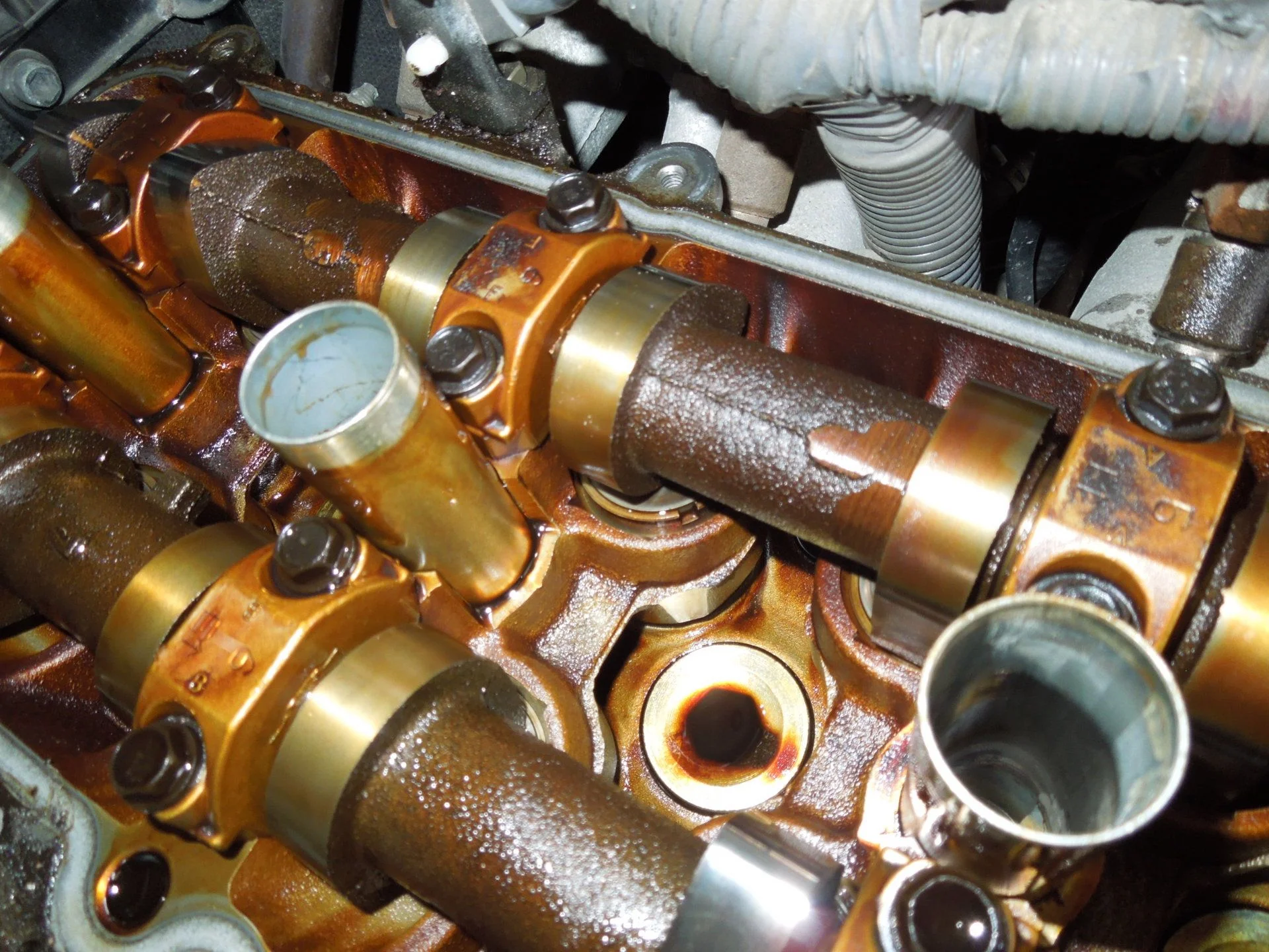

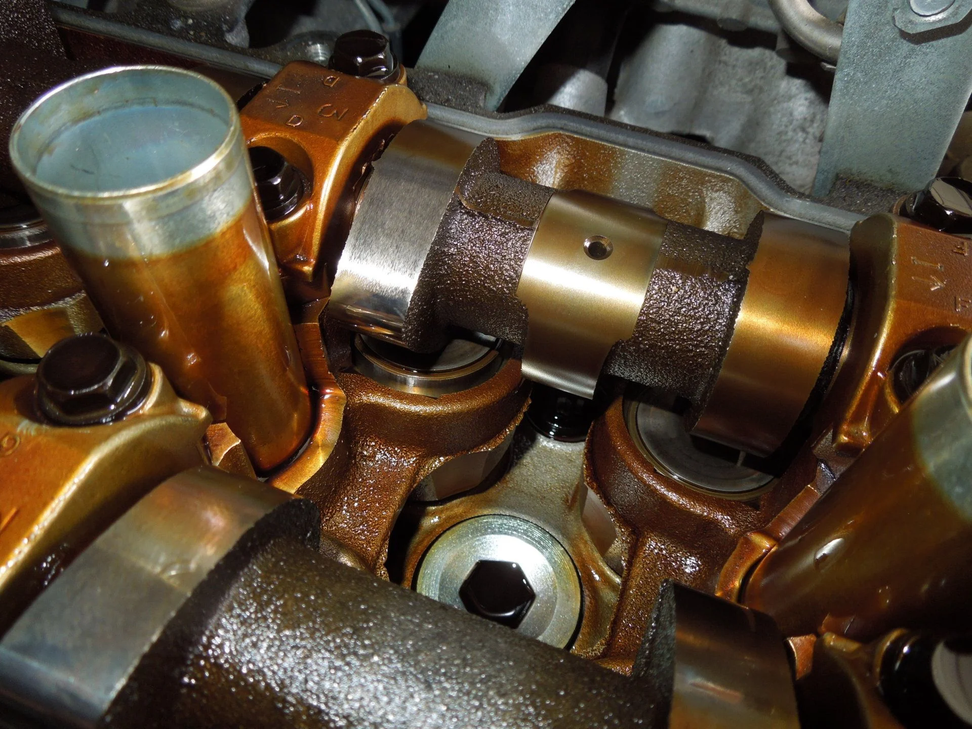

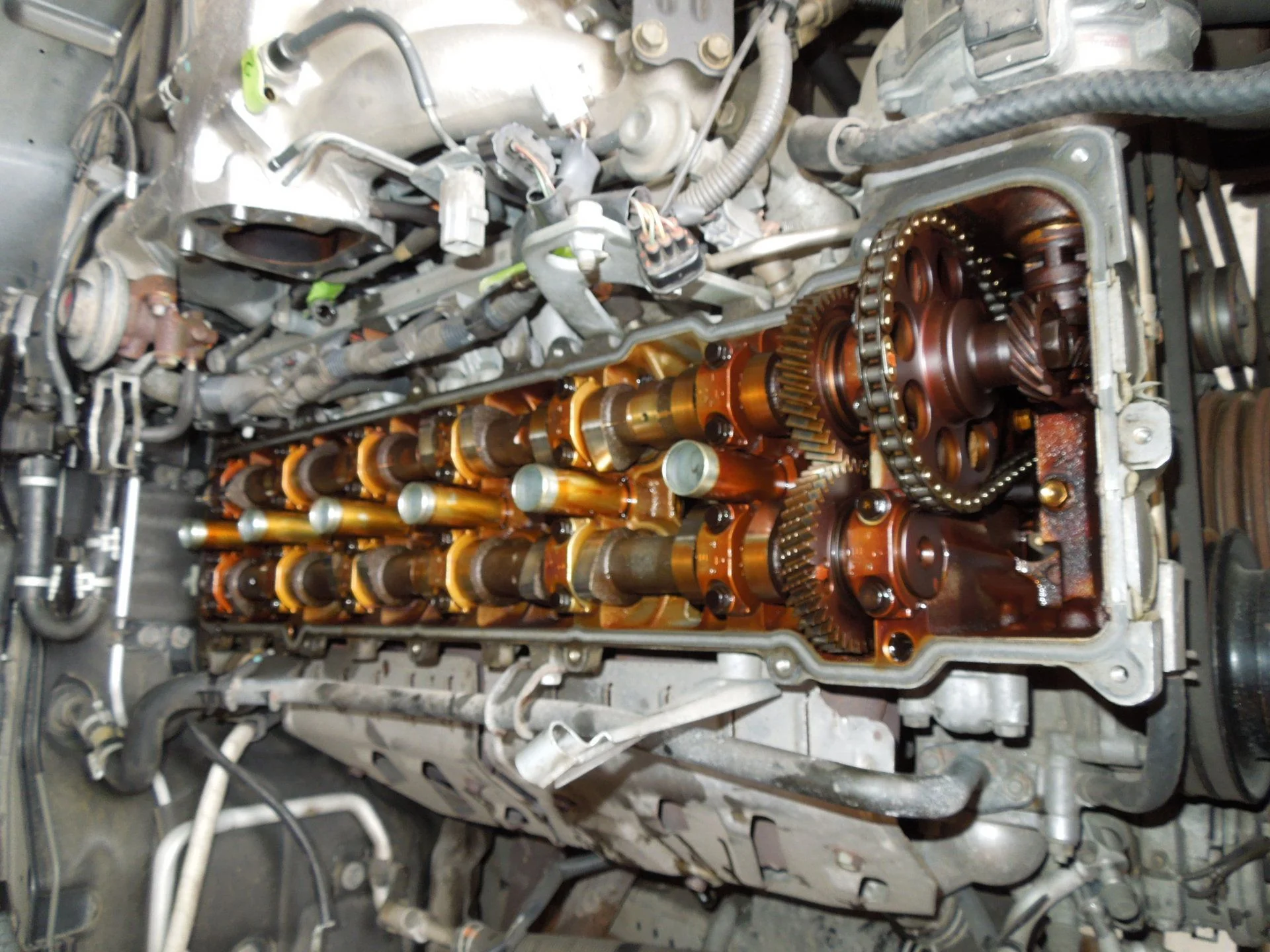

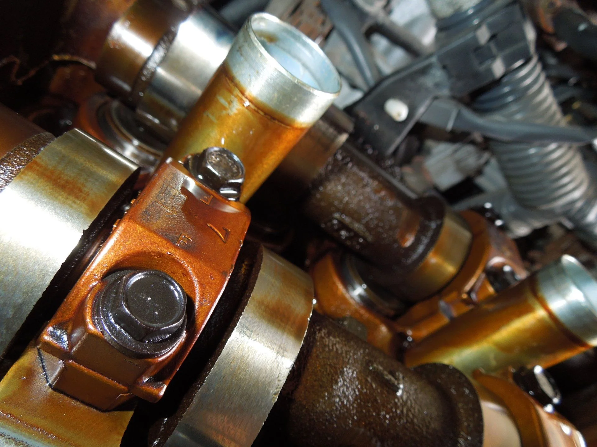

So today I had a few hours to pull the valve cover, belts, and throttle body.
I couldnt find anything visually wonky under the valve cover. Its a little grimey, but not horrible.

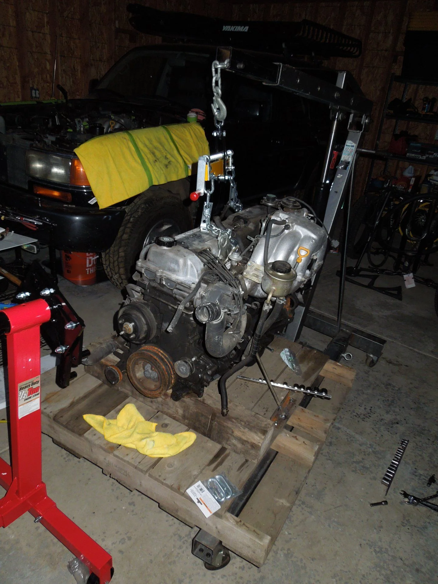

So I decided I will pull the whole drivetrain. It will give me a look at everything and see if there are other seals, etc. on the tranny/tc that need to be done.

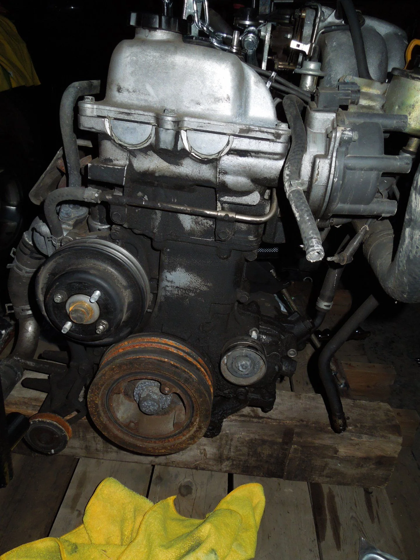

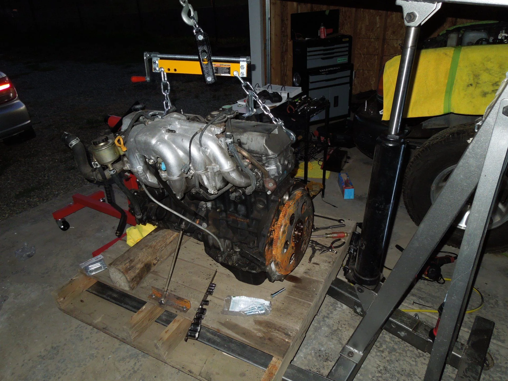

Well the "new" $400 1fz is here. She's dirty. Unknown miles. Going to tear into it and probably do the head gasket for the sake of doing it while its out.

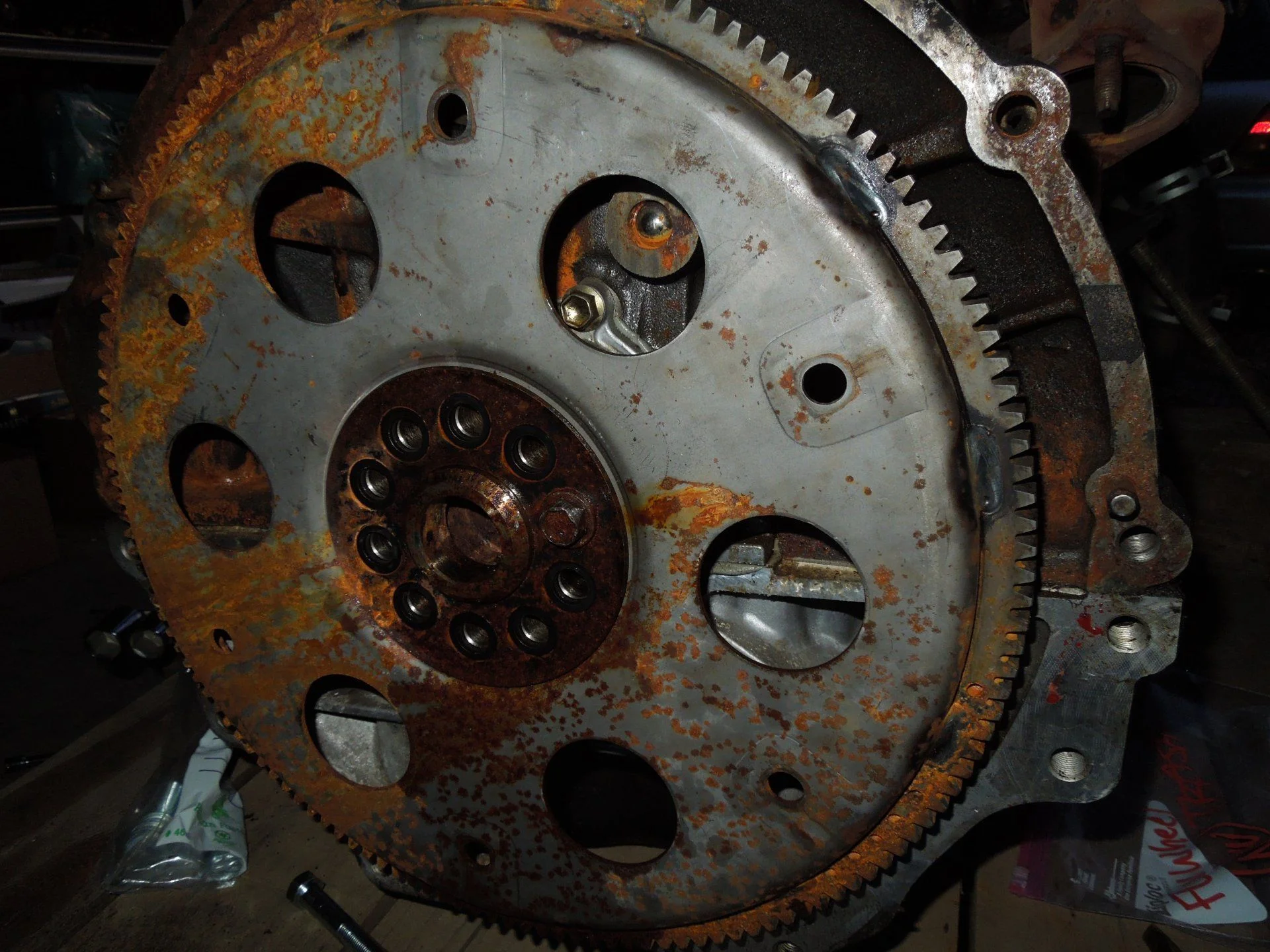

Was removing the flywheel to get it on an engine stand and one of the bolts, only one, completely rounded off. seem like super soft bolts...
Any one have suggestions to get it out?
