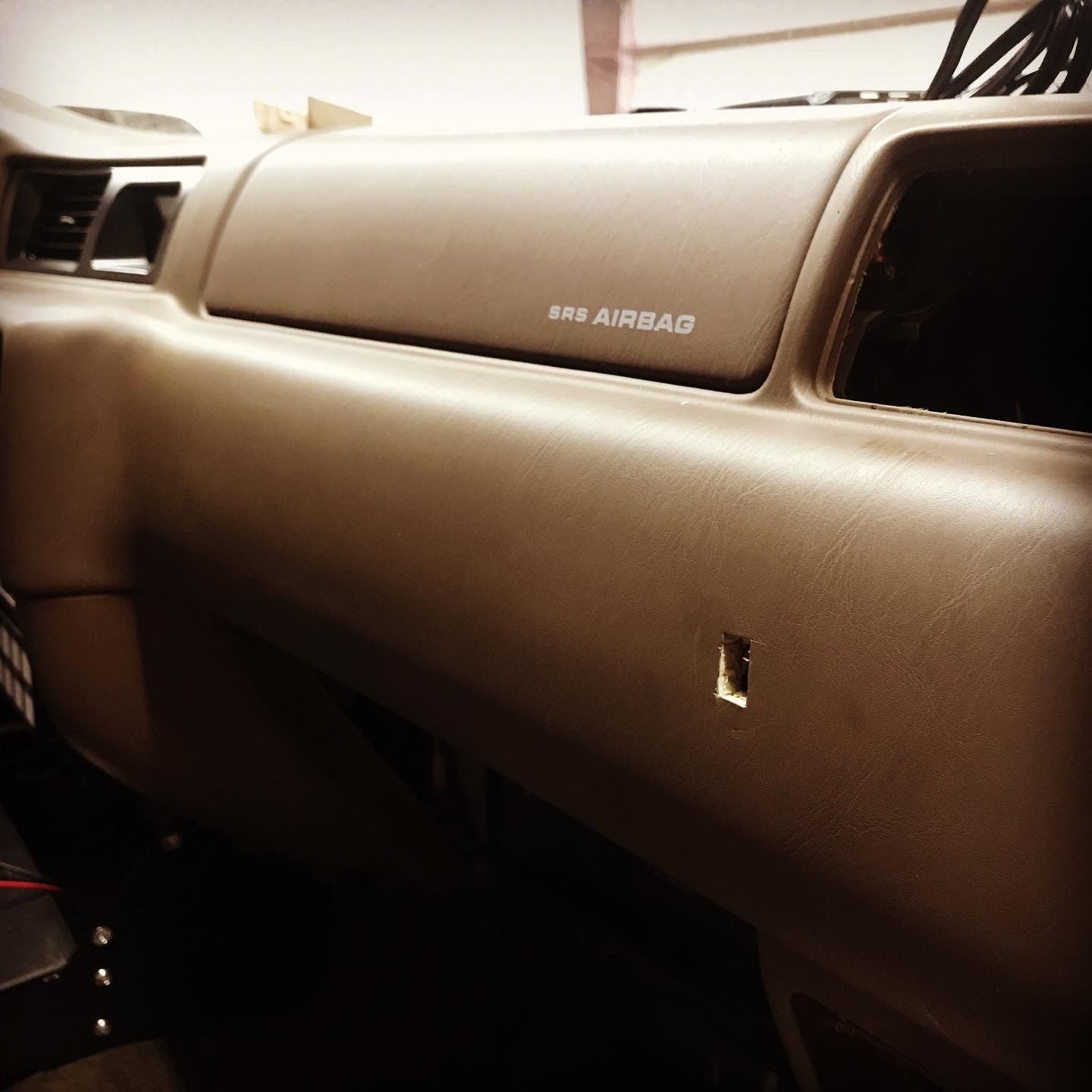

After the glovebox and some vents were removed, you can see where the mounting hardware is under the dash. From there it’s just making sure you don’t mess up 😳

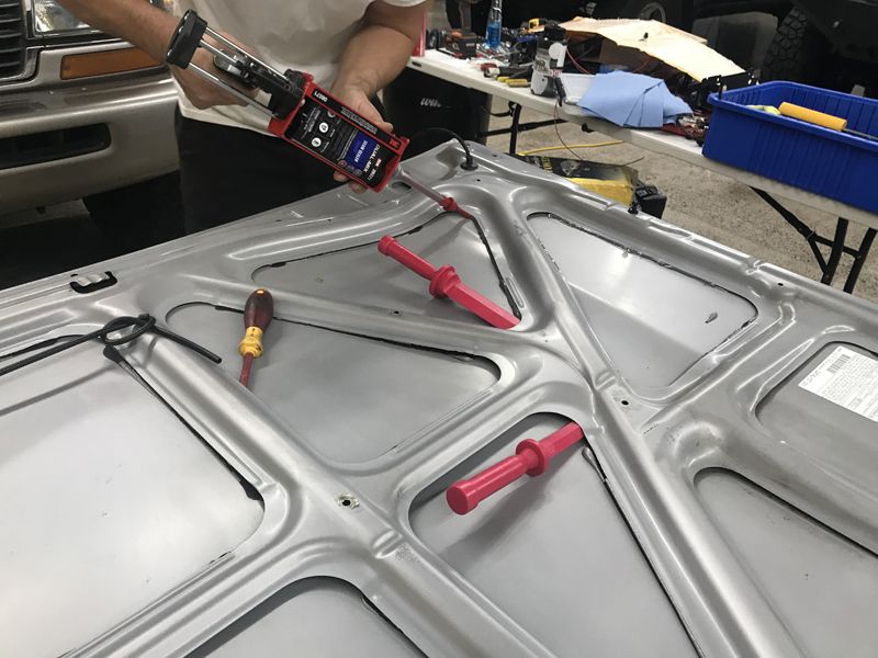

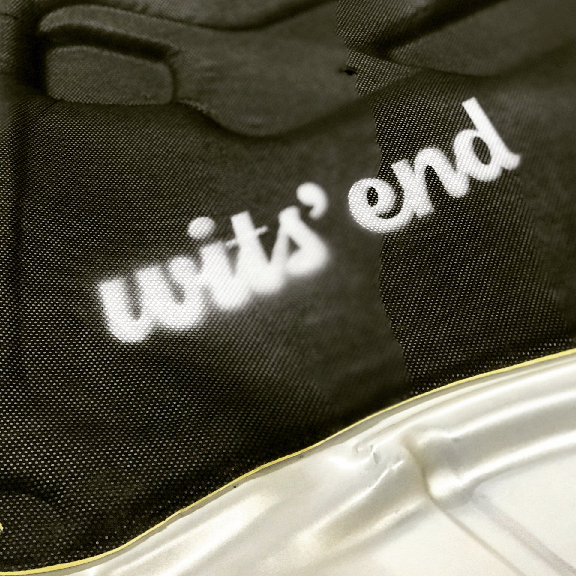

The edge lifted on the left side juuuuust enough for the high temp white to spray UNDER the freaking template 😩
Got some repair work to do in the morning before I get lost in orders. 😞

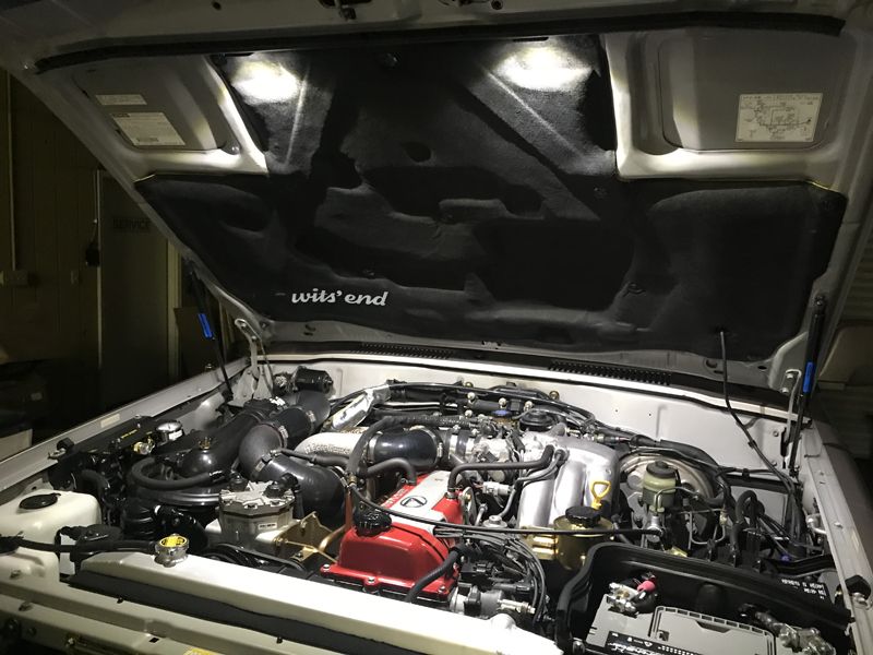

Is that underhood insulation!
Ugh. I need to replace mine, but debating with myself about buying a new insulator only to cut it up (hood vents and scoop)

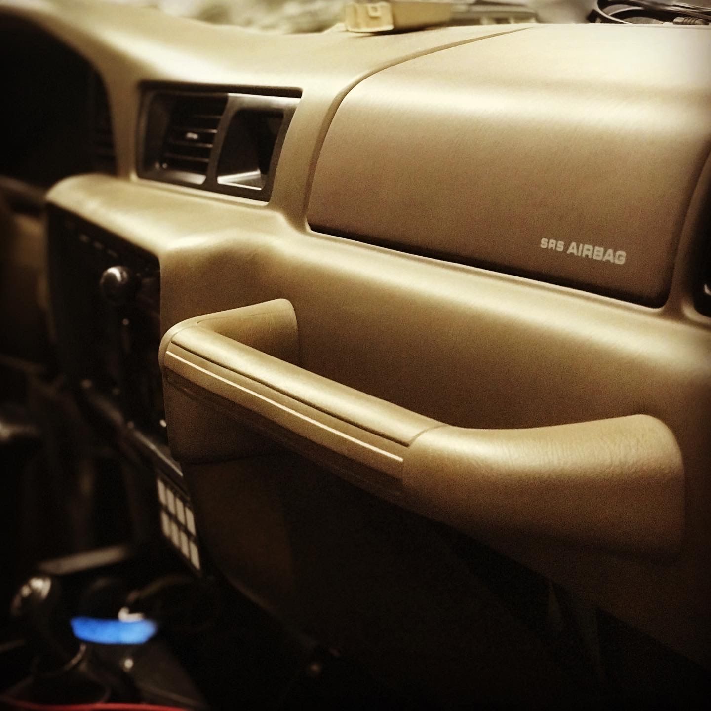

my daughter uses this handle constantly for tik tok videos during our trips, lol.......

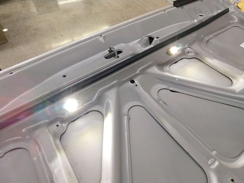

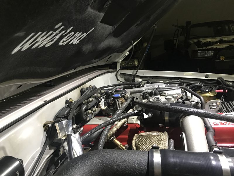

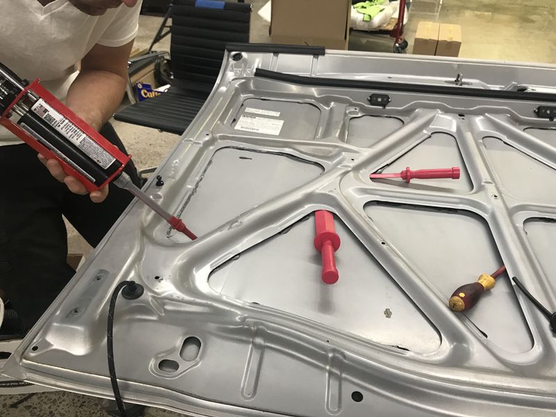

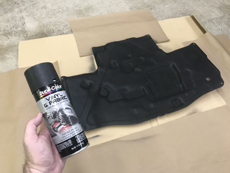

Did a LOT of refreshing on the hood so I figured I'd do a separate thread:
Basically the end result...

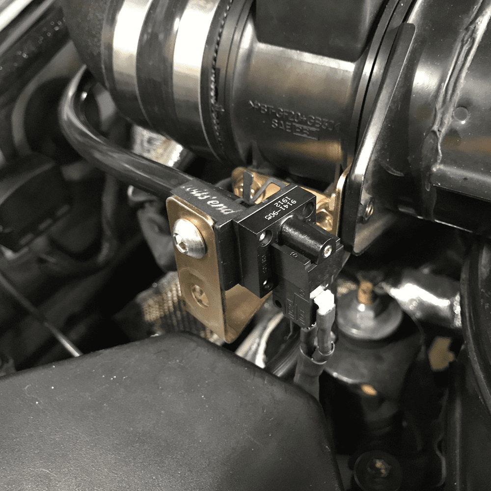

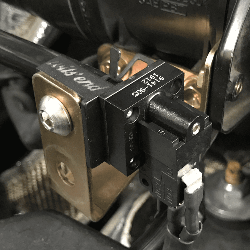

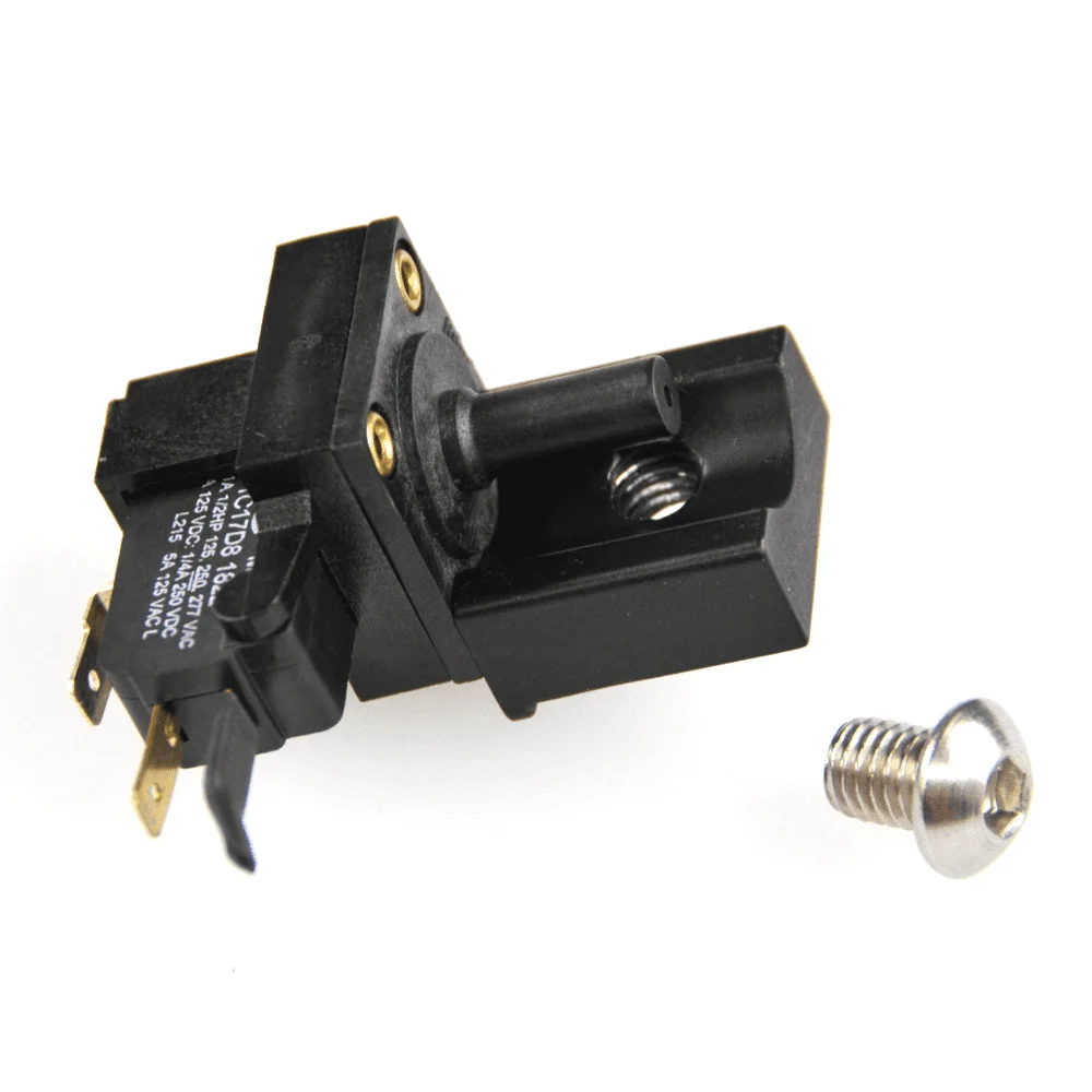

On the methanol kit, I've got everything worked out but its not quite production ready because its not as bolt-on as I'd like it to be yet. Here is a simple mounting bracket solution for the boost switch. Its a simple hobb's switch. Its adjustable but I'll be setting them all here before they go out. Switch is normally off and once boost hits 2psi it connects to ground which turns on the pump. Let off the gas pedal and the throttle plate closes so no boost so the switch disconnects ground. Its crazy simple.
The issue was just about the mounting of the switch. A simple mount was made and it secures the switch to the unused bracket off the MAF. Works perfectly. I'll be making up a batch of these to go with the eventually kit.

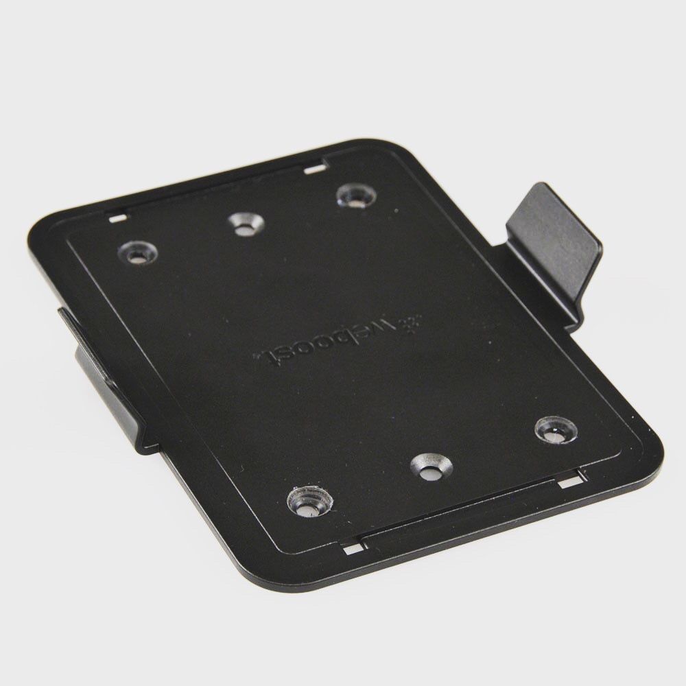

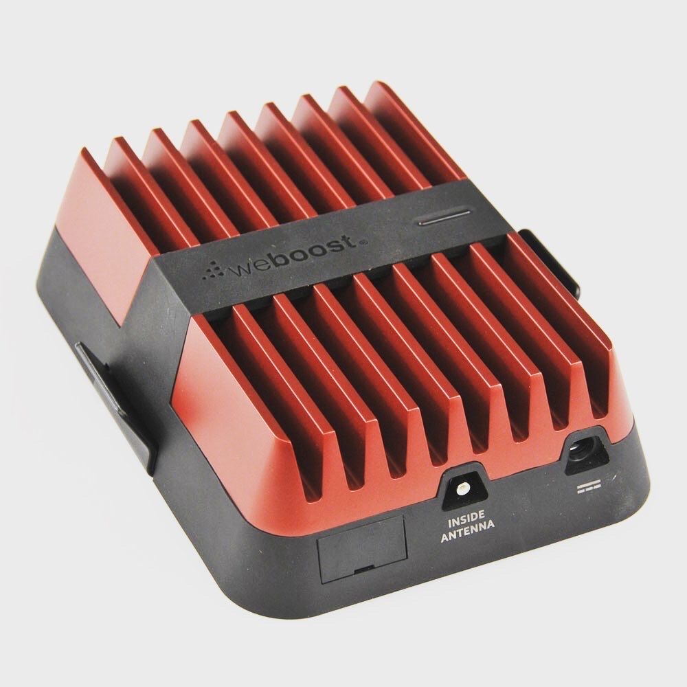

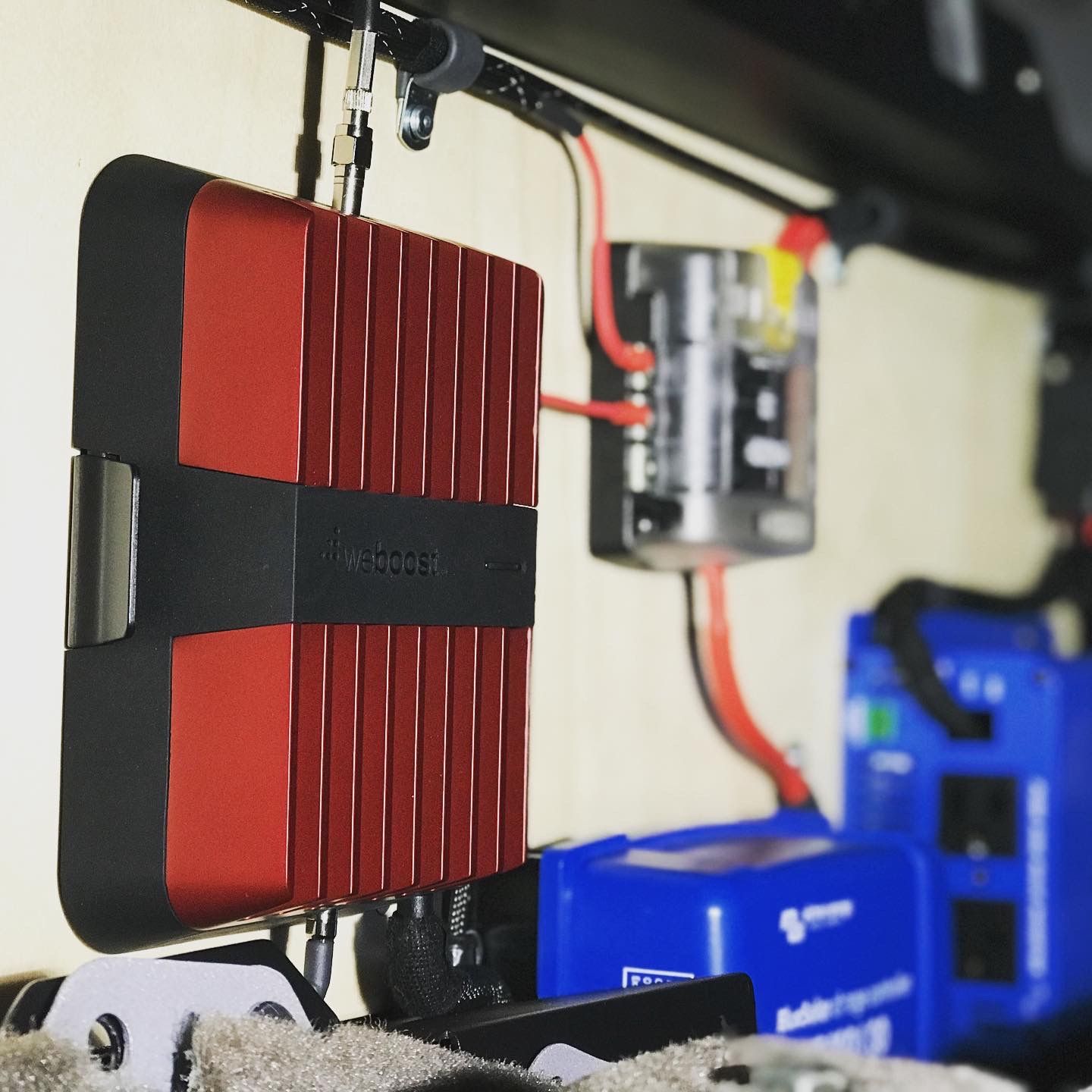

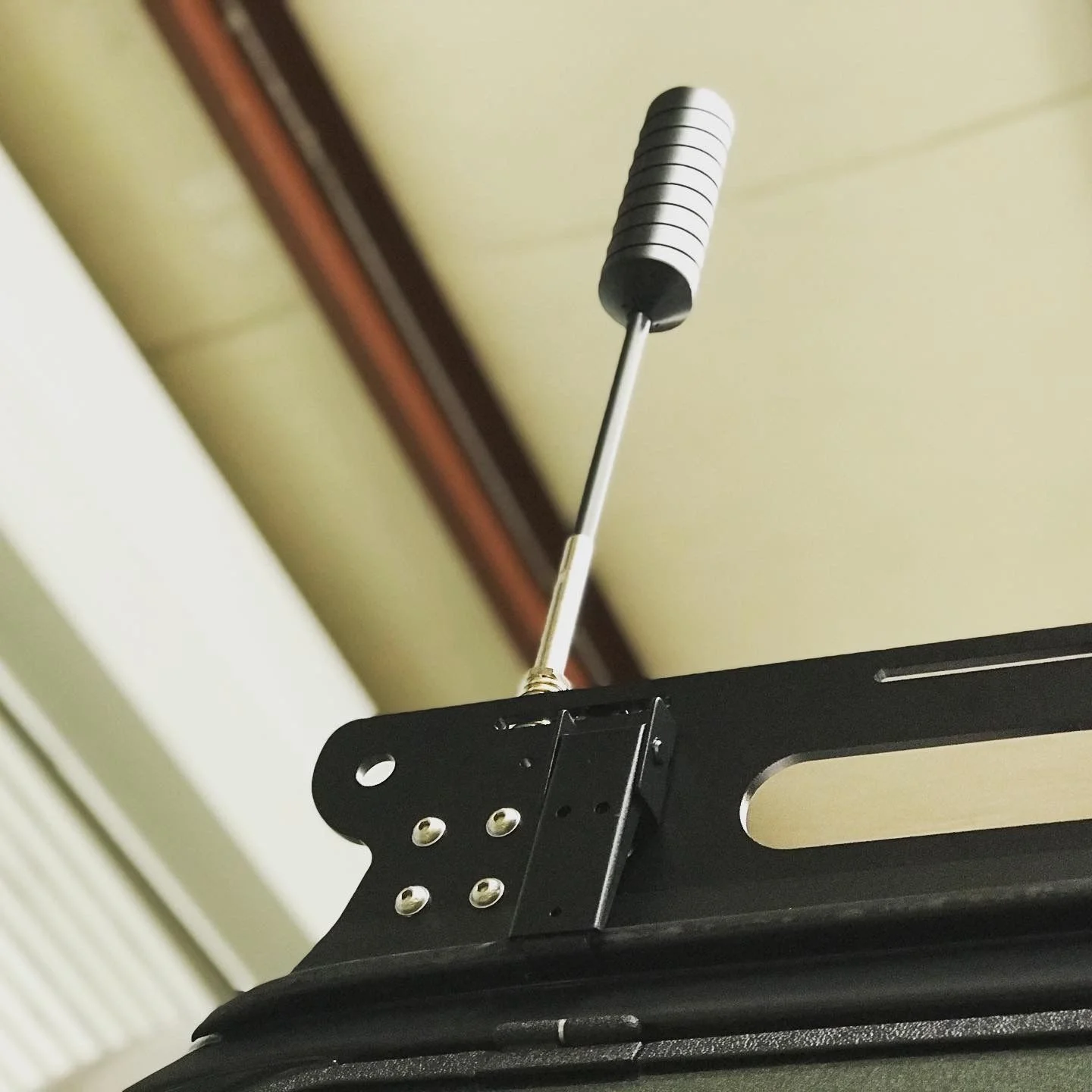

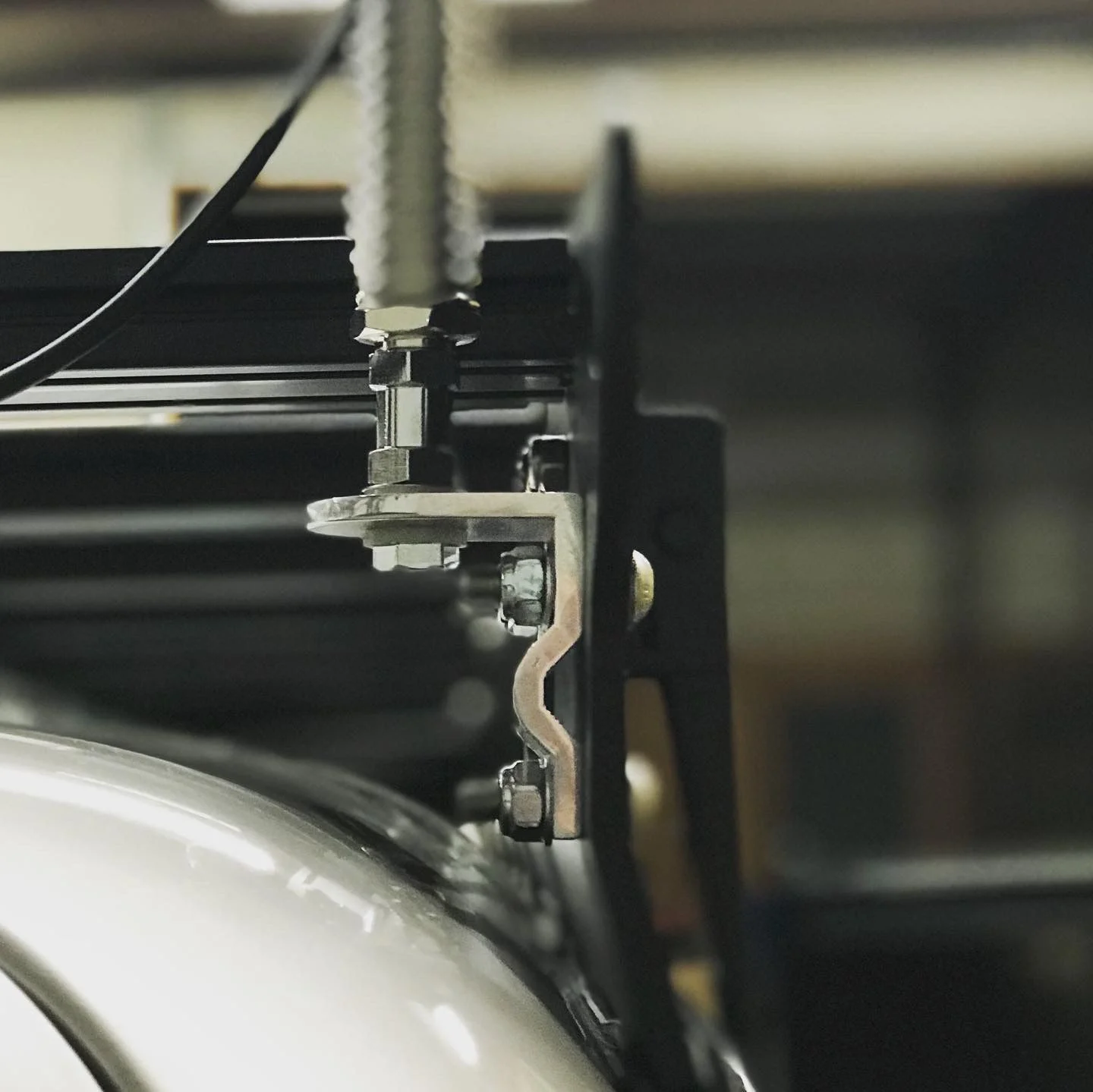

Had a request from a customer to do an install for the WeBoost cell phone booster system. Since I’d never installed one before I figured I’d make the mistakes on my turbo truck first before I screw it up on a customer’s. Glad the turbo was the test mule. Spent way too much time trying to figure out a very clean install. Mounting it in the QPM was the best route.
The inboard antennae was routed to the front of the drawers and the outboard one was mounted to the back of the roof rack.
Special thanks to Dave Schenker and Delta Vehicle Systems for getting three systems out to me so quickly.
Only two things I’d recommend:
1) drilling more mounting holes for the plastic bracket is probably a better idea. I added four more.
2) don’t close the door/hood/hatch on the antenna cable before it’s properly routed 😞

View attachment 2420025View attachment 2420026View attachment 2420027View attachment 2420028View attachment 2420029
Since you mentioned the routing of the cable, how did you route this one?
