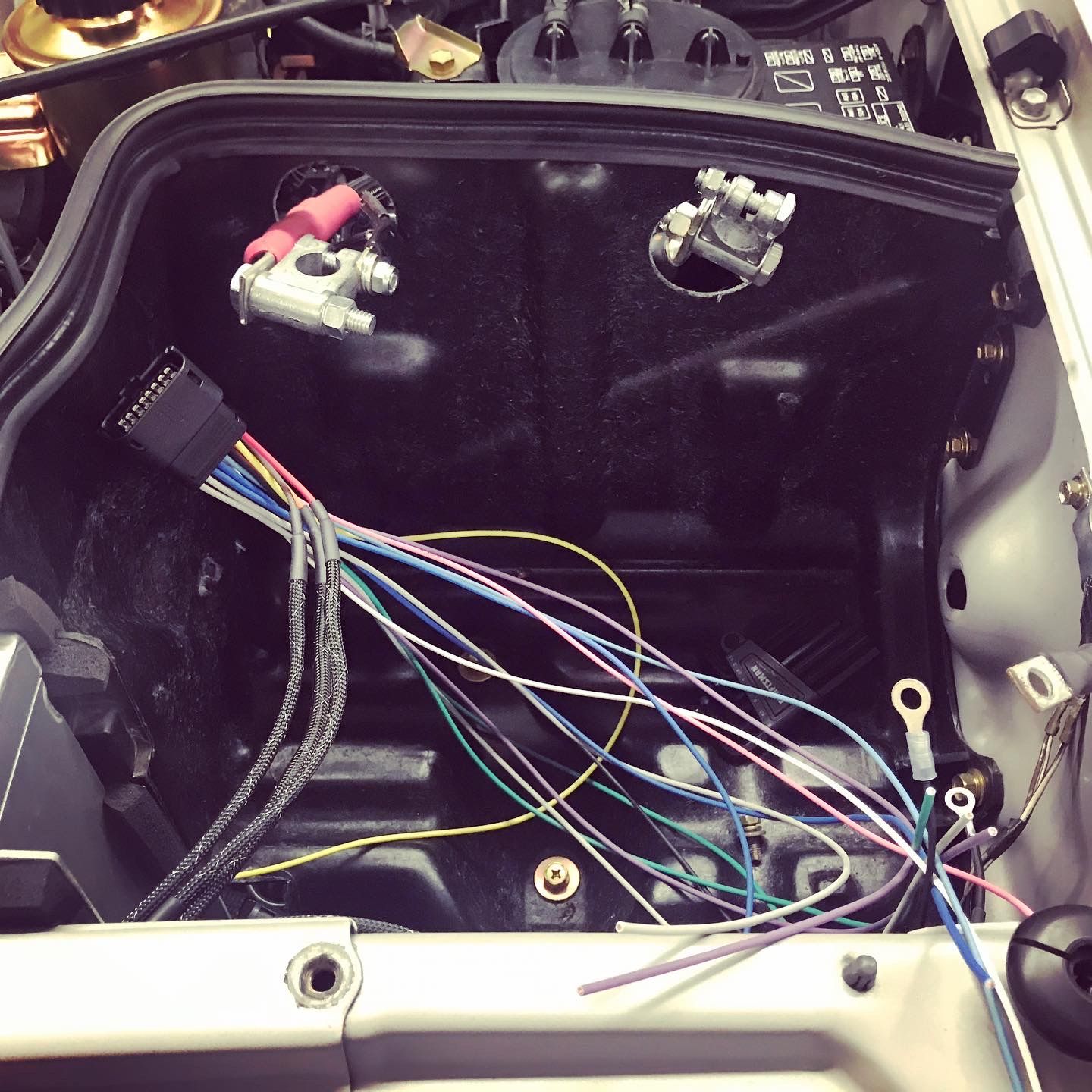

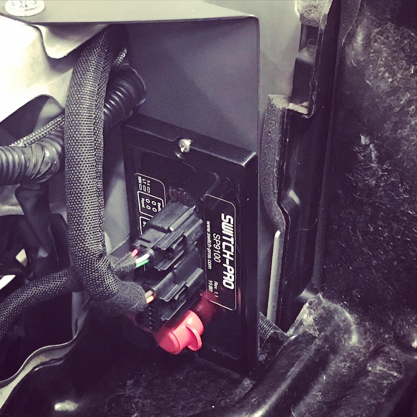

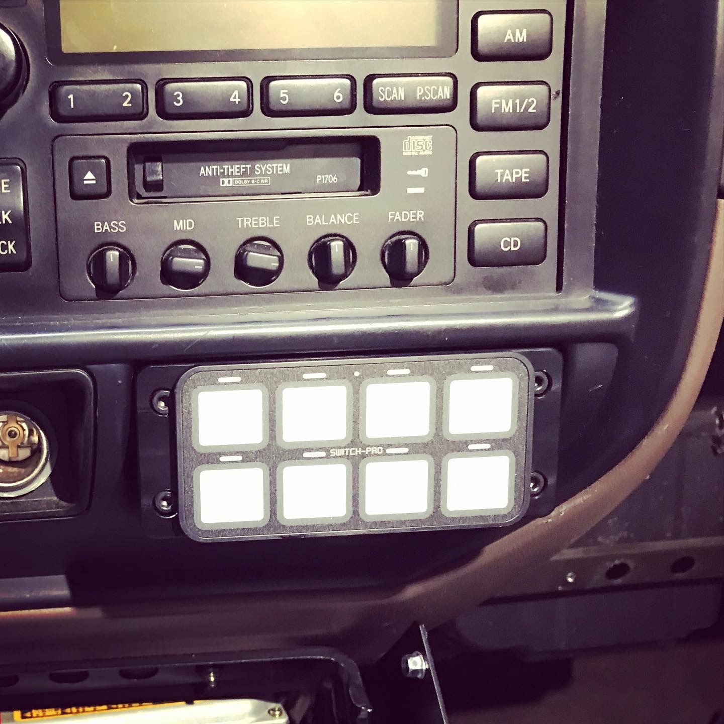

Long before @deltavehiclesystems did their firewall mounted #SwitchPros bracket (solid design btw), the intention on the turbo truck was to design a simple bracket that actually sits in front of the battery but out of the way. Mission accomplished. There is a hole on the headlight bucket that gets a rivnut then the mount has two mounting points. The SwitchPros brain sits upright, out of the engine bay heat, close to the battery and in an area to get air for cooling. I’ll be going into production on these shortly. It’s no frills. Just a mount.
For those with dual batteries, a mirrored version may also be nice. I am thinking it could be used for mounting fuse holders, relays etc...

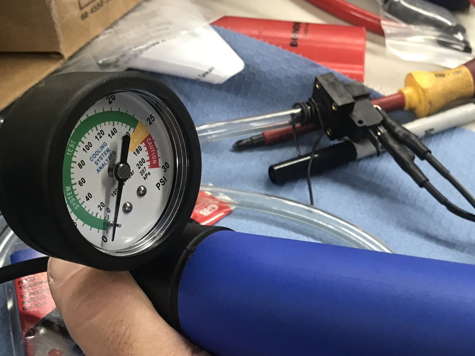

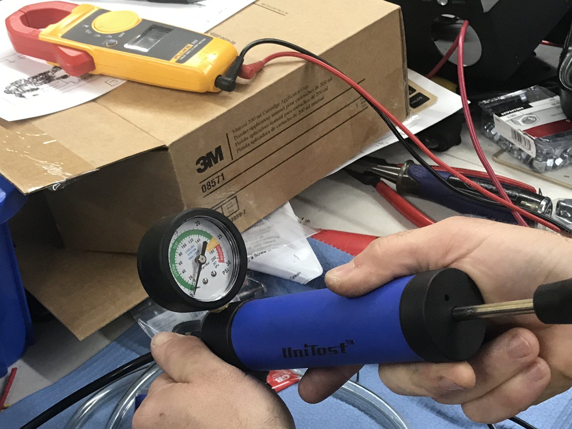

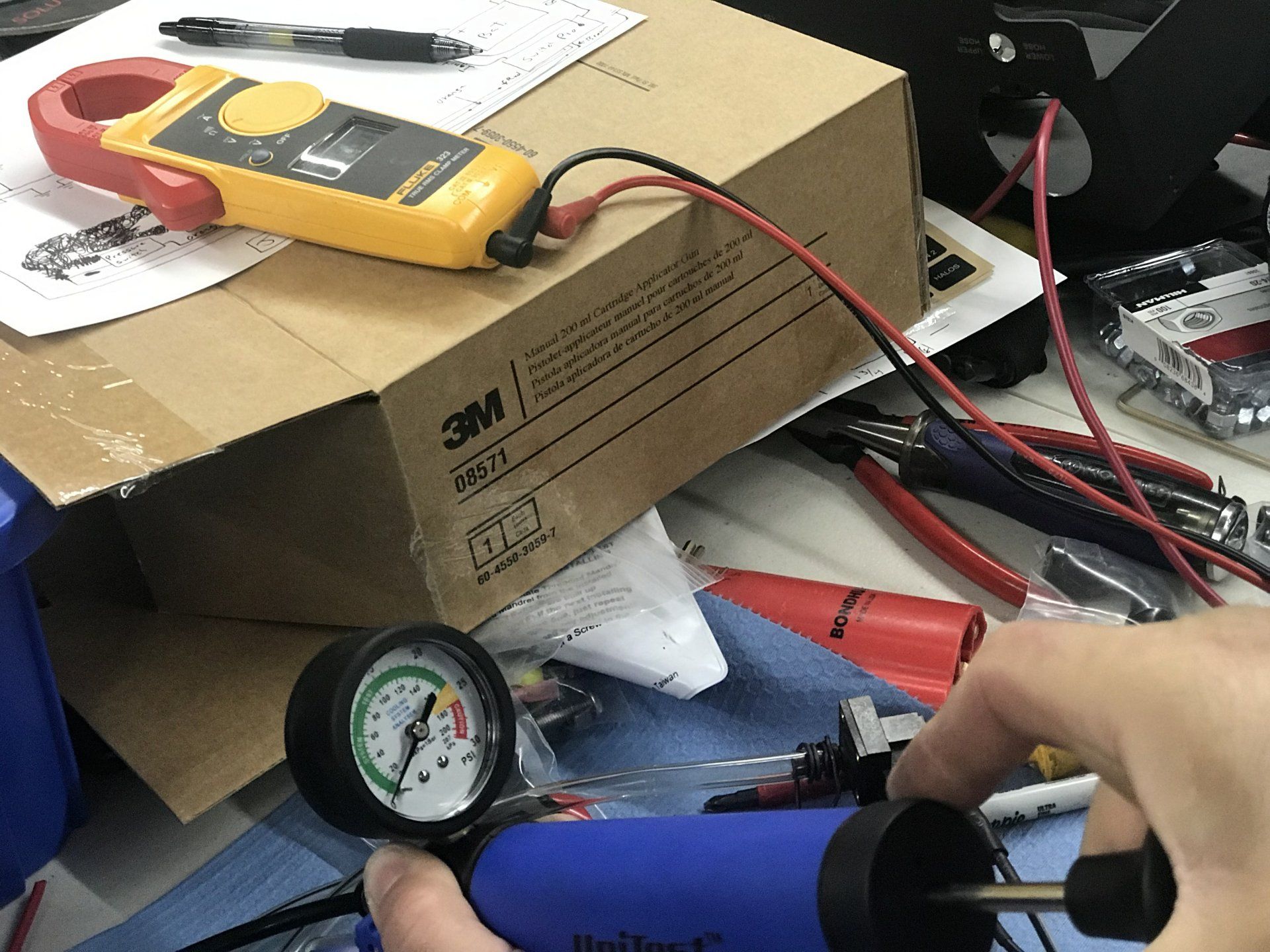

Spent some time playing with the methanol injection. There a few ways to activate, such as MAF signal to controller, but for a kit I prefer simpler. It can be upgraded at another time. The boost switch is adjustable and needs to be fine tuned to where it needs to switch. Went with 2psi and all kits will be pre-set before they ship out.

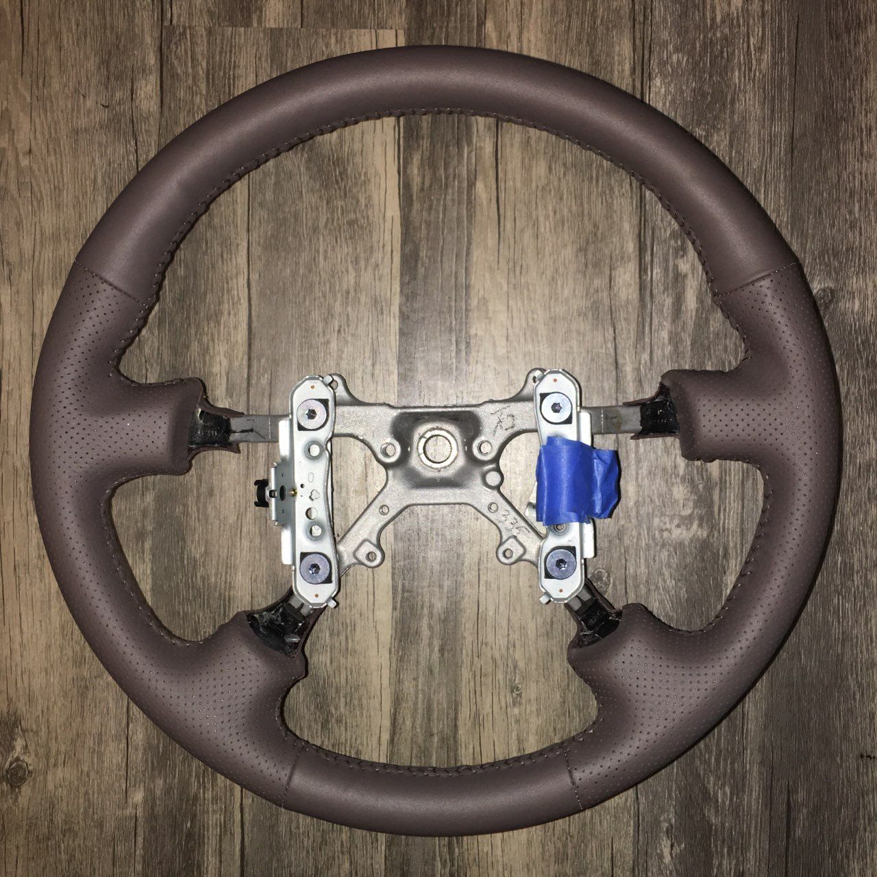

The Turbo Test Mule no.3 and a customer’s 80 both needed new steering wheels redone. Went with #CraftCustoms out of Rockwall, TX. On both I decided to borrow from the 100series Land Cruiser steering wheel leather design by adding in the perforated leather in the center and also added the thumb bumps at 10 and 2. Looking forward to installing and feeling them in the truck 🤩
