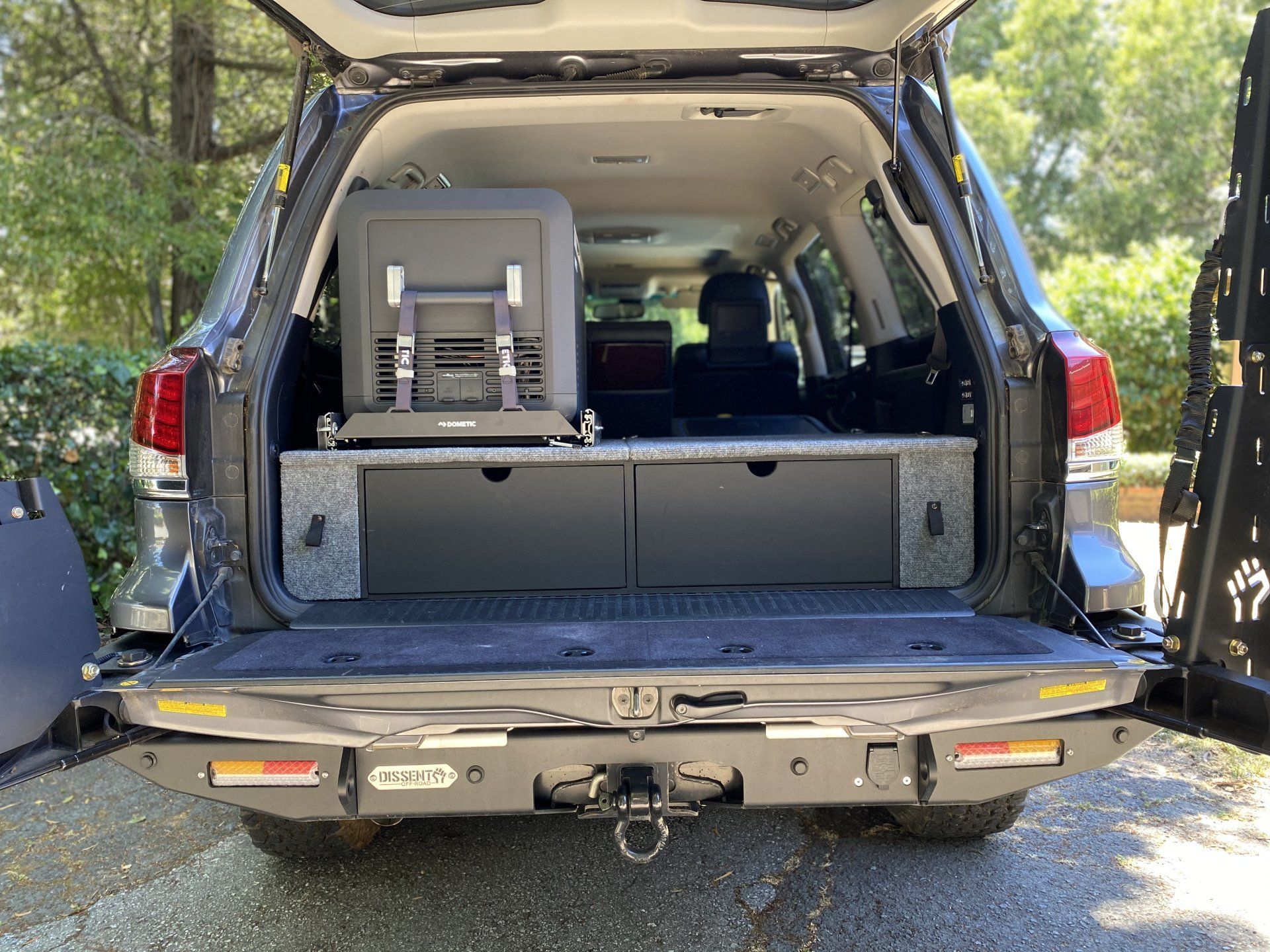

I have this setup in the back. I think the PO had a fridge there on the right side because there seem to be some mounting screws. I decided to buy a fridge and looking for recommendations what size, fridge and setup works the best for a family of 4 in remote wilderness.
Ive never owned or seen one and ARB has several to choose from. I think I need/want this one if its the best fit. And can get good recommendation from someone familiar here who knows. They have a plastic cheaper blue one and a more expensive aluminum one but this is the one I’m looking at.
ARB Zero Fridge Freezer Dual Zone 73QT | Best Prices & Reviews at Morris 4x4
Do I need an extra slider? My drawers already slide. I dont know how heavy these can be. Or just a strap mount kit. I have many usb 12v and a 110 power in the back. They have the insulator bags too. Are they worth it?

I have a Dometic CFX35 and it's more than enough for 2 for a week. I don't think a 35L cooler would be enough for a family of 4 for that long. In a remote wilderness setting, you'll need solar power and extra batteries to run it. Mine will run for 4 days off a 100Ah deep cycle lead-acid battery in 70F ambient daytime and 50F ambient nighttime temps. I have the extra insulating cover for it and keep in the shade, not in the truck when camping. I strap it down when underway and wish I had a slide. Be sure to look at the Dometic offerings. They are ramping up their overlanding type of equipment.

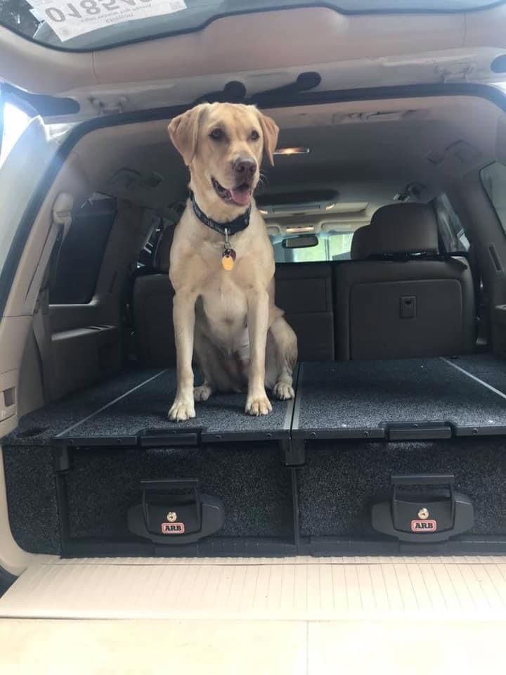

Nice pup, by the way. Looks like he's the boss.

I my drawer tops slide but I dont know if it will hold the weight Extended out. I’m not sure if we need freezer or how much space needed. They have a 10% off sale too Till tomorrow lol.

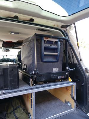

Thing to check also is there enough room to open and close it while driving; or if you even want to do this?. Sometime on a long drive I'll turn it around so the person in the back seat has access to it.

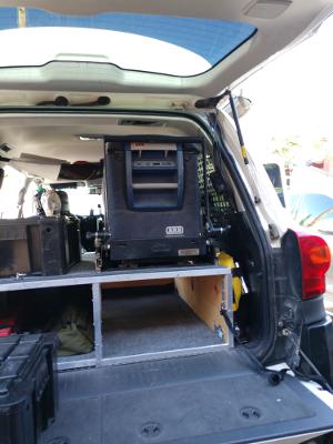

The arb 37 will do for about 3 days, and the 63+ will do 5 days + rotating drinks in. The dual is best as you can keep stuff frozen. The sliders pull out with any of these on them.

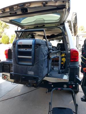

Last tip I have is they have a extendable power cord on amazon I repurposed so that the power line extends and retracts when you slide the fridge in and out.

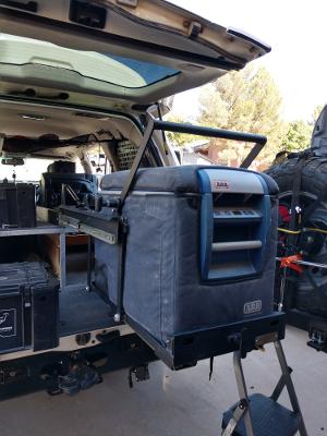

FYI those arb drawer slides will easily hold the full fridge.

We are a family of four and use the ARB 37qt, which is sufficient for a week of vac-sealed meat/entrees and fruits/veggies/cheese. Our water/drinks are stored outside the fridge. If i need a cold beer i steal from a buddy who seems to always have on hand :). Would like a slide but it hasnt been a requirement so far. I WOULD like to see any DIY methods of a transit/insulation bag though! @grinchy .
This size fridge also allows quite a bit of storage space to the side closest to the window and behind. I have the KISS drawers without the wings installed and fit a pett toilet, ground tent and couple sleeping bags there. Doing this usually allows the pup enough space to travel comfortably, although he tends to hop to the 2nd row occasionally as well. -Matt
