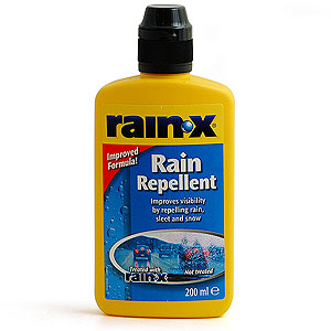

Until you get it figured out, apply some Rain-X to the windshield. You won't even need wipers then. Seriously. Stuff is amazing.
Thanks, I may have to use this while I track down the problem. Does it really work, have you used it before?
Yes. Apply after thoroughly cleaning the windshield sparkly clean.
You can drive in the rain without windshield wipers. Easy to see. Water drops roll off. I've done it lots of times. You need to reapply it every so often.
