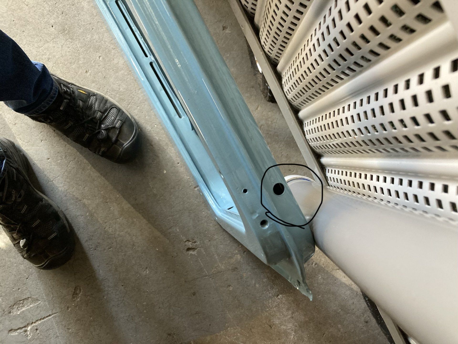

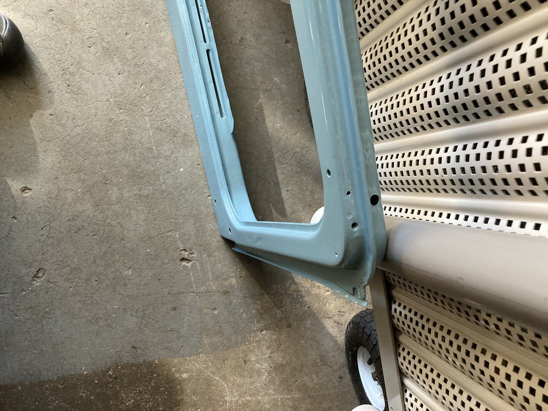

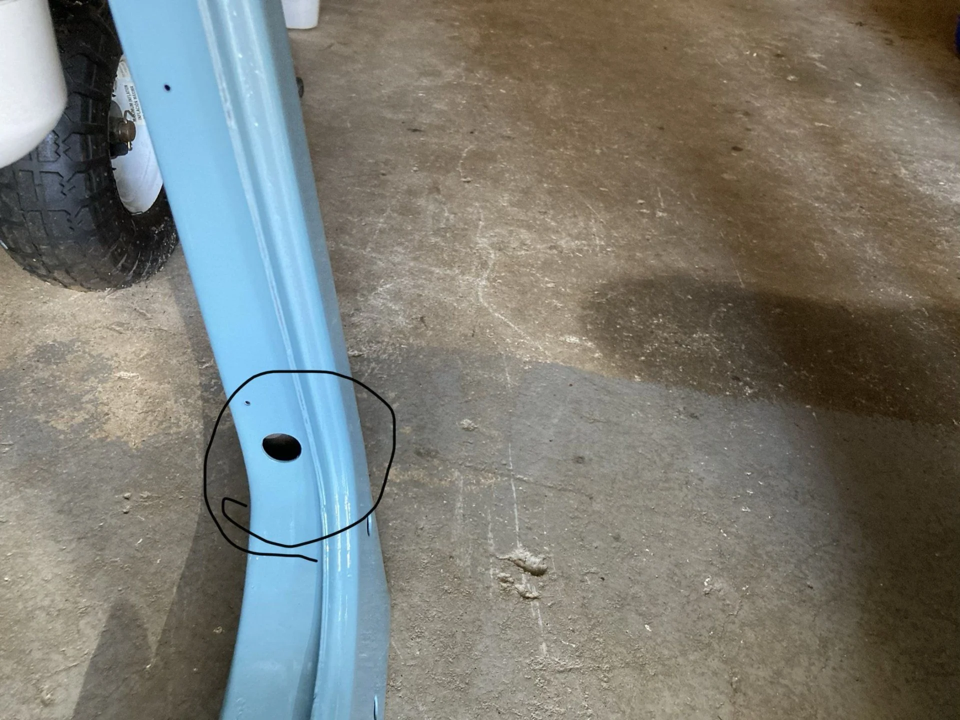

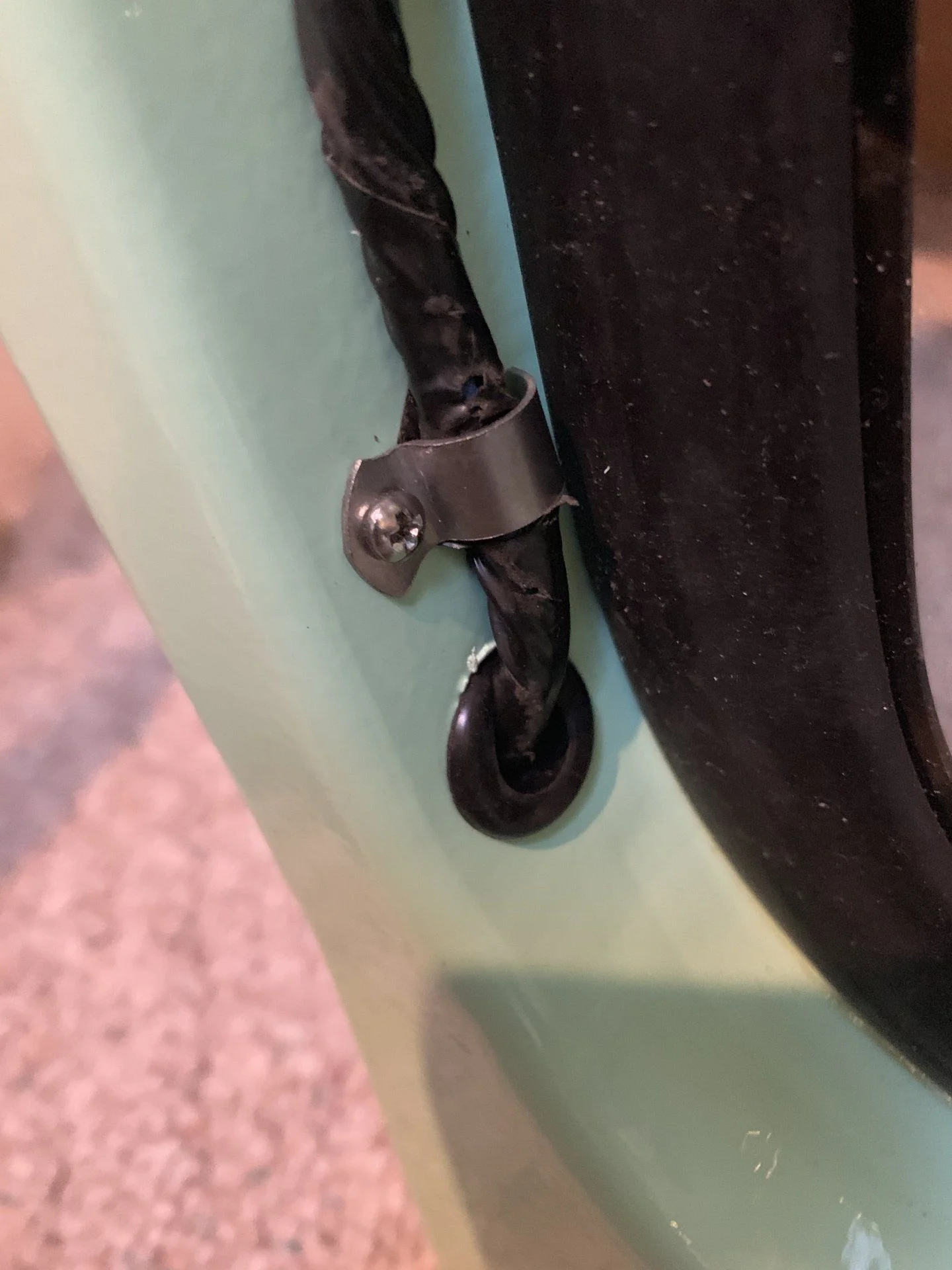

Looking for some grommets for my 1974 FJ40 windshield frame where the wiper motor wire comes through. There are two of one size on top of the windshield frame on the drivers side and the other size is on the enter side on the drivers side as well. If anyone has a part number or where I could get them would be great. Thanks

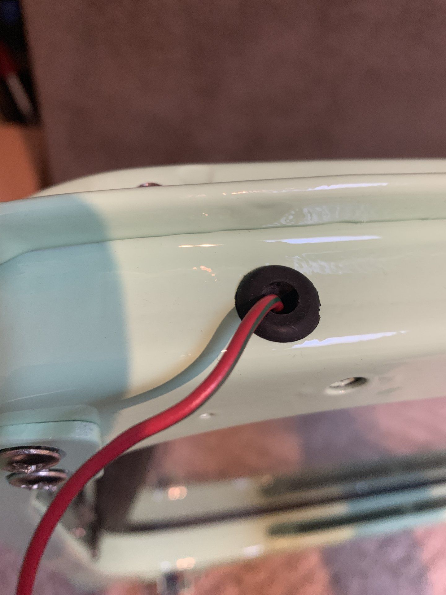

Alright, the two smaller ones at the top (for courtesy light wire I think) are 3/8” od with 3/16” id for 1/16” thickness.

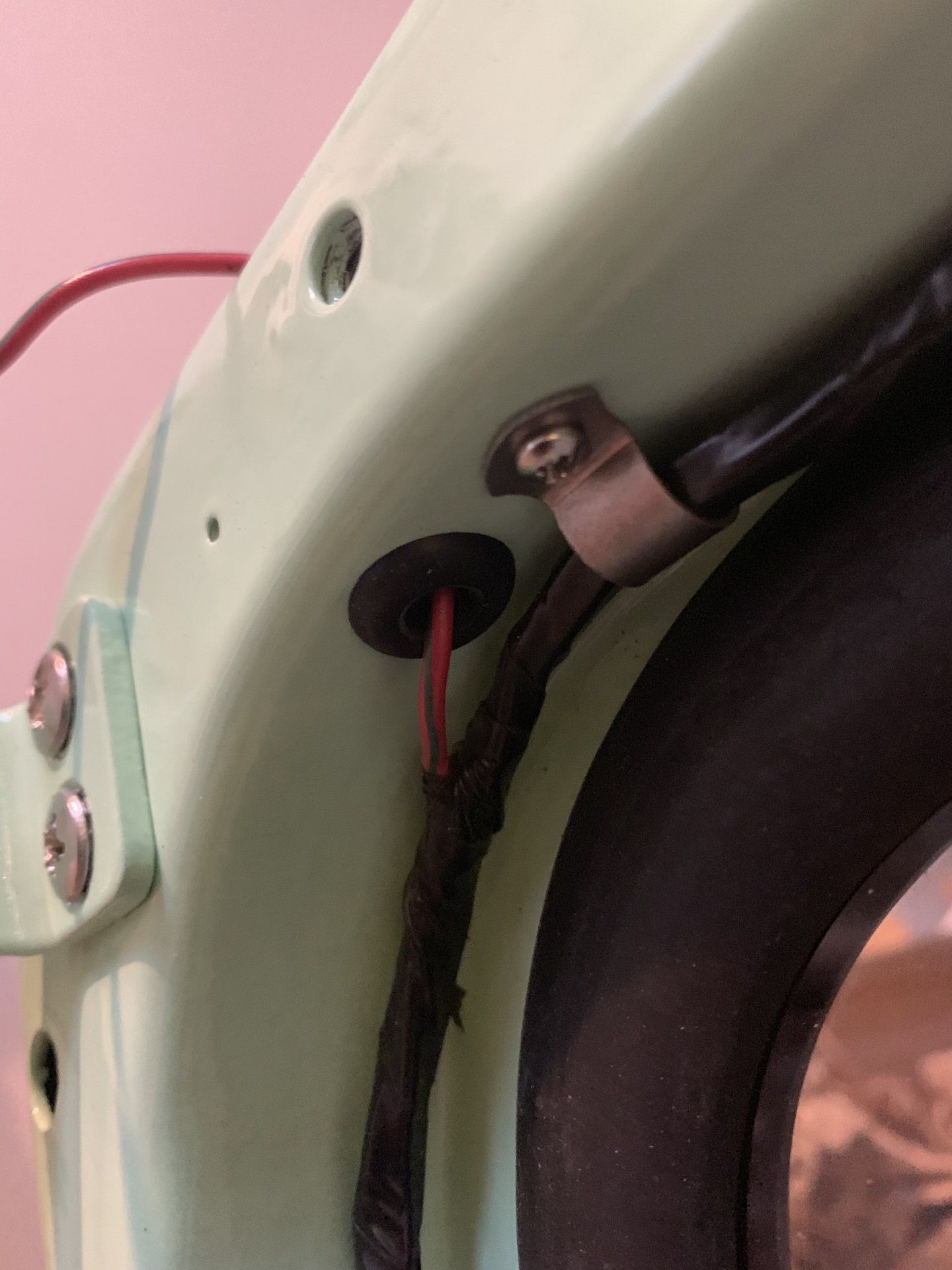

The bottom where all the harness wires come in is 1/2” od with 3/8” id for 1/16” thickness. I’d get one with a little larger od for this one; maybe 5/8”?
Bought the two smaller grommets from Toyota and the larger one from Grainger. I also cut a slit in the larger one to look like OEM. Thanks for the help everyone.
