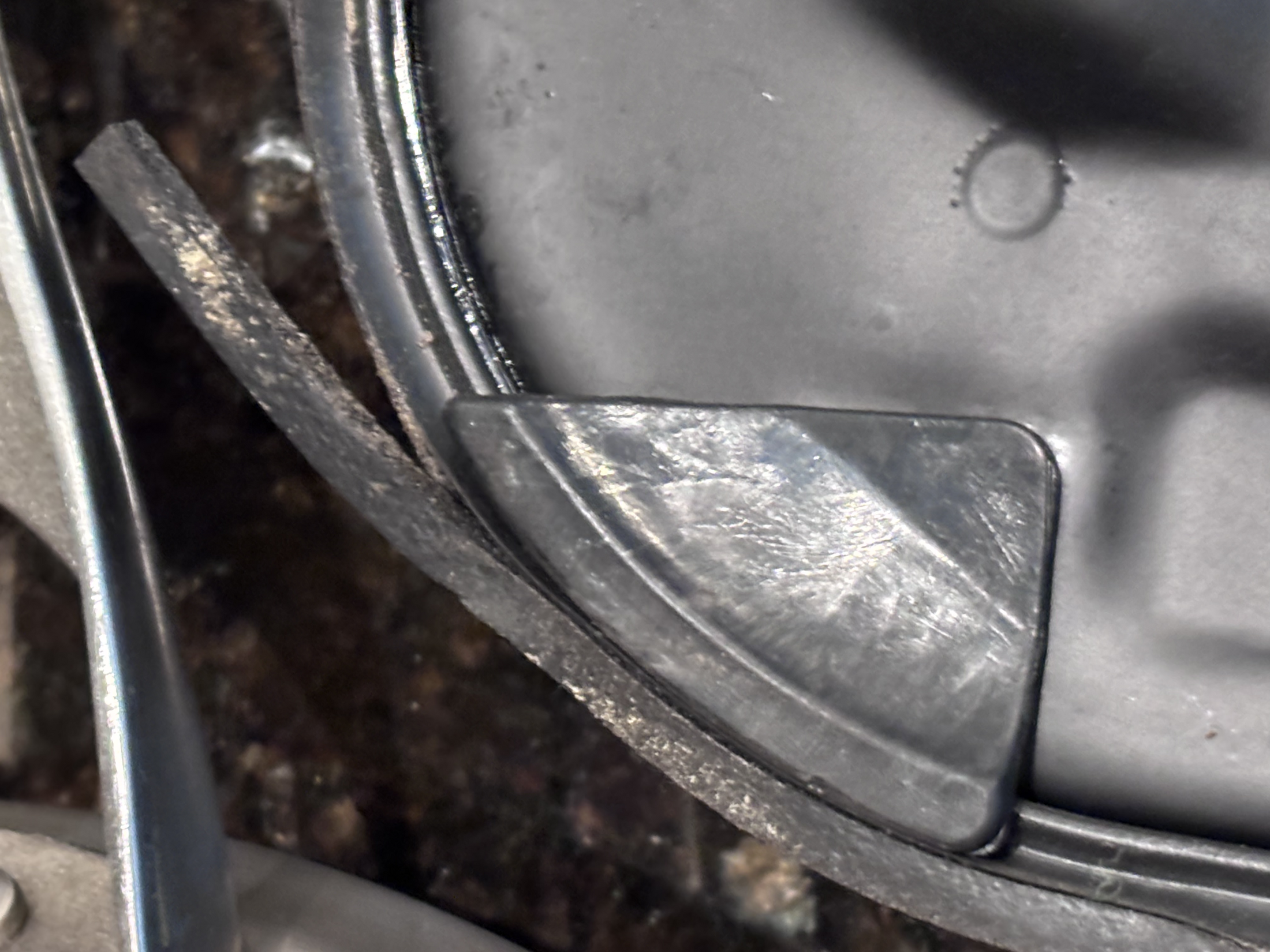

Okay, Sorry but I am starting with sunroof for no better reason than I have what I think I need. Trim came off without breaking fortunately. I am going with the @jonheld method of poultry twine instead of bike tube.
I assume the "gap" I am to fill is between the metal an the seal below. Also at one corner the rubber bit is starting to peel. Can I use something like crazy glue or E6000?
I am washing pretty gently with a shoe polishing brush an the water is coming out black!

I'll defer to others on "fixing" a sunroof; I've always replaced them. The 80 series sunroofs are NLA, but the 70 series sunroofs aren't, and they are the same (updated) sunroof.
I have two in stock awaiting installation.
You've accomplished far more difficult repairs on an 80 thus far. I'm pretty confident you can handle this.

Ok, sunroof is back in. The edge cleaned up nicely and the fit seems pretty snug. The drains are clear and the little cable covers seem flat and set to divert water into the pan.

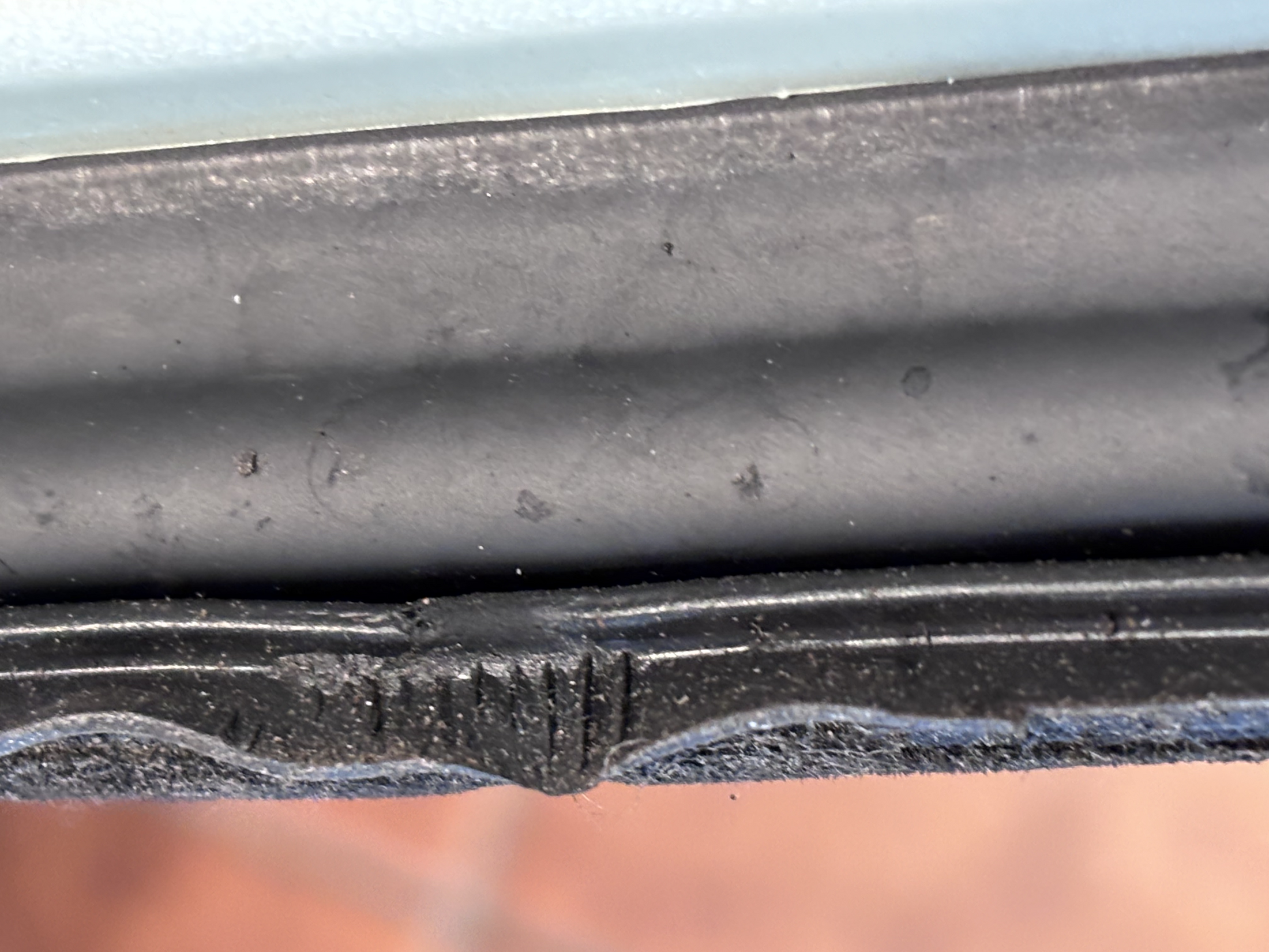

As to the windshield, there is zero sealant on the window or body side of the molding. I guess these leaves open the possibility that there is sealant on the body lip. I am going to order sealant and a new gasket. I will be a tad annoyed if we find no sealant at all.

Ok, Tuesday a riding buddy will help with the windshield at his shop. But, my sunroof bonus is that the string in the sunroof seal appears to have cured a wind noise that I was worried would drive me bonkers over 1,700 miles to Denver. I had been chasing sources in the door to no avail.
Windshield is in, I was asked not to take photos inside the shop (?). That said, I see why with the correct tools an unsealed windshield is easy to manipulate. We used Betaseal418 plus a primer and left it inside for the night. Cost all of $100 plus pizza for all.

I'm just repeating what others have said, but t be completely clear, it's not just using an OEM gasket or the spec-ed adhesive. Those are important. Most important of all is following the specified steps in the FSM. Exactly.
I used to work as a step-and-fetch-it guy in a heavy duty fleet garage. This included dealing with our glass vendor, who were cooperative because big trucks are a lot like Land Cruisers, a little quirky. They subsequently did 2 windshields for me per FSM and not a lick of a issue.
Glass installers seem to be the worst when it comes to listening to the car owner.
I’ve had the run around with them as well. The part to me that is the hardest is telling them to glue the gasket to the windshield and then glue the gasket to the body. One of those steps in my opinion doesn’t seem like it’s a normal thing and they push back. Which then causes a leak.
