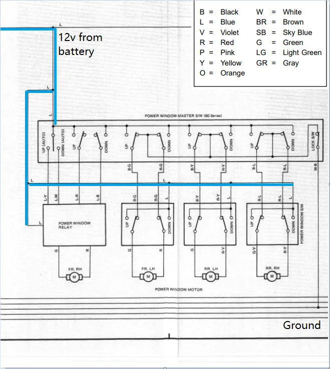

Here you go:
According to this diagram the blue wire provides fused power to the main switch in the drivers door and to each individual switch. Looks like there is only one common ground through the "Lock switch" on the drivers master window switch. I'm assuming if the lock switch is flipped then it looks like none of the windows will work.
* By this diagram it looks like the motors are not powered through a relay but could be wrong.
* In the MASTER SWITCH resting state all the contacts are in the ground position.
* The other door switches when not activated connect back to the master switch.
* When you rock a switch forward or backwards you provide power to one side of the motor or the other depending on UP or Down.
* The master switch gets a 12v source and each door switch gets its own 12v power supply however all of the switches ground through the master switch.
So by this diagram....if you have no up motor at an individual door and you have swapped in a known good switch and you have confirmed the motor works in both directions....then I would:
Check to see if the master switch is switching ground properly for the UP position of the switch. If this is good then verify the wiring is good between the master and door switch.
