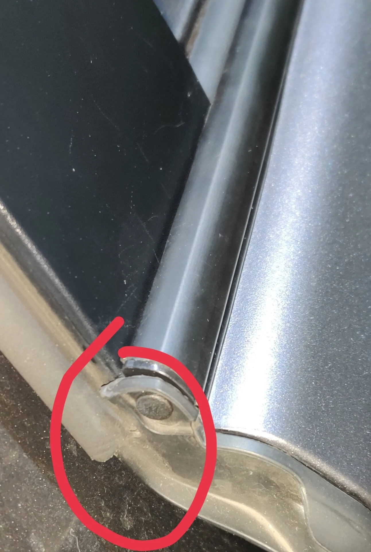

Just installed the driver's side rear door molding. Took a little more force than anticipated to remove the old molding and I bent it. Oh well.
Here is a picture of that rubber trim that cushions the driver's door. There is a tiny push clip that seats in the window molding to hold the rubber piece. I drilled a hole in the new window molding to hold the clip since the Prado pieces do not have the hole.

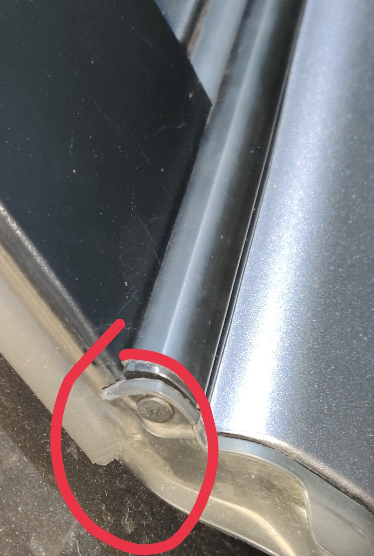

That’s what I remembered, I dropped that lil F’er and had a hell of a time finding it! The F line ones come pre-drilled. It makes a hell of a difference and much more durable than having them wrapped!!

The Prado ones fit great, just like the black line. No difference in fit, likely the same part number if you check. I just did a quick drill on the Prado ones since I guess they don't have that rubber door molding like the GX models.

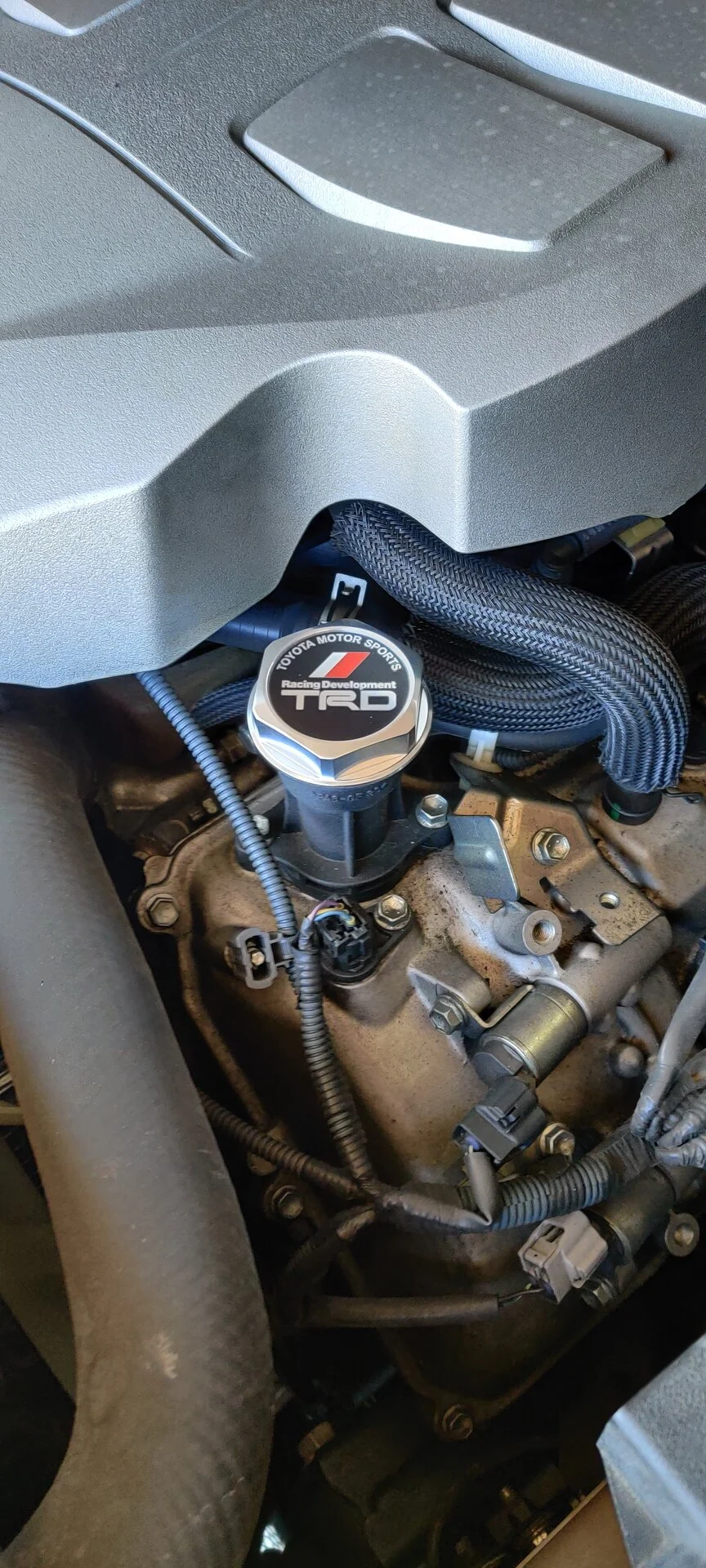

With the money you save you can get a sweet TRD billet oil cap.
