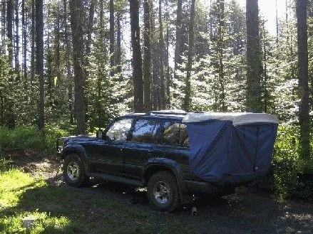

Josh, I wanted that at one time but like you said, they were out of business. I ended up buying the cheapy version and it works well for summer camping. You get an extra ~16" of floor length as opposed to having the tailgate closed. Fits better than it looks on this van as the van has no tailgate. Set-up and take-down time is fast.

since it's pictured on a minivan, how well does this one adapt to the 100? how do you like it? i still want to get a tent adaptation for our 100 and since this one's so cheap, why not?

This is Harridig's 80 but it fits about the same on a 100. The rear opens up as a screen door and also fully open. I like using it when sleeping by myself because I don't have to fully unload the inside compartment, I just need one side. If the wife comes along, I use the RTT.
