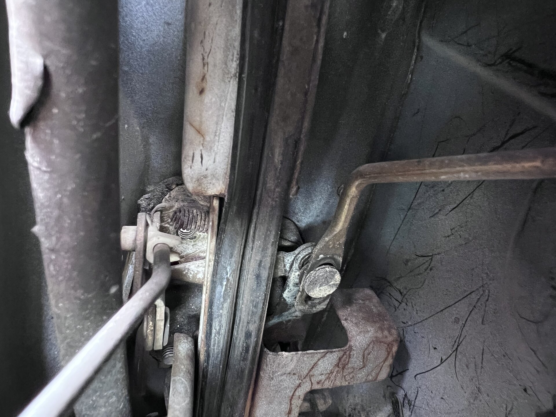

So I know this topic has been discussed at sorts of length.. but when u r looking can’t find.. and when u r not, then u find.. this is my case.
So, the window tracks have the upper section felt and then at the bottom it has sections, two to be exact.. well mine are falling off the tracks with every operation of the window.
- Is there a continuous run belt/felt that goes from one side to the other uninterrupted?
- where can I buy these lower sections and how do I get them to stay in place? Glue?
Here is a picture/ a horrible picture of what I’m talking about.
I used this thread and bought the felt that was recommended here and although I’ve only done the driver front, it stuck in the channel with no issue and stays there, like it was made for this. Also I just did it in one piece…
