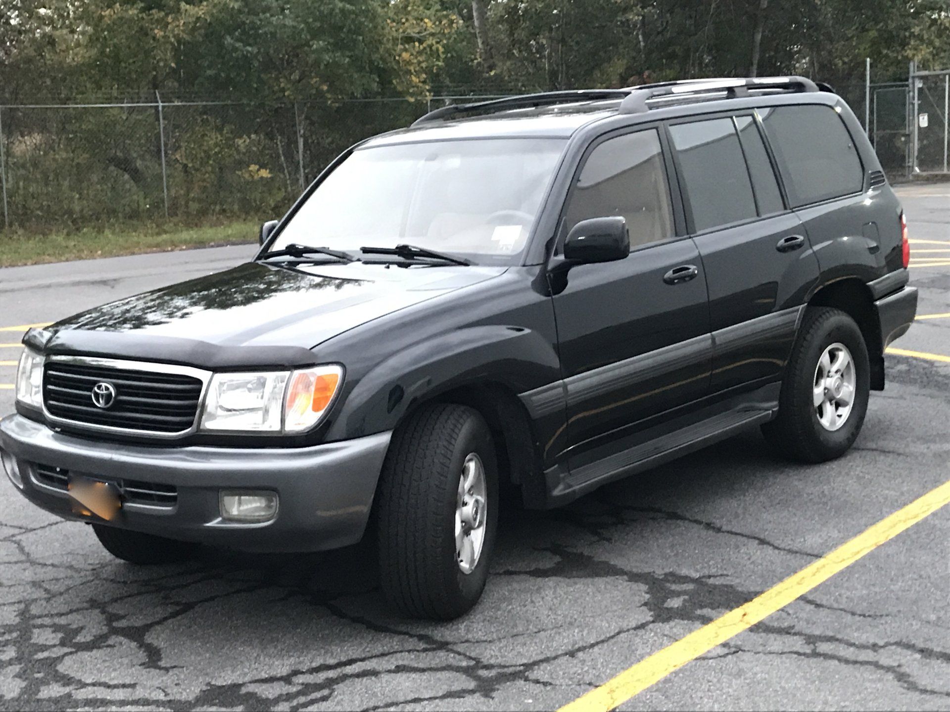

Haven't really taken a lot of pics yet. Bur here she is as I bought her off e-bay. Gotta dump the running boards as soon as the weather breaks.

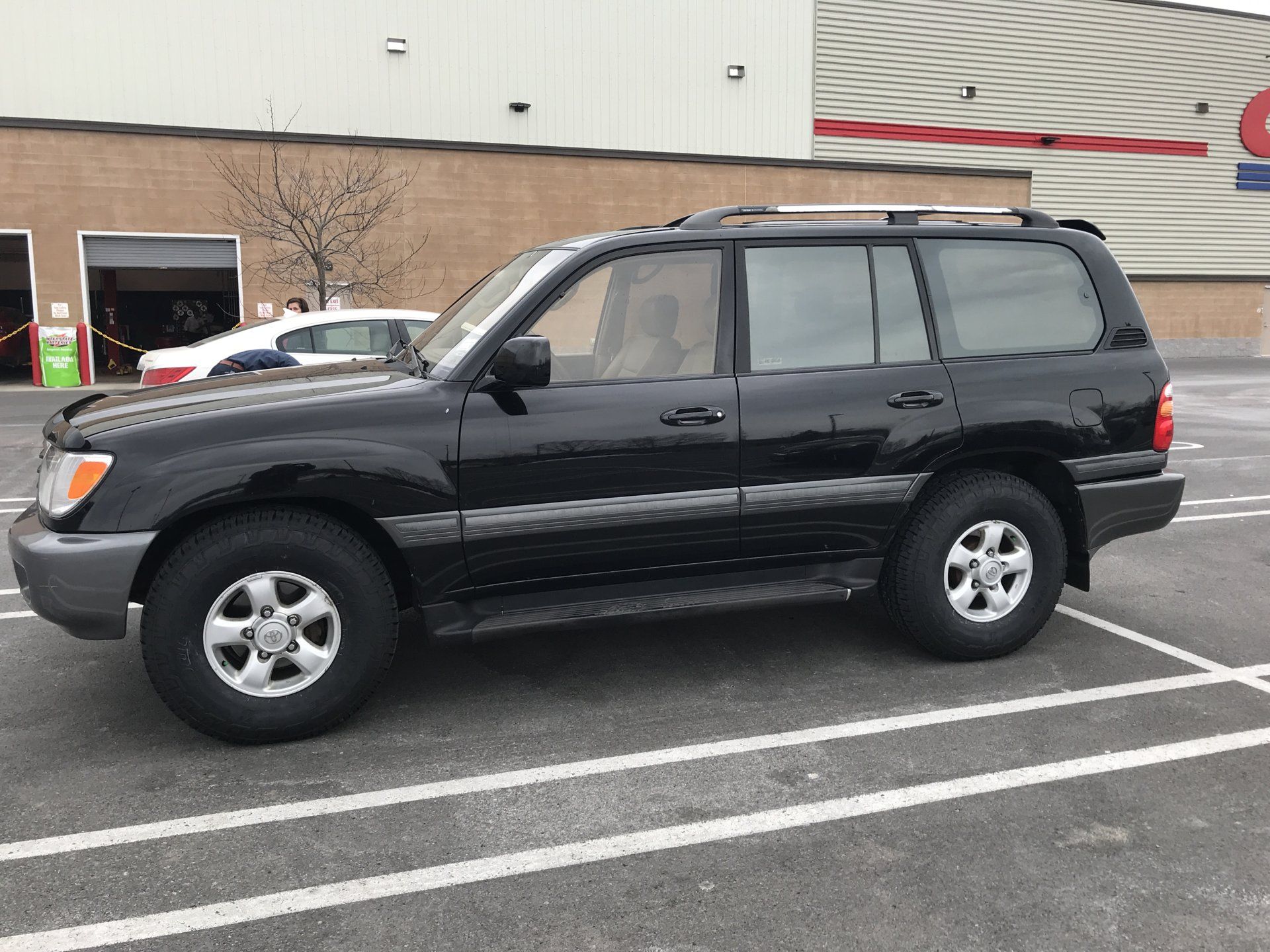

Here's one after install of new Bridgestone AT Revo-3 285/75/16, great tire so far course all the snow is gone.
