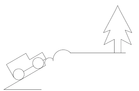

Twice now I have been in situations similar to the diagram below.
The first time I stacked rocks, ran the cable to a tree (over dirt and rock) then engaged the pto winch.
The rocks slipped out and the winch pin sheared off. That left me stuck in a sort of chute with boulders on each side.
The second time in a similar spot, I retreated.
What is the correct method for winching up and over like this?
Thanks.
It is true the Toyota shear pin is thin.
I drilled it out and put in a thicker one.
What I really want to know is there a trick or method of changing the angle the cable pulls at so the winch isn't trying to pull the truck into the rocks but rather up and over.

There is a "trick" that can come in handy if you want to lift the rig some as you pull it forward. But it calls for a bit of gear carried with you and preparedness. It is not something you will use often, but we have done it once or twice when going out to recover a rig.
Basically you need to have an "A frame" to set under the winch cable to raise the angle of the line/pull on the rig. There are a couple of different ways to rig it, and a myriad of ways to build the frame. Exactly what you can do with it also depends on if the stuck rig is winching itself or if it is being winched by a second rig.

The solution that I see is to use the spare wheel as lifting point .
Better to use a strop over the wheel so not to cut the tire . And place it rather near to the car / obstacle .
You will need to reposition the wheel as the car advances in the pull .

Depending on the distance to the tree or winch point you would use a long tow strap to get a snatch block at the vertical point and then winch up to the point you can get a straight winch to the tree

I think the root of your issue is that you have a PTO winch and can't drive and winch at the same time.
With an electric or hydraulic winch in the scenario you posited, even if the winch cable is pulling the front of the truck more down into the ground than up the hill, it's compressing the front suspension and pushing the front tires harder against the hill, increasing the frictional force (less true if mud is involved, but still).
If you are relying solely on the winch line to pull you up the hill, in this scenario it will put an enormous amount of force on the line and winch as you have experienced. The only way to get around that with the winch you have would be to change the angle of your line as Mark W suggested by using an a-frame structure or equivalent.
