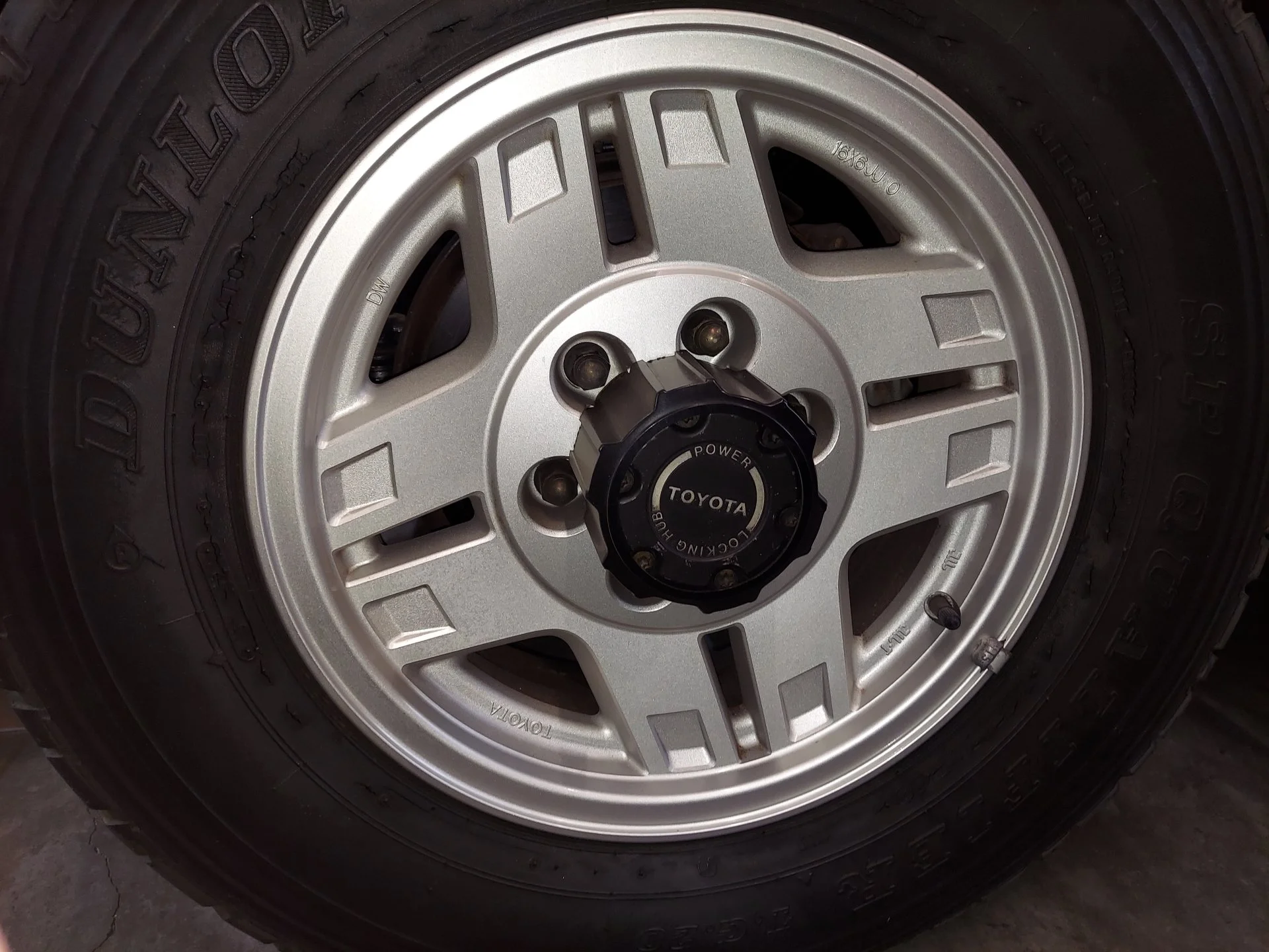

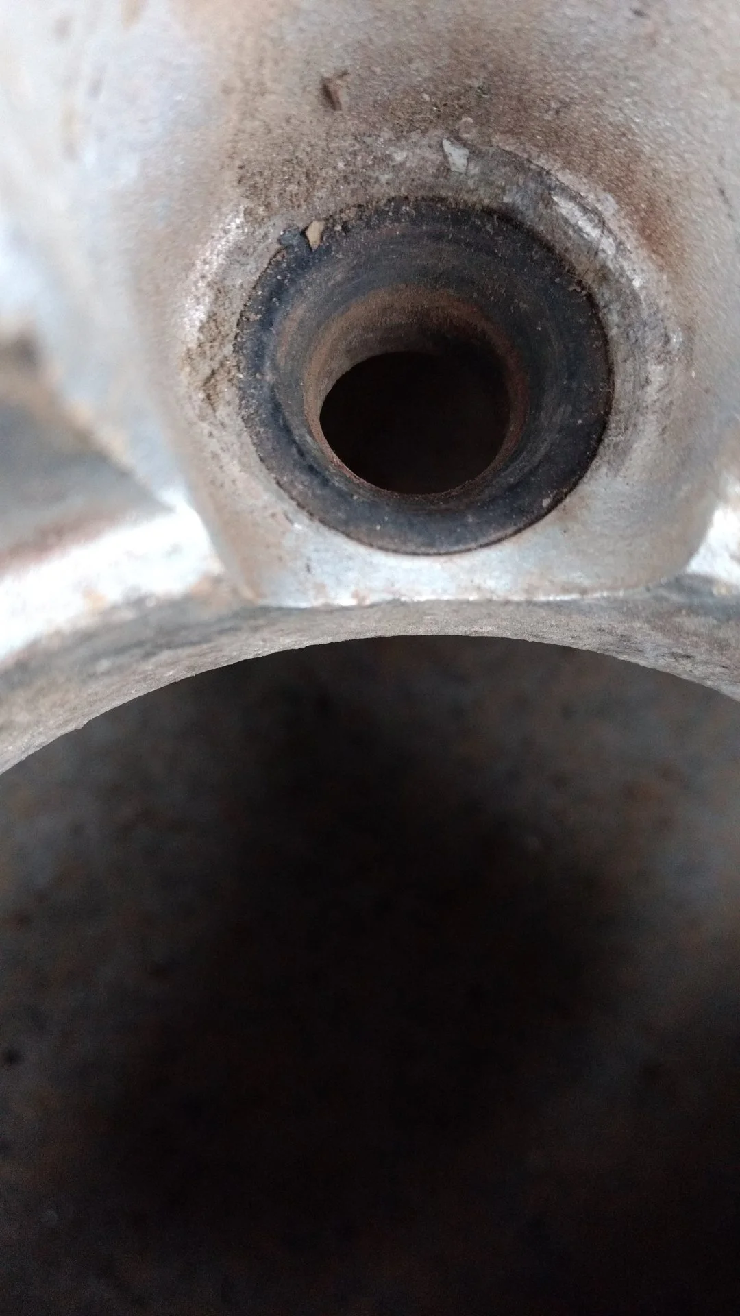

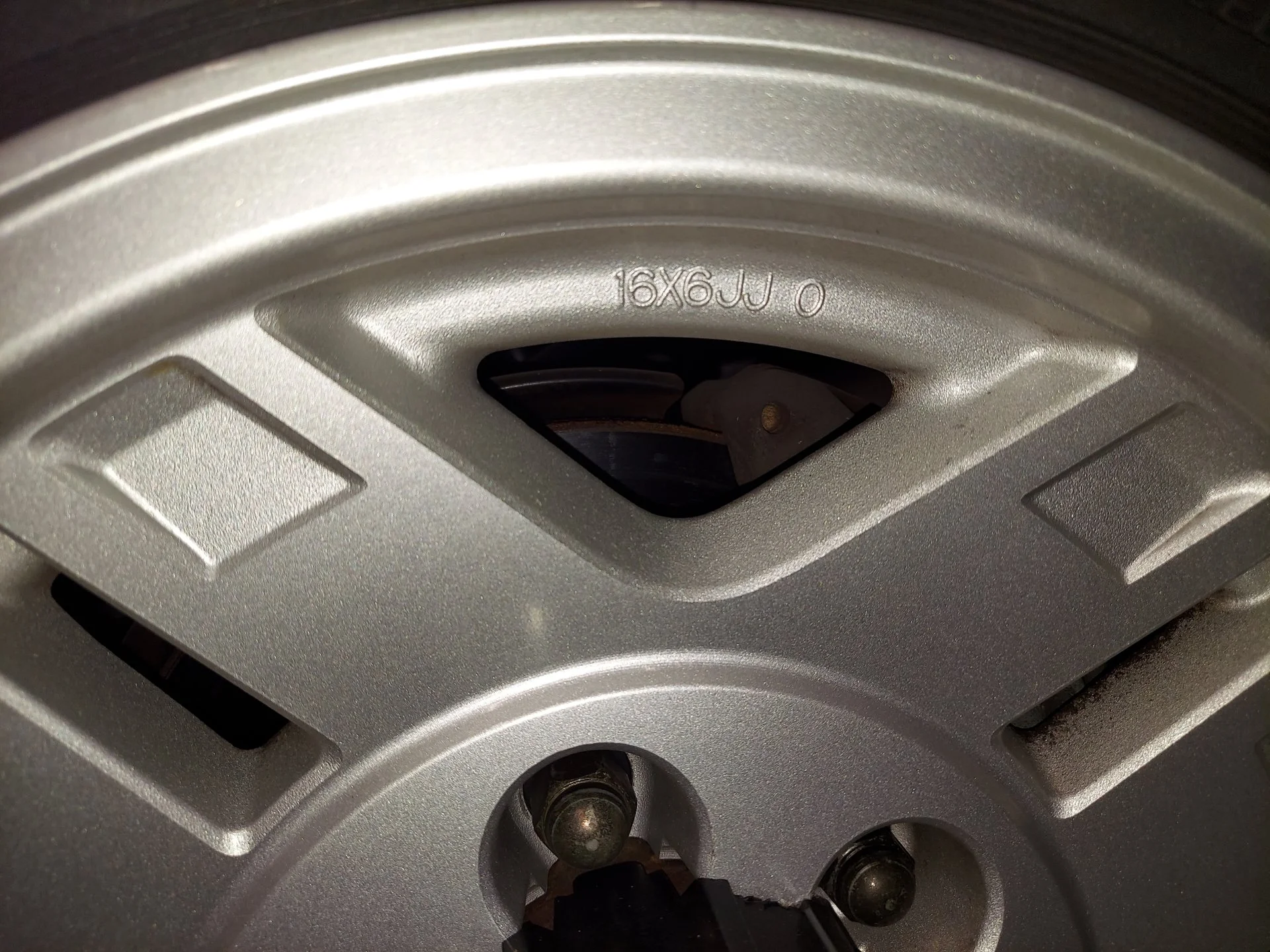

Here are a couple shots of the museum's LJ78. 16x6 with 0 offset equals 3.5 inches of backspace. Since this is a Land Cruiser wheel it does have the conical steel inserts that require acorn-style lug nuts.
Resurrecting this thread, those style wheels came off my JDM 1995 landcruiser prado kzj78. They are definitely acorn style lug nuts.

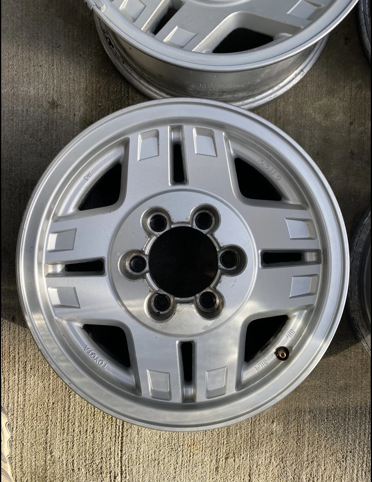

Are you sure those are 16"? As best as I can zoom in it looks like they say 15. I've also looked for 16's in that design and did not found any. Several different 15's, mostly varying by offset.
They are 16x6
I Also see 16x6. They are still way too ugly and way too narrow.
