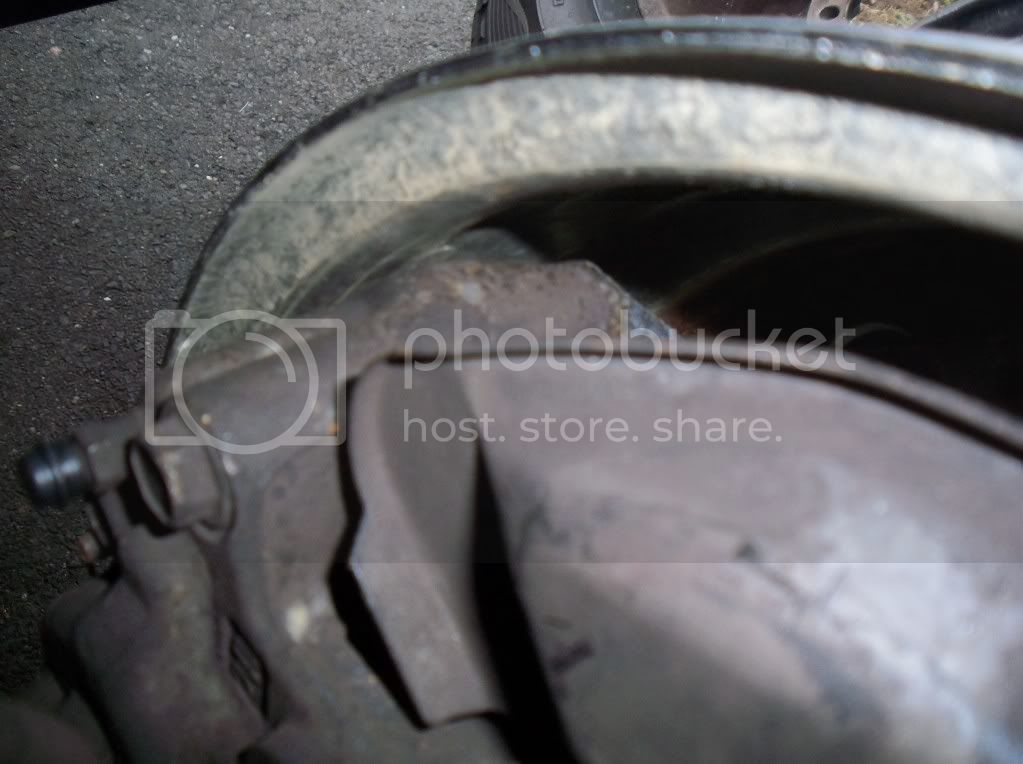

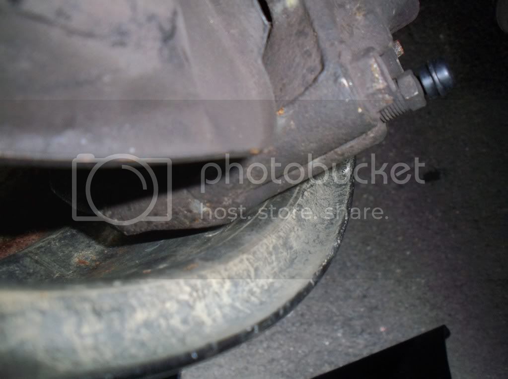

I had steel rim borrow to test fit, rim was 15 by 8, 3.75 back space, I take picture for front to what you guys think. It's not touching to inner rim but it's very close.
So I'm hoping rim with 2.5 back space clear from caliper better, at least 1.25 inch away so hope it will work.
