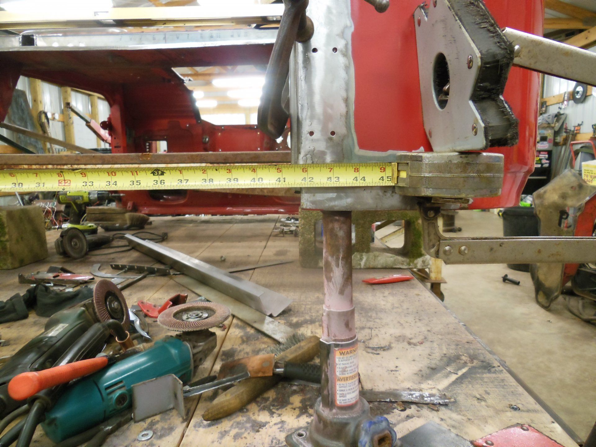

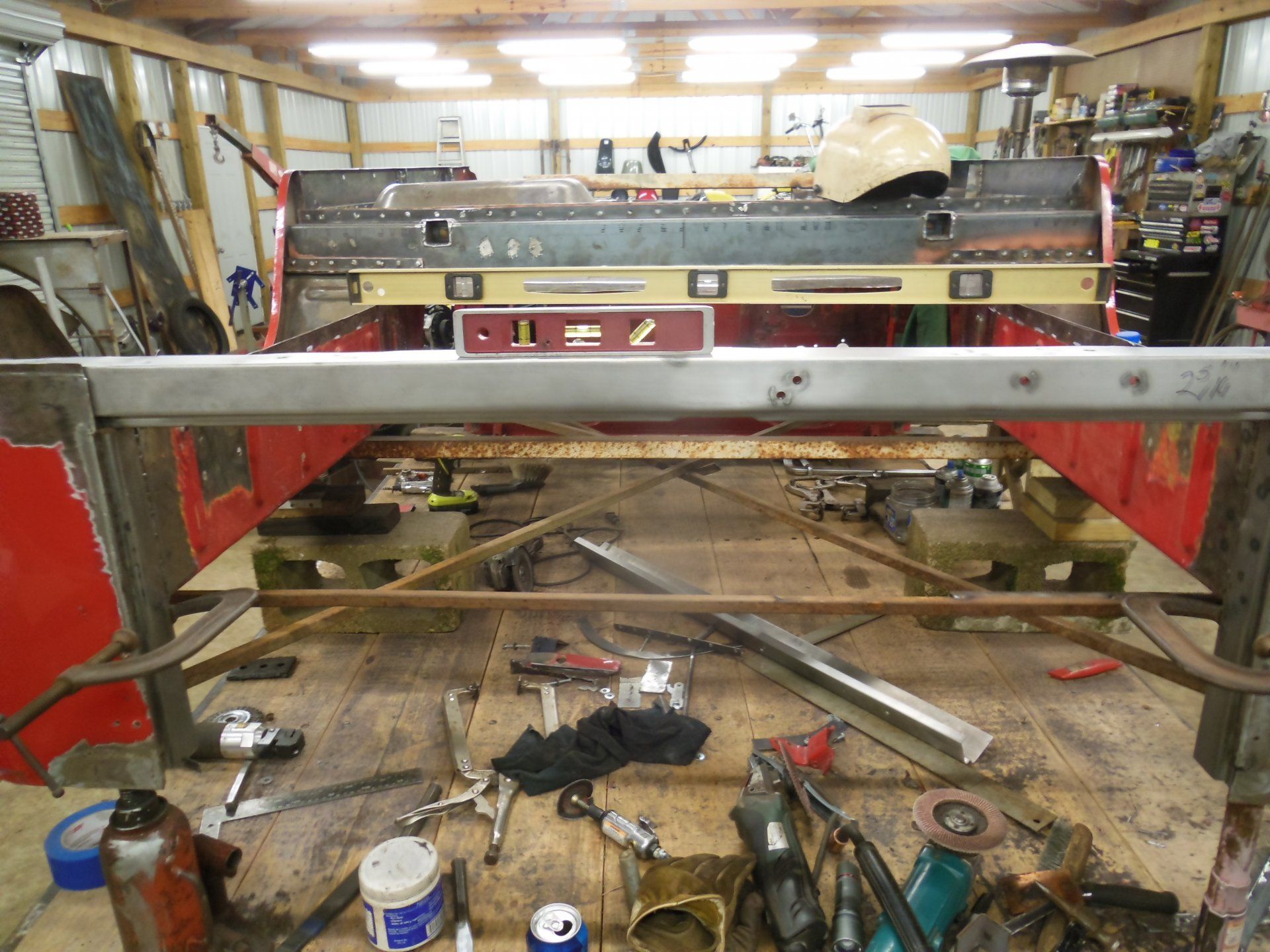

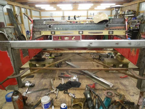

Width between corner channels 1975 40

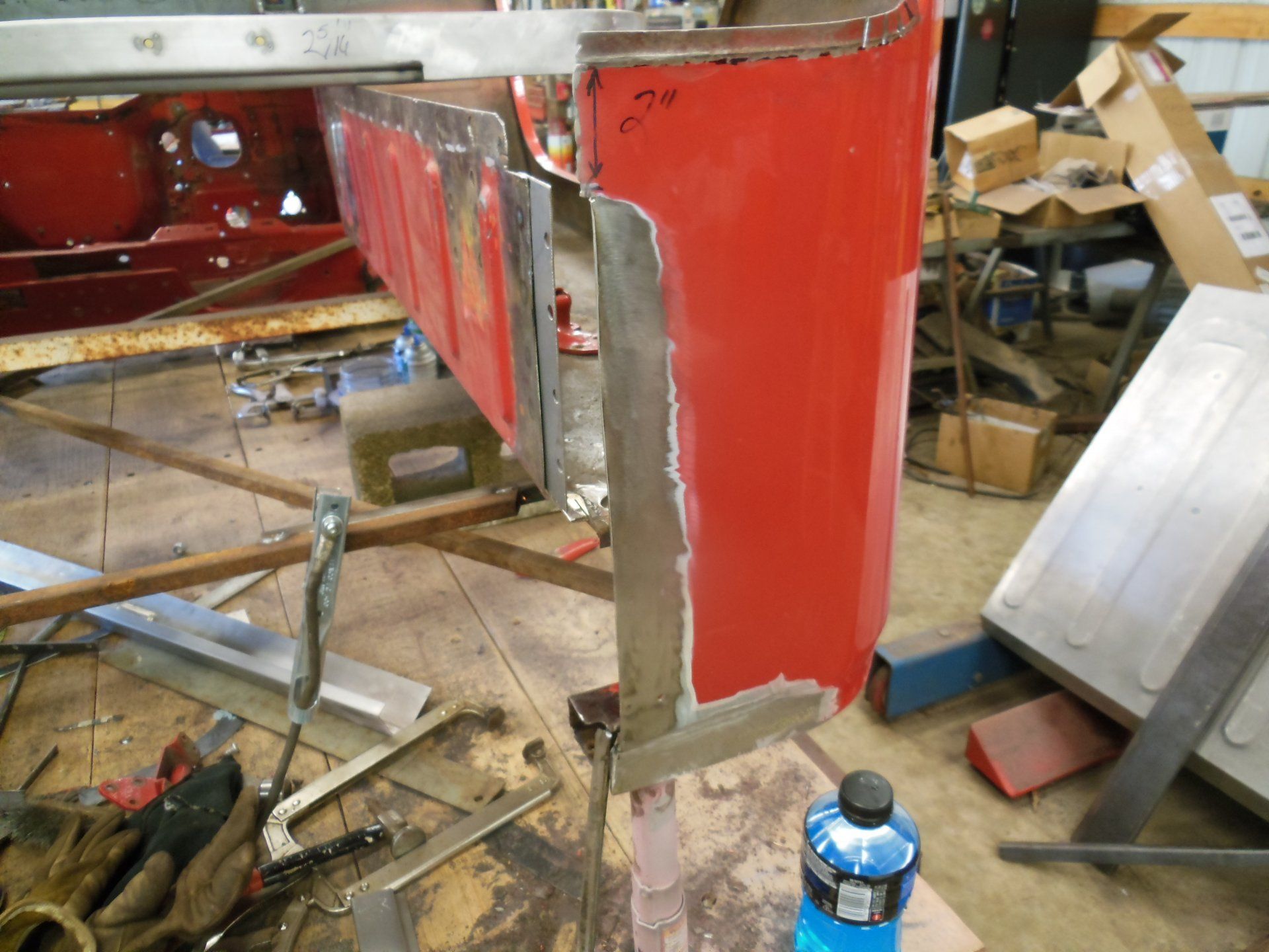

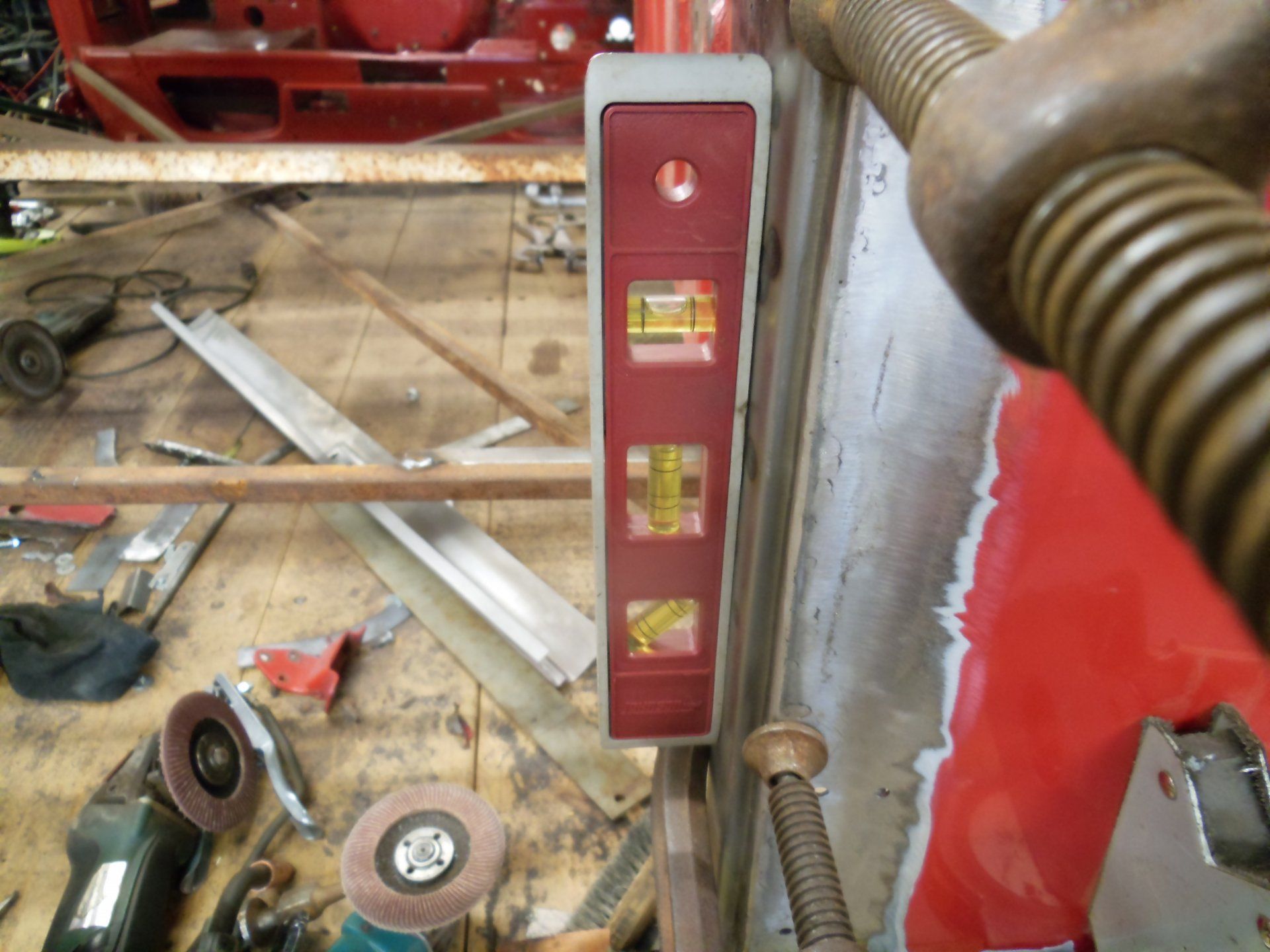

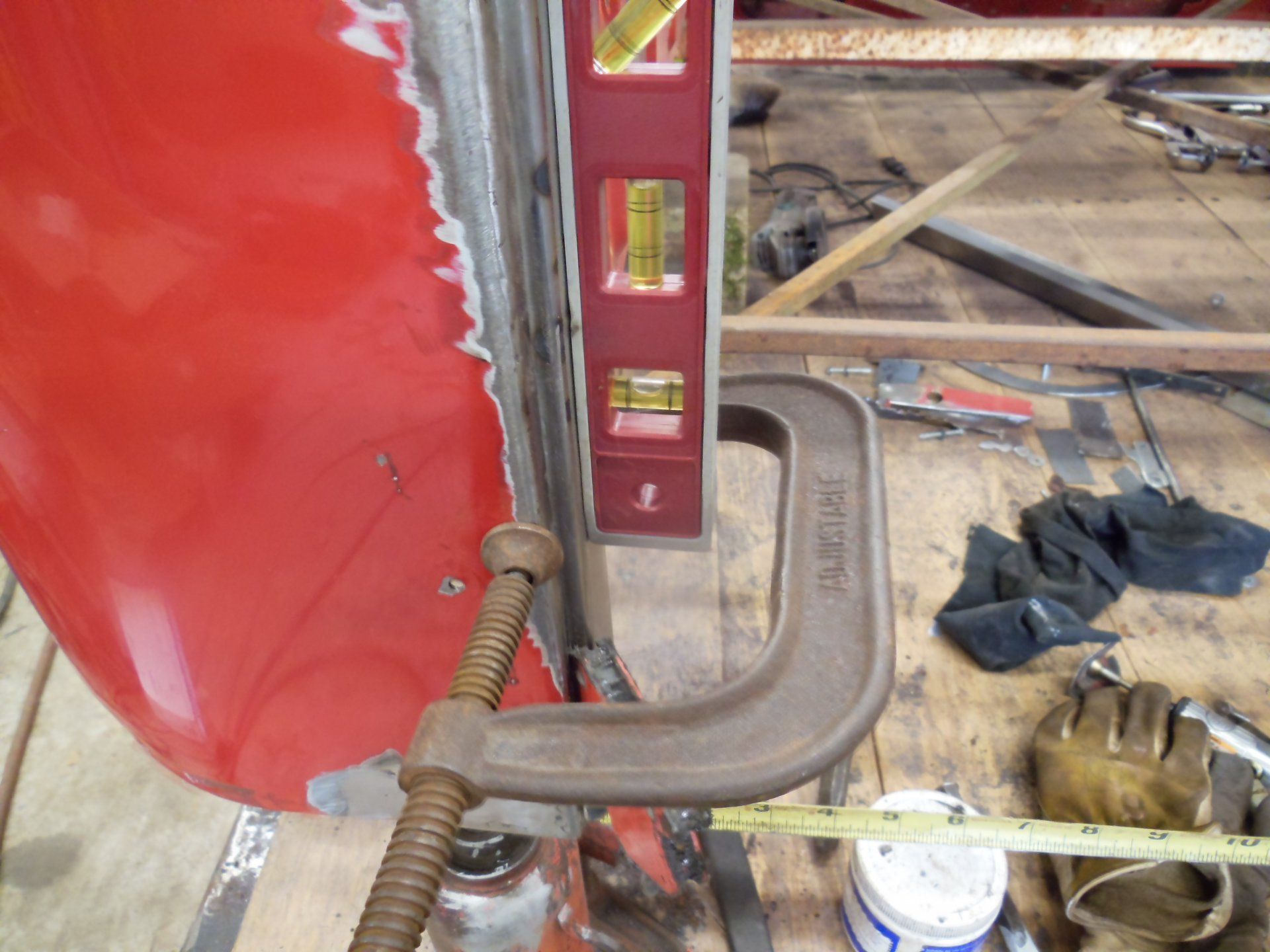

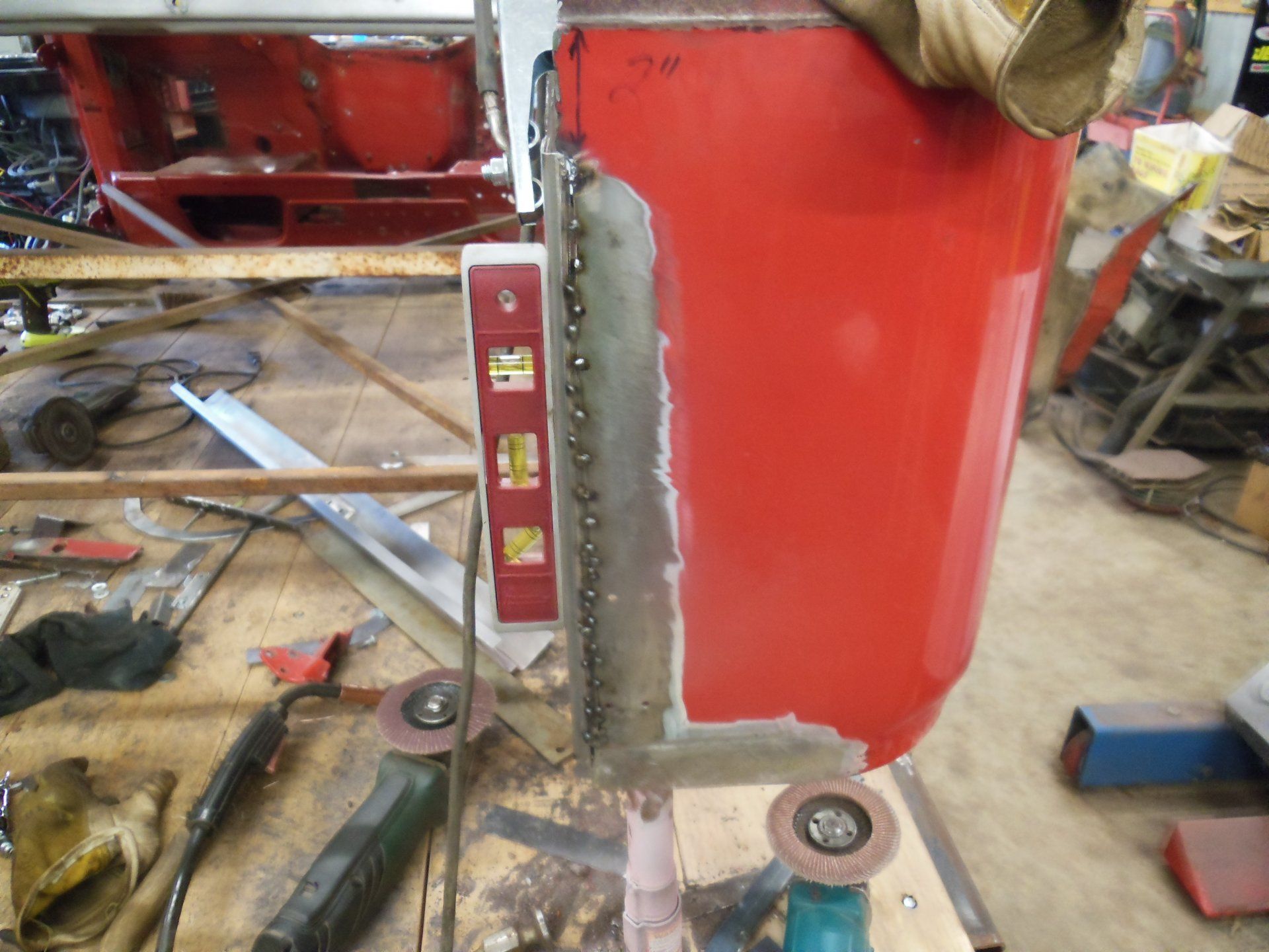

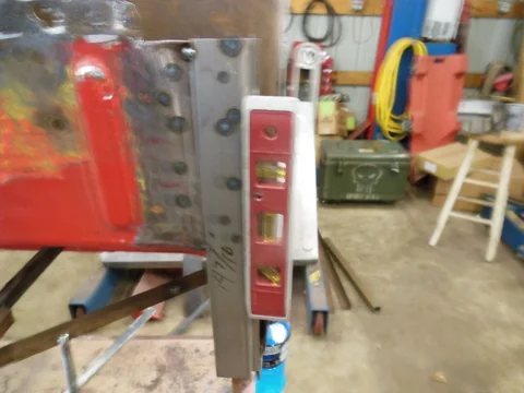

Started on the D/S corner, cut out that piece that attaches to the back side of the corner. Cut it right at the crease
cut the lip off the quarter

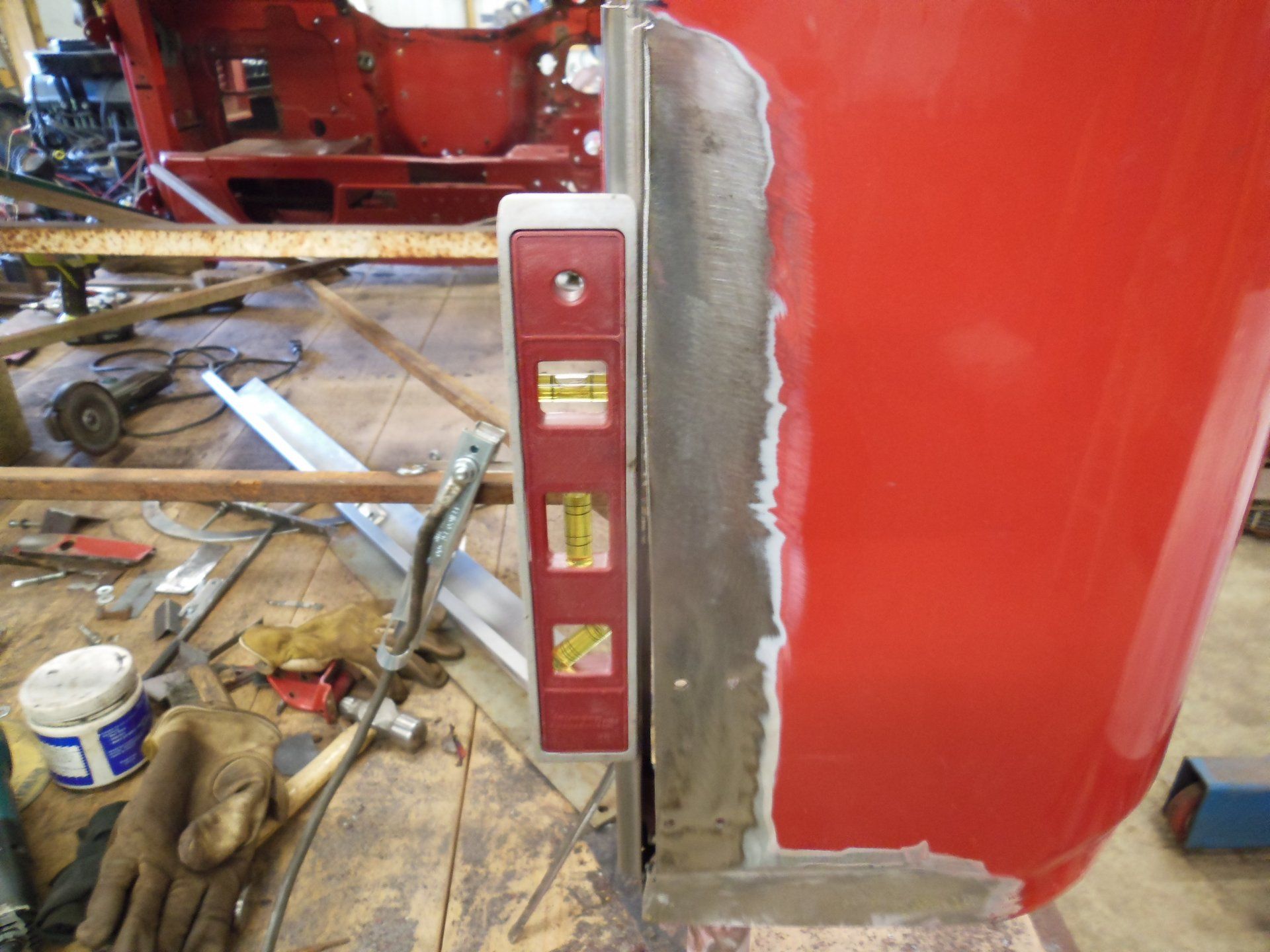

Fit the corner so I can follow it with the quarter and it will be square and plumb.DSCN0683.webp

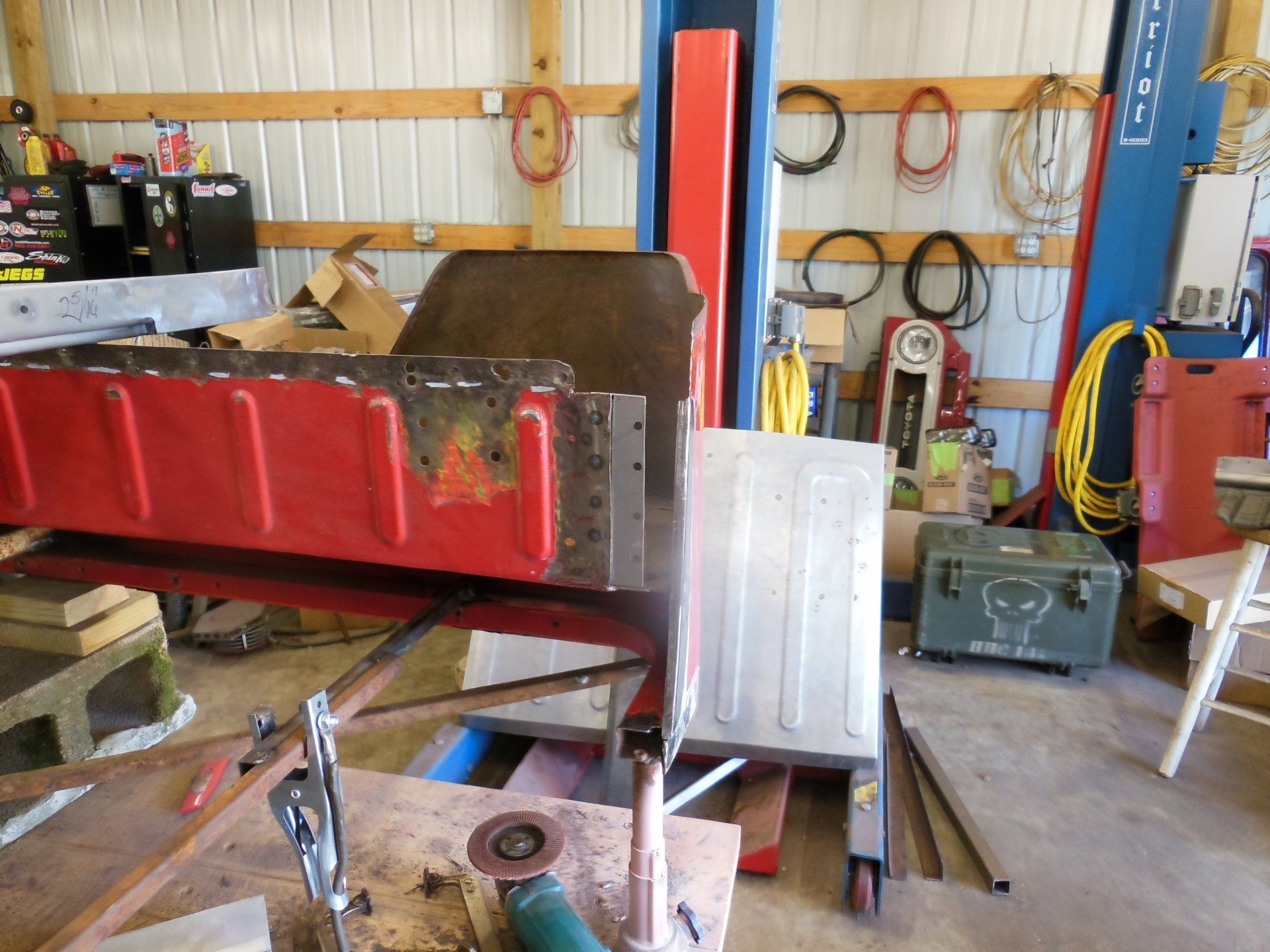

I'll add some to the quarter and put the lip back on, add some to the top edge. Then it will be sill time.... I think.
You're well on your way! What seems like a long time ago, I was handed this heap by the boss, and told to turn it into a presentable FJ40. It just takes time and patience. Every tack weld you do is one less than you had to do before. Soon it will start to look like a Cruiser again! (yes, I was ready to pull my hair out when I stepped into the room and saw the body with no floor and no bracing sitting on a sawhorse and buckets! I think I said "oh no!" a lot.)

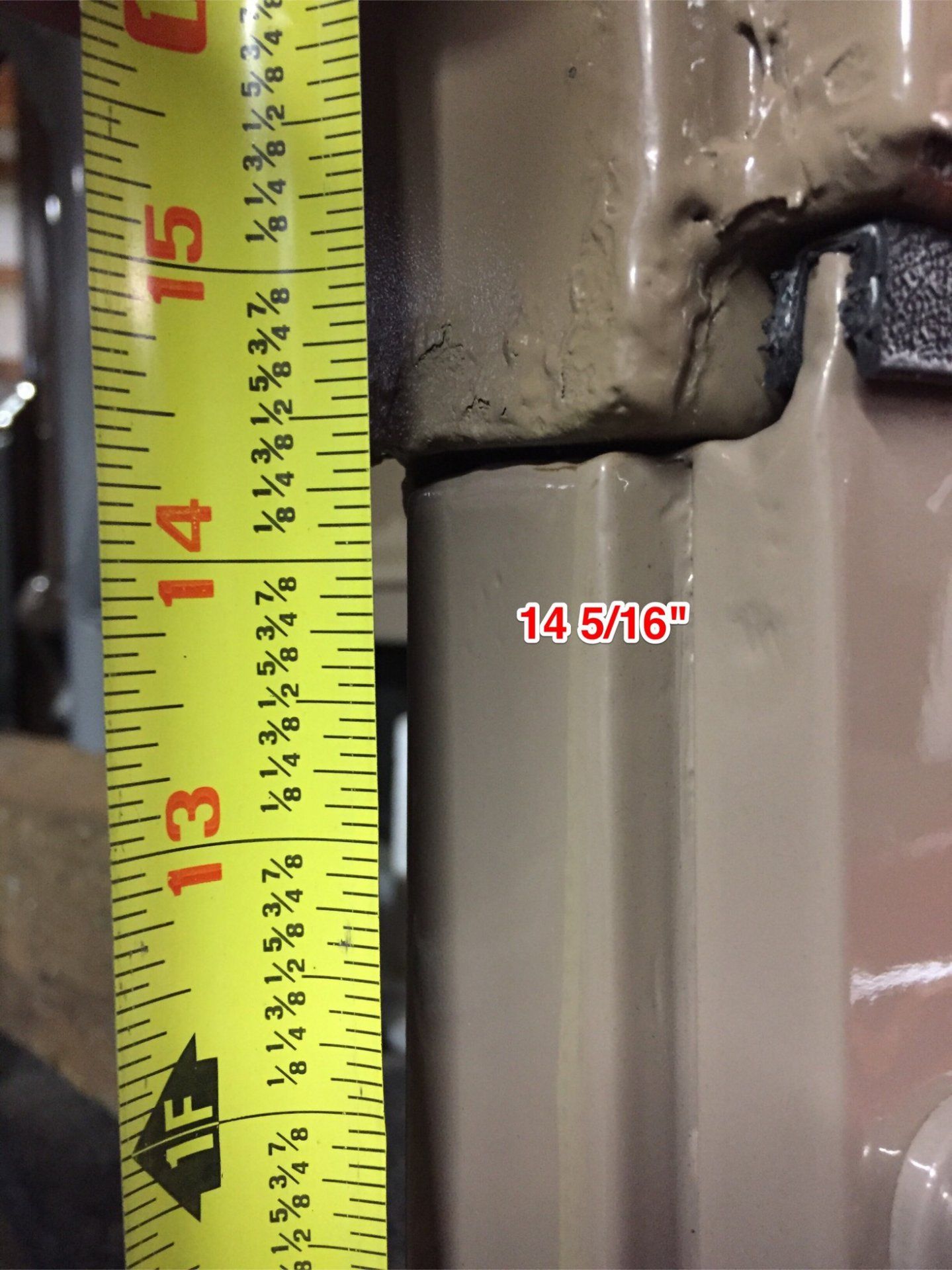

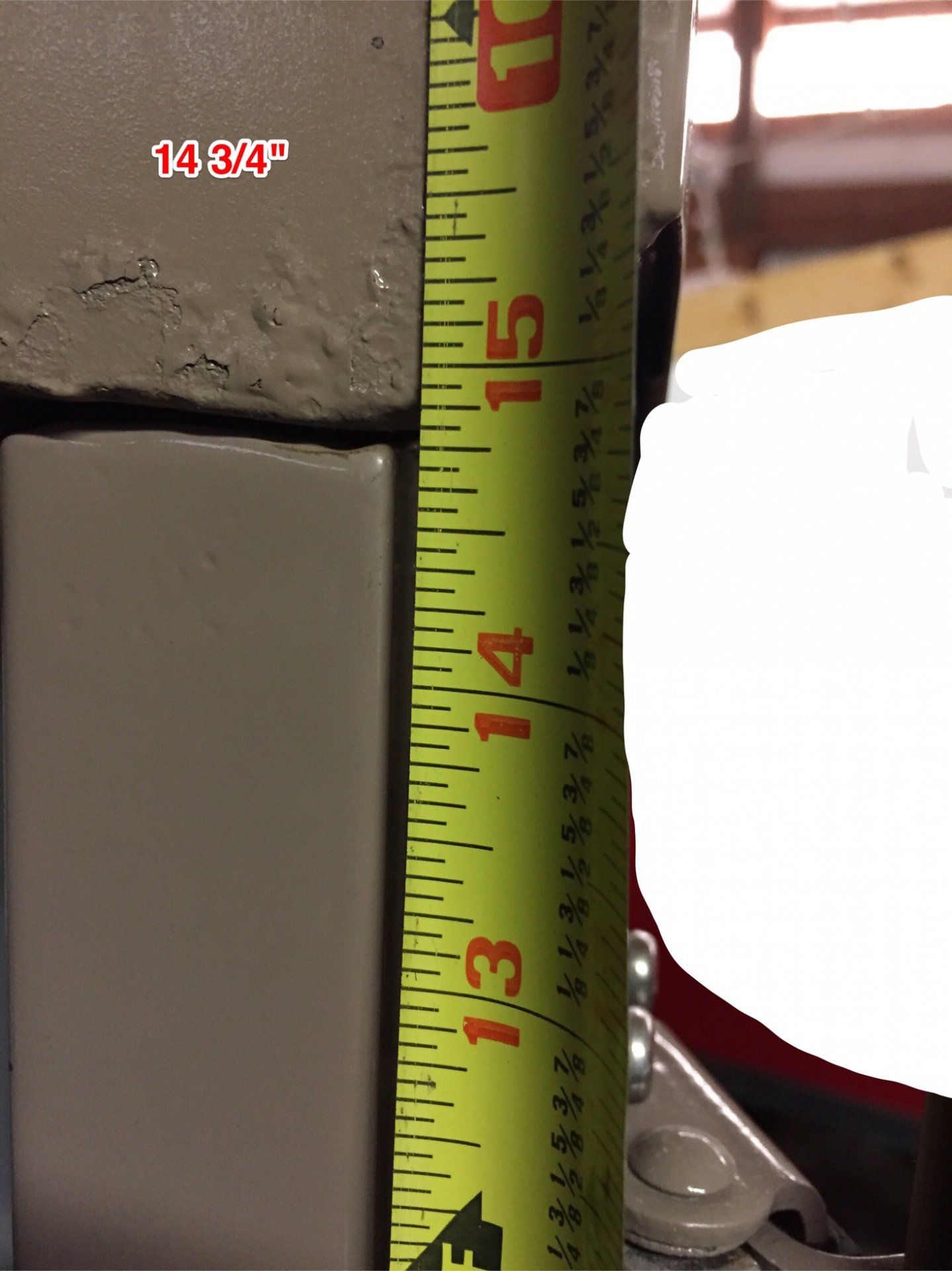

This measurement is from the first lip/ledge of the sill to the top of the rail that the hardtop sides bolt too.
this is from the top of the fender well to the top of the rail that the hardtop sides sit on. My rig came to me with Rhino lining inside, I am not sure how thick the Rhino lining is. My guess is 3/16"

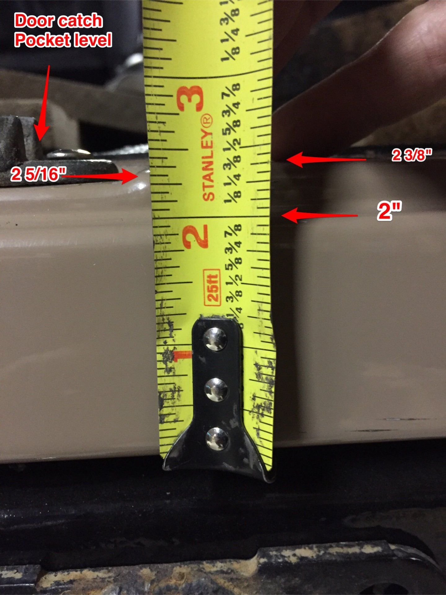

These measurements are from the underside or bottom of the sill.
Mine is:
2" to the flat surface of the first lip/ledge
2 5/16" to the flat surface of the pocket/ledge for the door catch
2 3/8" to the top surface of the sill or "bed level"

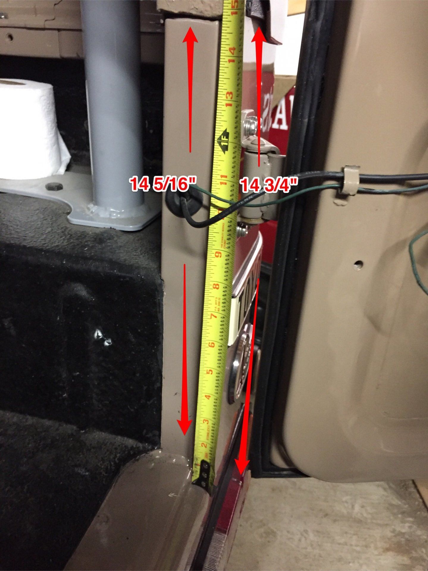

This measurement is from the "bed level" of the sill to the top surface the rail that the hardtop sides sit on.
This is a photo of both measurement previously shown. The lip/ledge of the sill to the rail the hardtop sides sits on. Mine is 14 3/4"
And what I would call "bed level" of the sill to the top of the rail that the hardtop sides sit on and are bolted too. Mine is 14 5/16"

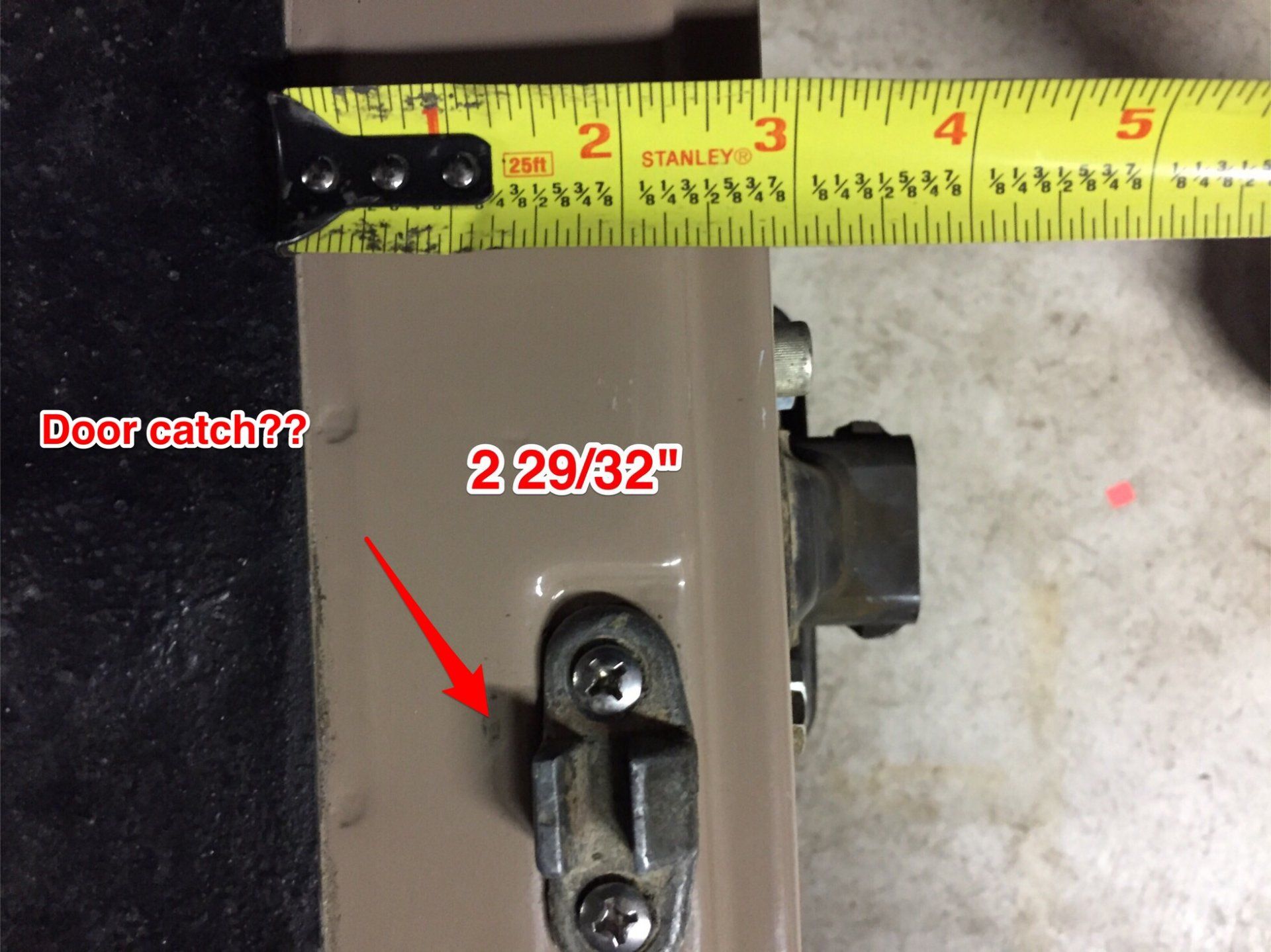

Gator, I haven't had to wrap my brain around rear openings. I am not sure if I understand you. When you say "door catch" I'm thinking you mean the metal bracket that has the two phillips head screws, and it's fastened about in the center of the sill.
Yes sir, that's what I'm talking about. I want to make sure I get it in the right spot, the sill is made so that the catch is off center. Can you measure from inside the right corner to the catch, then the inside of the left corner to the catch? That way I'll know if the sill needs to move left or right.
Probably over thinking again but, the lip on the corners where a little narrow even after working on them. That after market sill my be off a little as well. I hope the opening being a 1/16" small will be ok as its the best I can get square.

Some of the camera angles are deceiving, I wrote down the measurements while looking at the tape dead on.

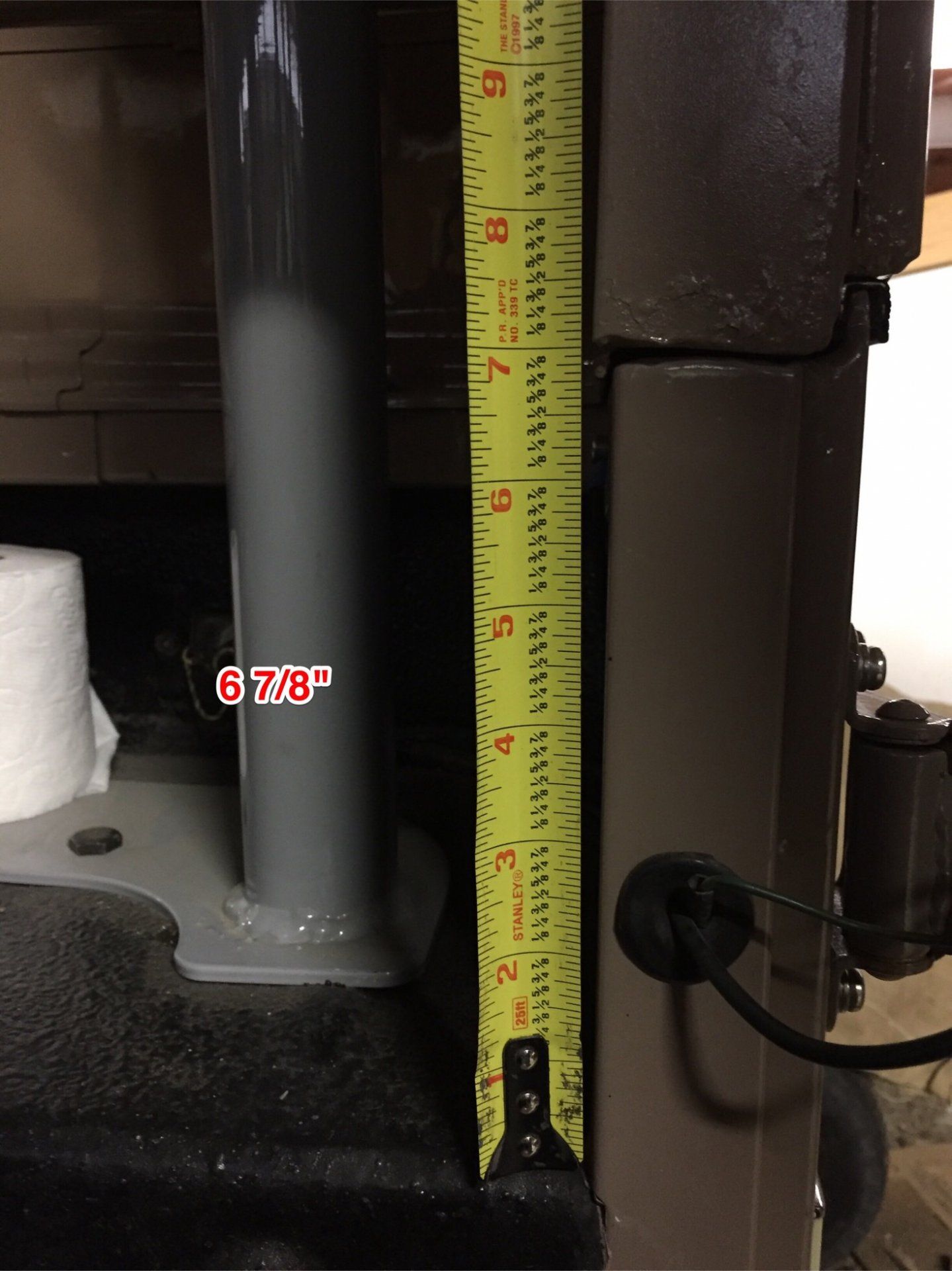

Spare tire catch measurements
