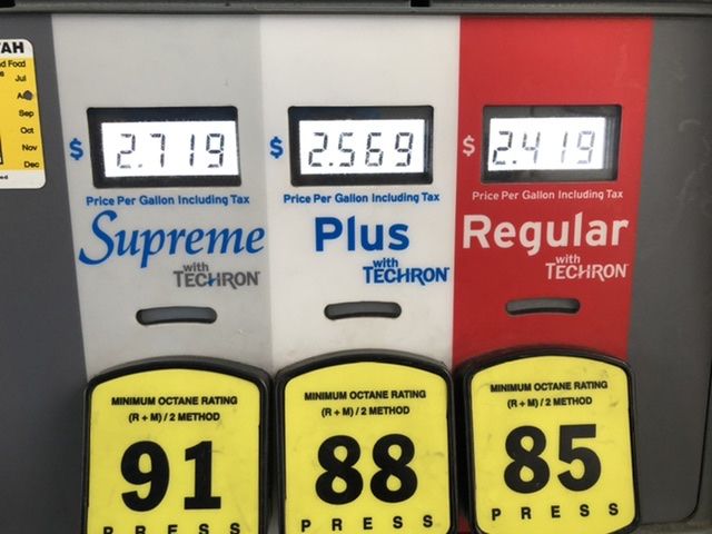

I did the fuel comparison and in my truck the gas mileage decreased by 1-2 miles when using non premium in town....so we use premium and we have a Shell discount card (not a credit card) which saves $.05-$.10 per gallon on fill ups
I just paid .30 more per gallon... and I feel great... I have never heard of anyone rebuilding a land cruiser engine 🤪
cost $3.60 to fill up and she runs great lol
I ran 88 non Ethanol fuel For a year and she ran great.
either way toyota engines are bomb so I’m never worried about rebuilding one lol
