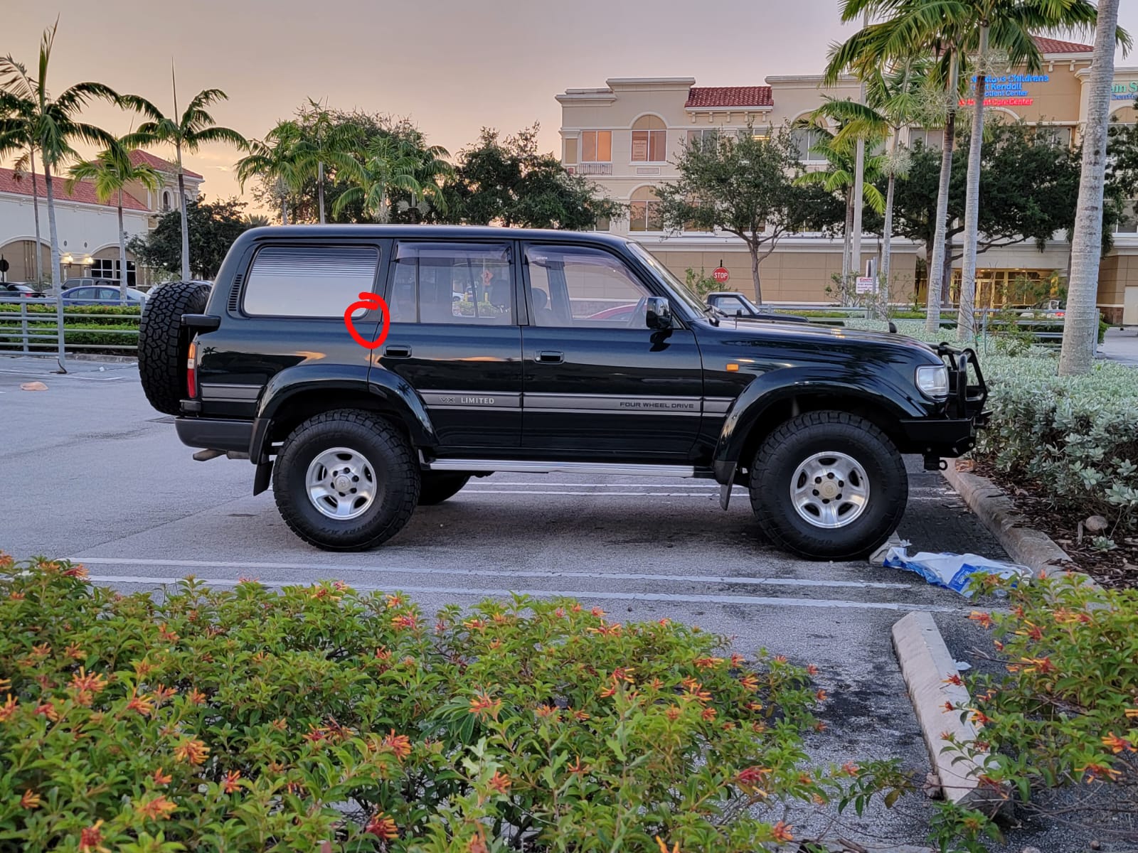

Hi everyone!
I have an absolute CREAMPUFF of a 1995 HDJ81. Single owner, non smoking and garaged for life. Full service records to boot, 150K (KMs) from Miyazaki japan. Non cold spec.
I thought I didn't have any major rust, being that the whole vehicle is so clean and original. That is until I saw a small bulge on the front corner of my right side cargo window. Once I lifted the rubber seal, I almost fainted.

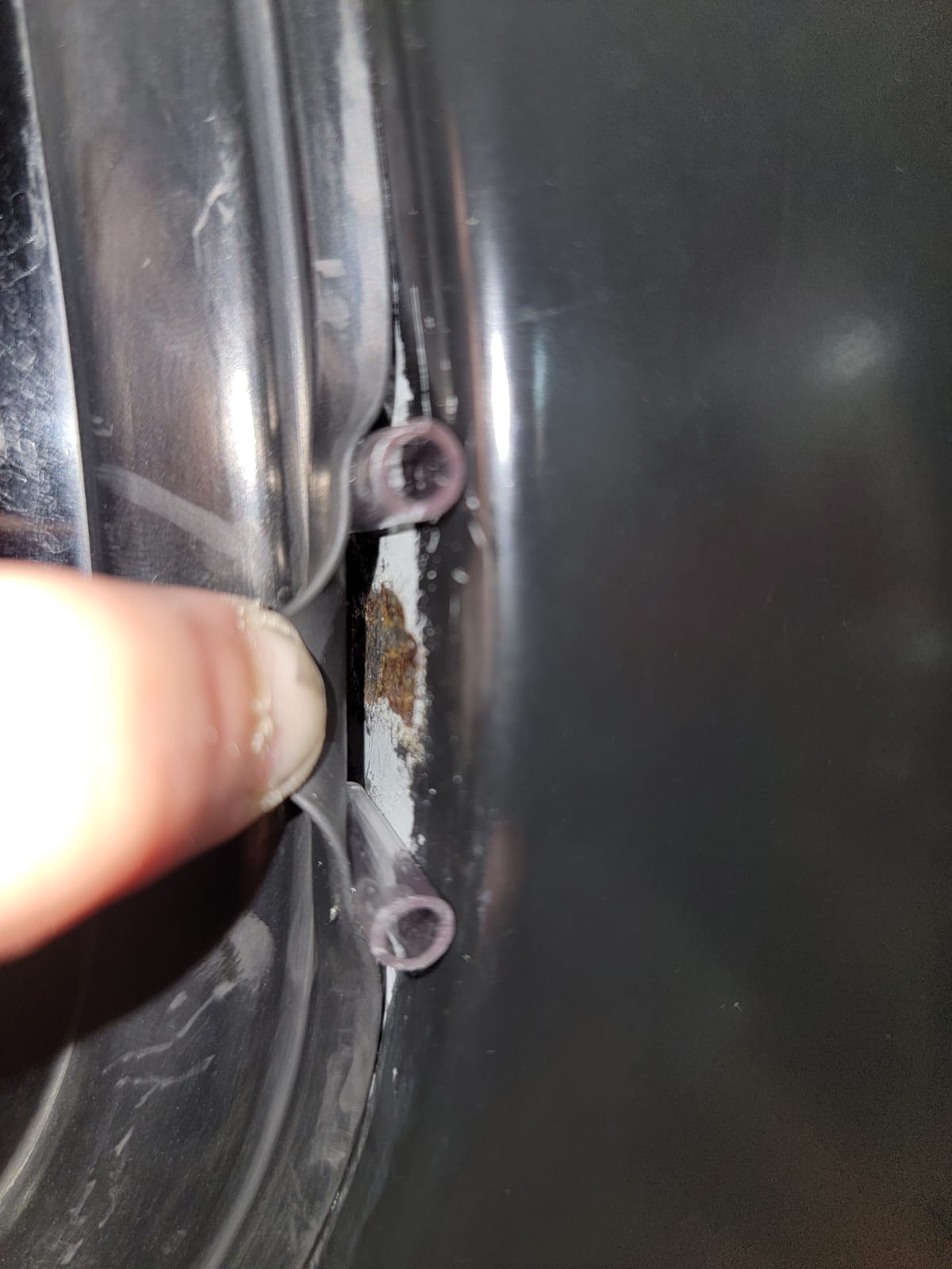

I found some cancer brewing under the seal, Picture is attached. After I removed and flushed out some flakes, I dont think that I have any perforation, but the windows are coming out ASAP to treat it now that I have found this.
What causes rust on this area on so many JDM 80 series with fixed cargo windows? I have seen a few more with the same trouble area.

Has this truck been repainted or possibly some spot work in that area? I’ve demoed quite a few trucks and the pinch welds are typically body color.
I thought of the same thing, but inspecting the area below the window seal briefly with a plastic trim remover, it seems that some areas are worn or missing paint down to the primer or e coat, and other areas are black all the way into the pinch weld. Its almost as if the paint has worn off over time in some spots.
I still have not removed the Window to investigate further. I cannot find any evidence of prior work until now. Zero overspray, zero masking lines, zero painted rubber or trim.
From what I can tell though, the paint on the trucks looks original. The interior and rubber/plastic condition agree with my information that this thing spent most of its time garaged. This was an auction grade 4 which from what I understand is rare for vehicles this old.

Just saw a little bulge at the rubber seal. I have many old Yotas. I can smell rust at this point. Luckily im not in the rust belt, but we get plenty of rain.
Sounds good. But I’d recommend pulling that glass and inspecting a little deeper. Something is not right as pinch welds came body color from the factory. You’ll need to do this if you’re gonna address the rust.
