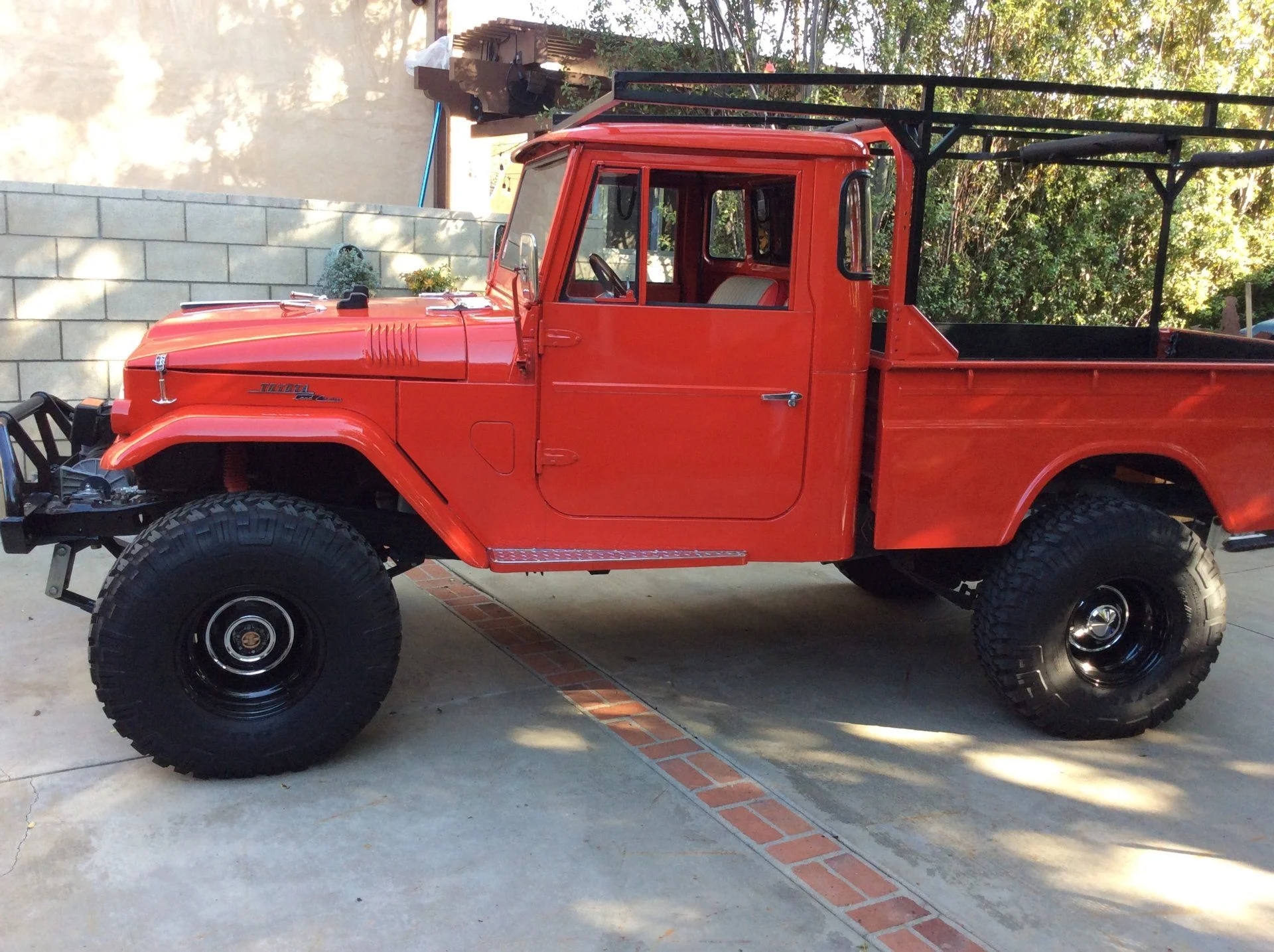

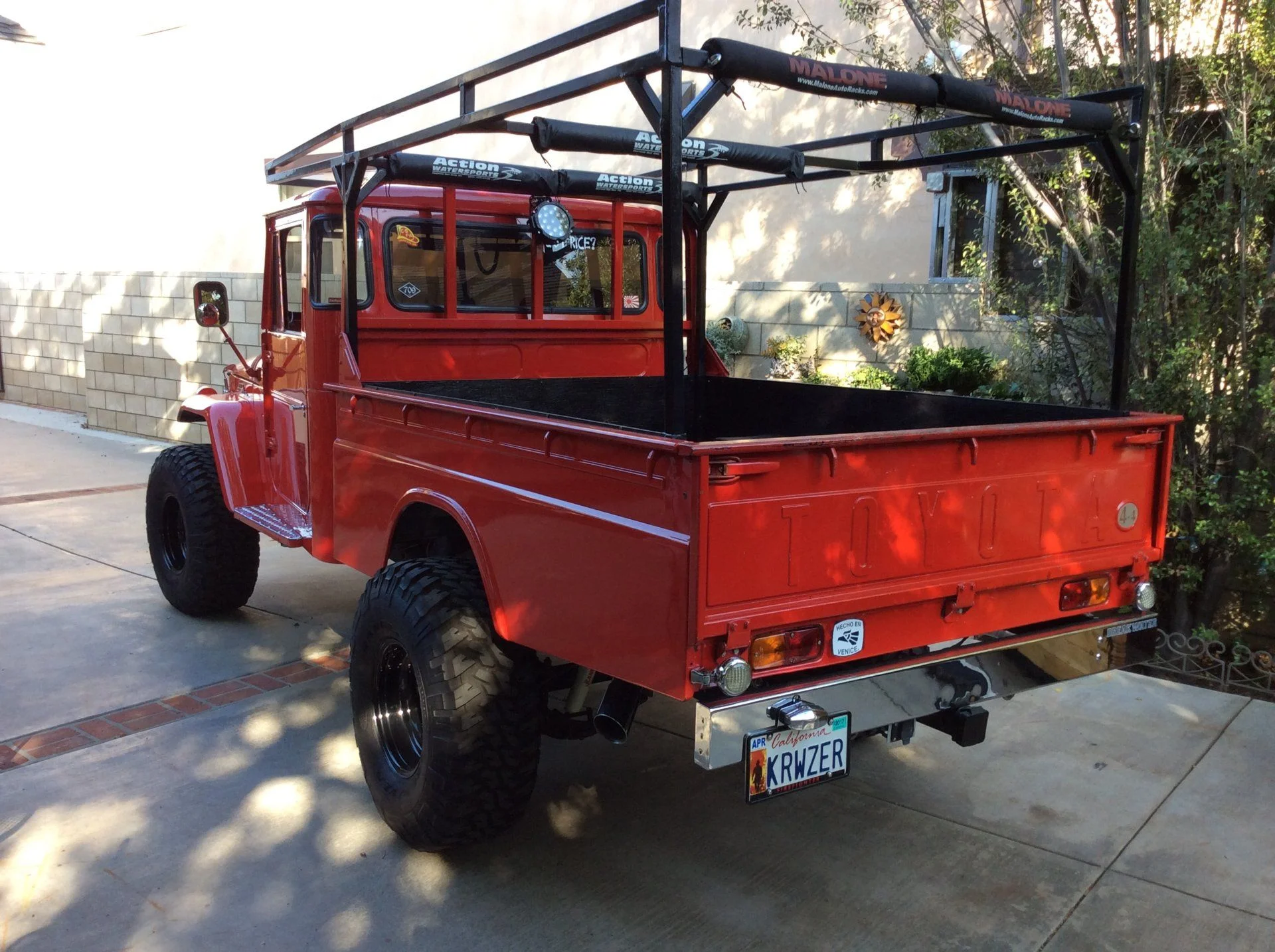

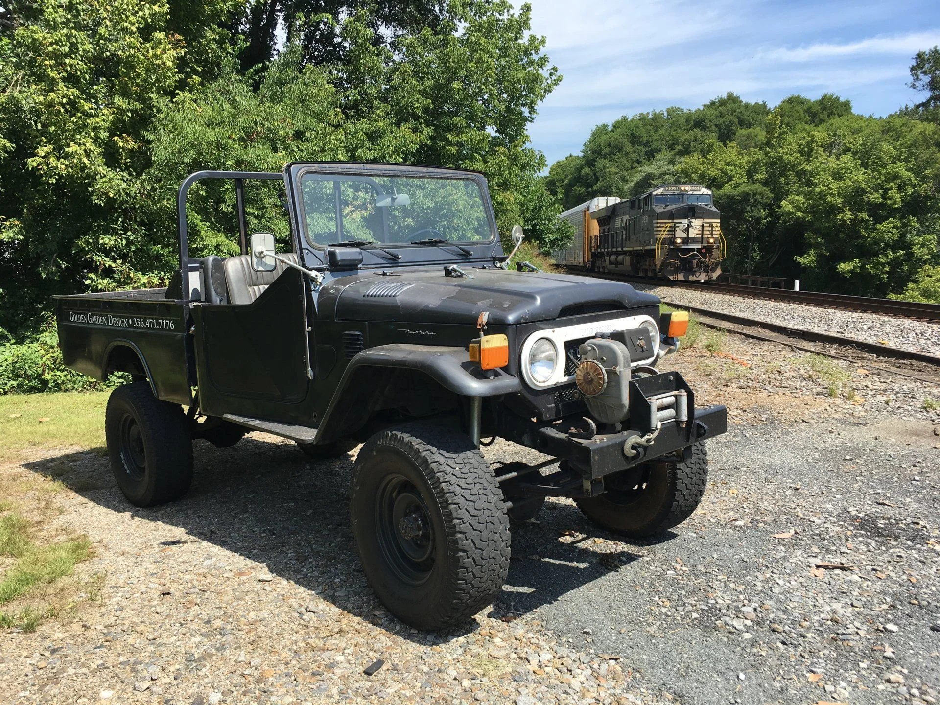

2" lift and flares in the back to replace the PO's hack job.
@76FJ40 your setup looks great!
Is that an OME lift with 35x12.5x15?
Thanks. According to the receipts that came with the truck, all I cal tell you is the lift came from SOR.
Yup, 5x12.5x15.
Yup, 5x12.5x15.
Cool. Im running the OME 2-1/2". One more question, is that an 8" or 10" rim?
BTW, I think we met at Relic Run this year, I had the tan 45

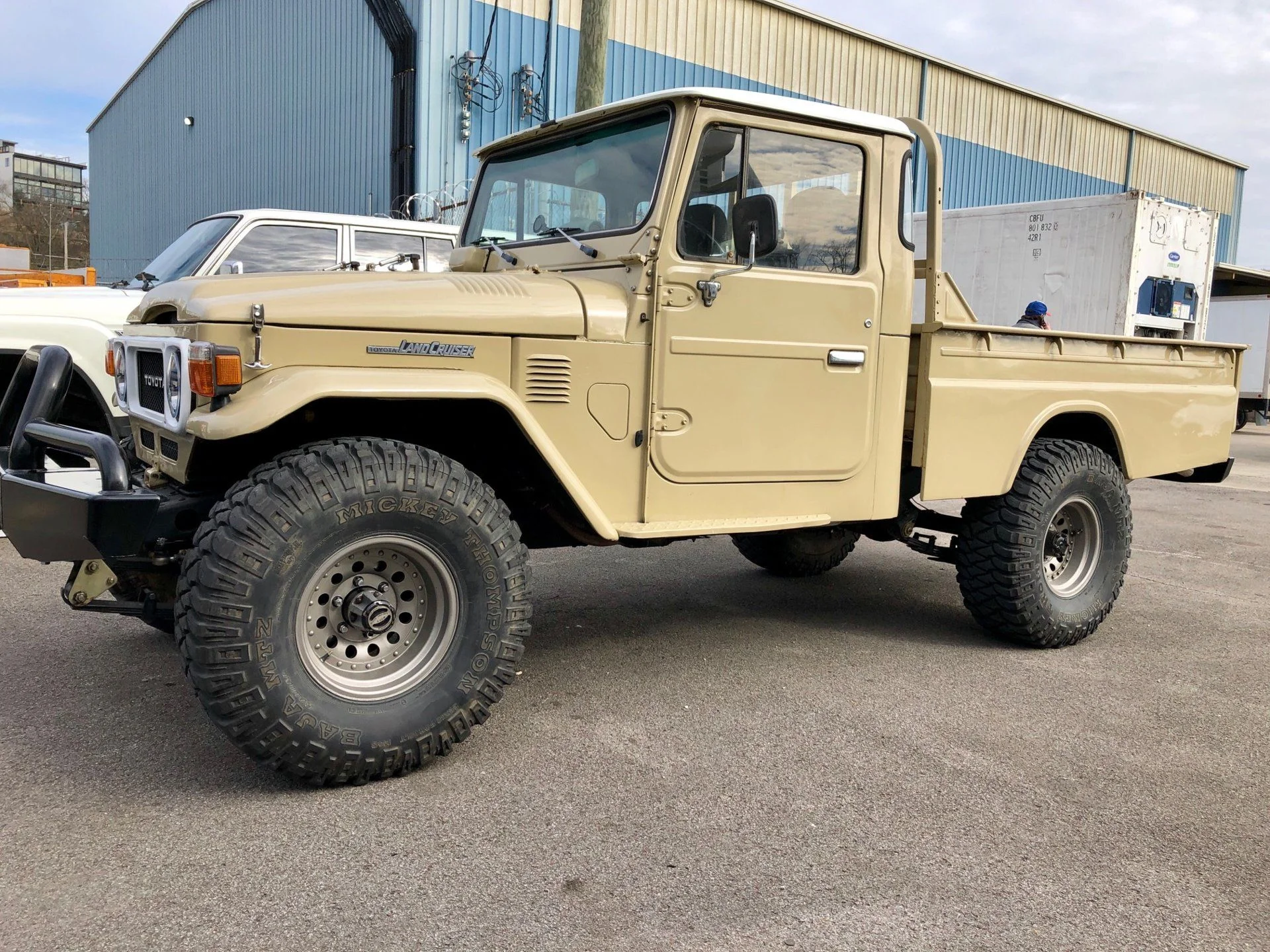

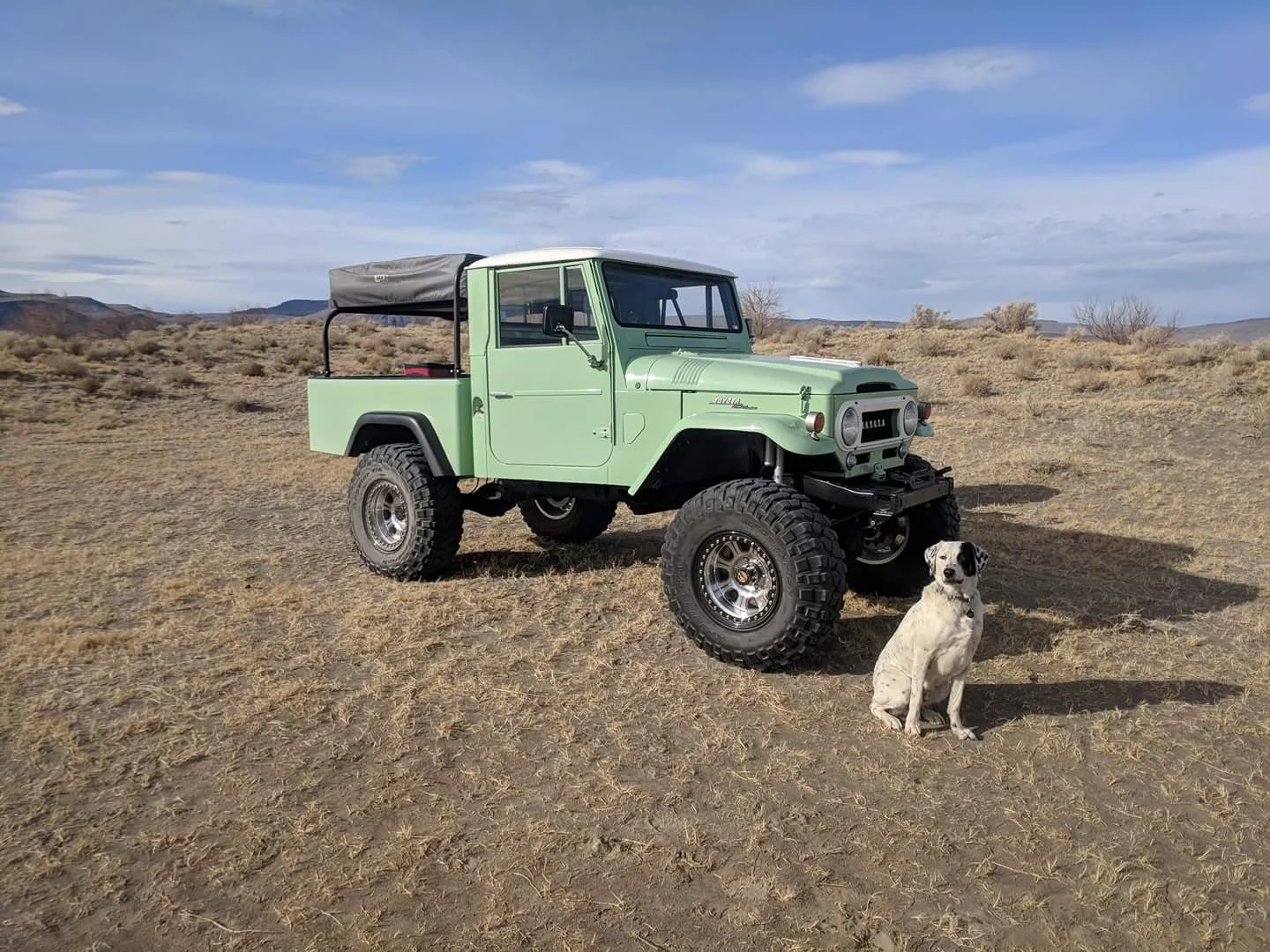

37 but you get the point. SOA on fresh springs. I would like to lower it maybe 2 inches.
Love your 45 UK
Ive run the 315s you saw at the relic run as well. Wearing 37s now but Im with Justin in wanting to lower it a few inches. Actually id like to have a 2.5” ome setup if you go soa. Just sayin’ :D
SOA. Stock springs. 315s 5.5” bs 7.5” wheel

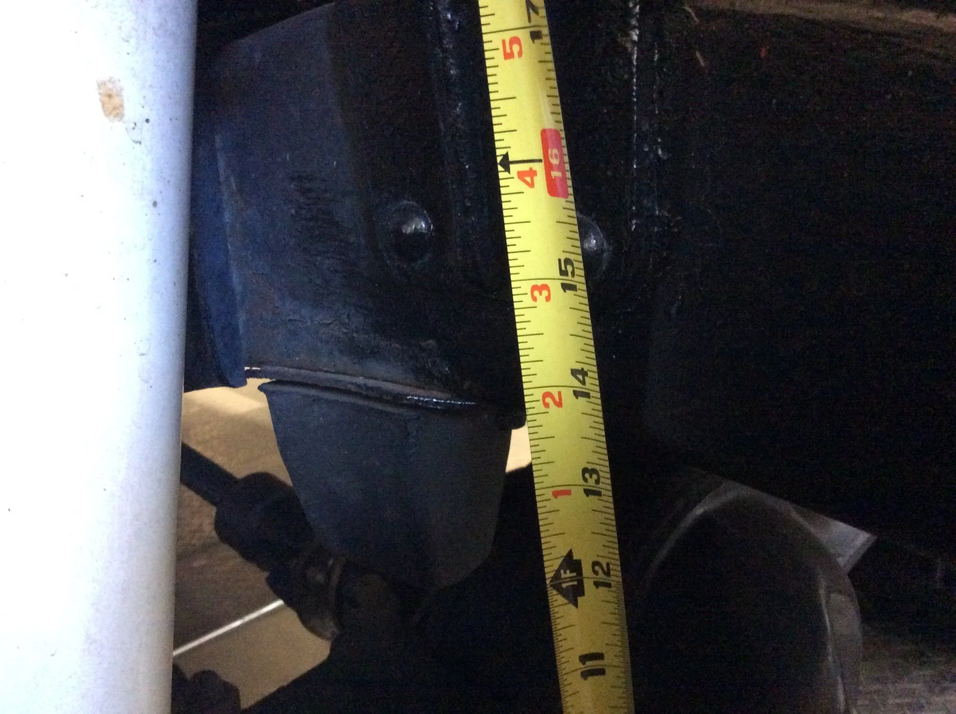

Needs more bump-stop up front for 37s
Doesnt really get wheeled as it has been more of a dd/work truck. 37s fit better visually. 35s drive better but look kinda small on this SOA. Ive found the skinnier the better. Tire and rim. And i run higher backspacing to get it inside the bed wheel lip. had one front inner fender incident at full lock but only because running a set of 2.5” bs wheels offroad.
If you are wheeling more you may want the width for stability. I know this setup looks a bit tall n skinny overall.

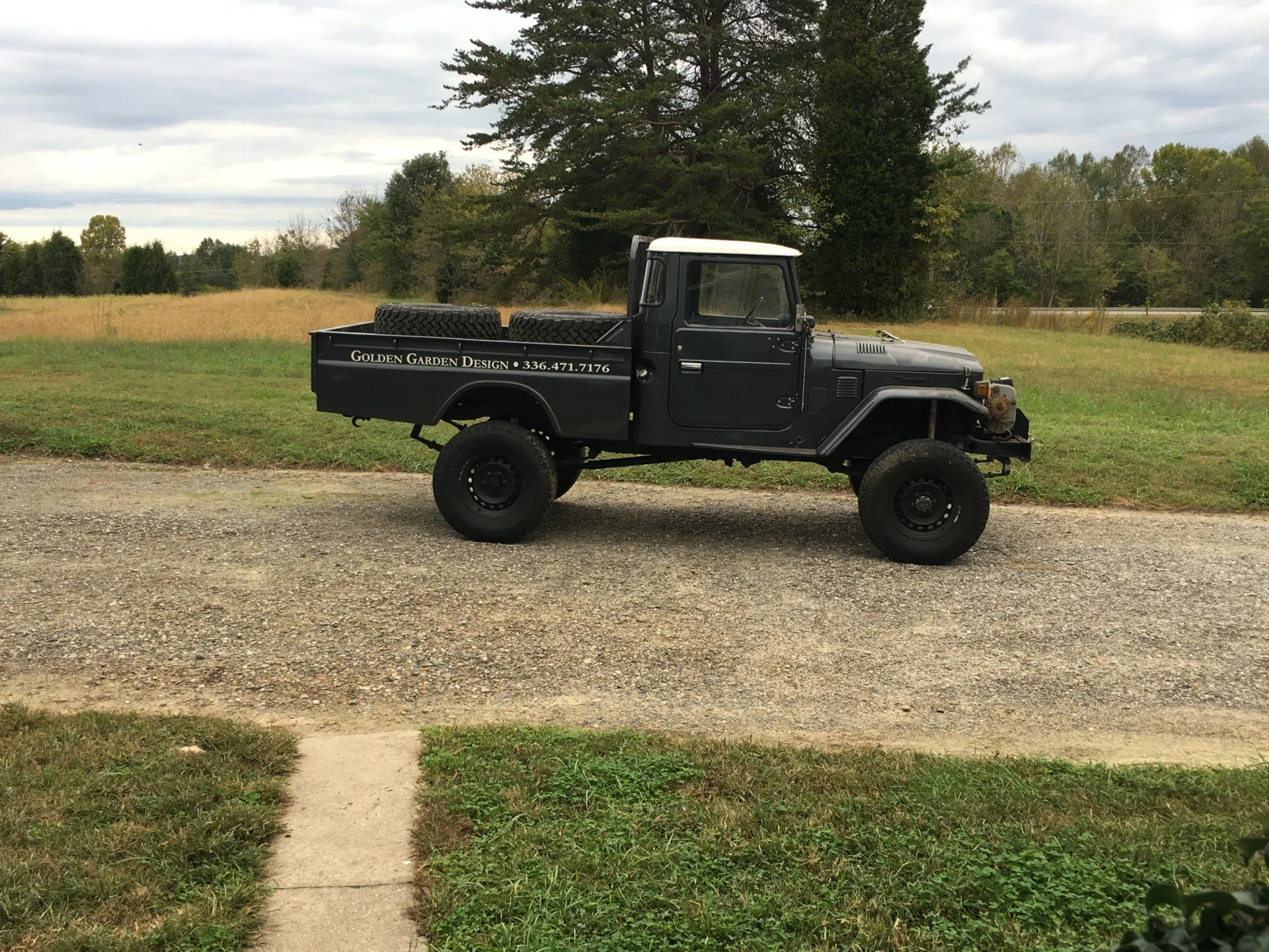

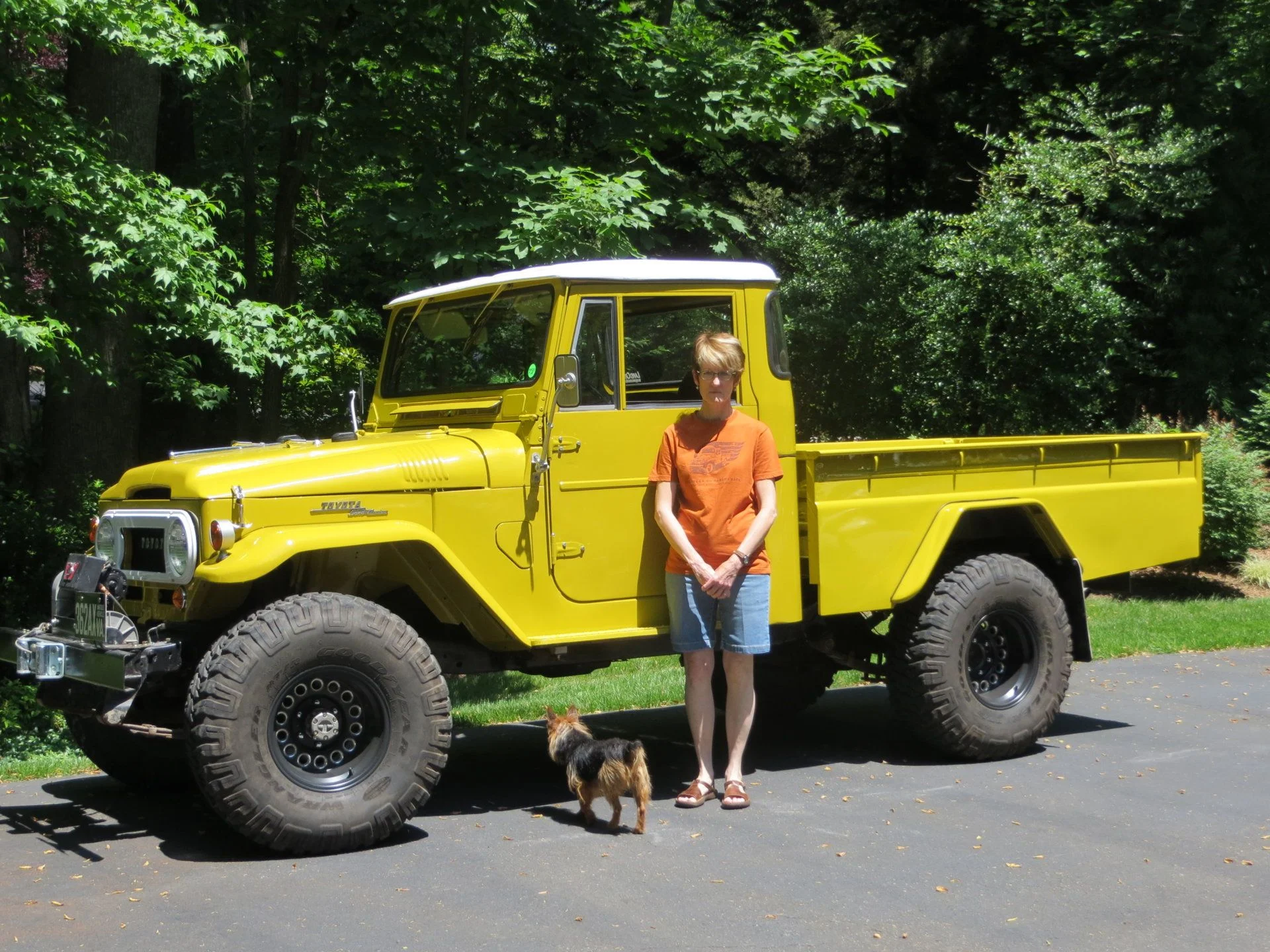

My intentions at this point is to just try and keep mud etc. where it belongs. In a way I’m in a unique position in that I have “mutated” my Cruiser, into a Hybrid Chevota and have no idea in ____ just how this experiment will pan out ?!
At any rate, my Silverado chassis is around 9 inches wider than the 45 frame was. I HOPE there are improvements in both stability & overall handling. Because of that width there was an increase in the front fender width (4 in. ea.) as well as the Jeep fender flares on the rear. (7 in.ea.) The pictures that I posted are NOT my tires. They are 35X12.5XR16’s which will defeat the purpose of widening my fenders because they (12.5) stick out just a bit too far. Thanks for the info on the skinny’s that are out there though, at least I have something now to check out.
