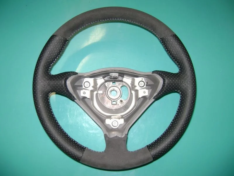

Very cool. Hopefully they make Alcantara in Oak.
I am thinking 2 tone. Oak Alcantara on top and bottom and oak perforated leather on the sides. Also, a tan stripe at top center, GT3 RS style (JK).
What stiching is the standard Toyota stiching?
Standard Toyota Stitching is "baseball" design.

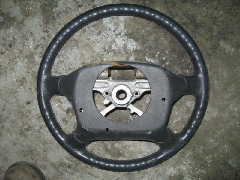

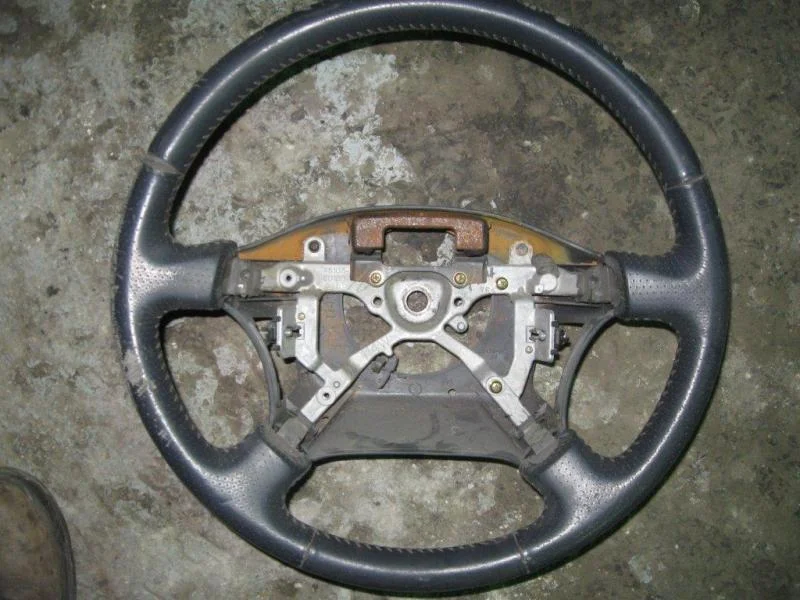

I got the loaner in. It won't fit either. Apparently, the Engineers at Mr. T have a sick sense of humor... Pics are worth a 1000 words, right?
This is a GRAY loaner wheel that Don at DSCW purchased from someone in Washington State, then had it shipped directly to me to use while my wheel was in his possession. That's a no-go for the obvious reasons above (different clock spring interface and different diameter steering shaft).
Worth noting is the little tab/nipple as visible in pic 2 and pic 3.
On the 2000 LC OEM - mine - the tab is on the lower-left spoke and there is a casting stamp of "114W" next to it. On the loaner, the tab is on the lower-right spoke, and the casting on the lower-left spoke is 111W.
Ironically, this gray loaner looks IDENTICAL to the HDJ wheel posted above, but the leater is in immaculate condition. Go figure....
[edit] I just found out from Don that he got this wheel from a 1998-2000 LS 400, which is why it wouldn't work... Looking at the HDJ wheel above, although the lower left/right spokes look like the LS wheel BUT it has a very similar part number to the UZJ wheel (a 6 in the part number vs an 8), the clock spring interface on the back of the wheel appears to be the same as for my UZJ wheel, so it *should* work...
Looks like the key to getting one to fit is to match up the CASTING number on the lower-left spoke of the wheel... Notice that the HDJ wheel above carries the 114W casting that my UZJ wheel has...
