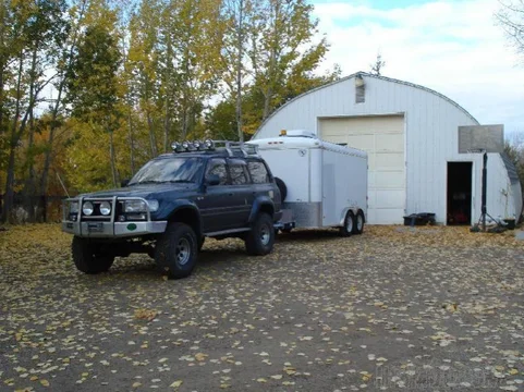

I have pulled around some of our equipment/office trailers with my 80 and it did not do too bad. The trailer is around 6K+ with a 20 gallon fuel cell on the tongue and a 15 gallon water tank right behind that so it is quite tounge heavy.
The 80 has a Slee 6" lift and 4.10 gears/35" tyres so it is a less than ideal combination but with some rear bags and a WD hitch I would not hesitate to use it to tow 5K 4-6 times a year. This would be with the caveat that running this combination is going to require more attention and have a smaller margin of error than a heavy duty diesel truck (see picture below the 80 for the regular tow rig) and no mountain towing.
Powerwise I have a 1HD-T diesel 80 so there is no comparison to be made to the gasser.
