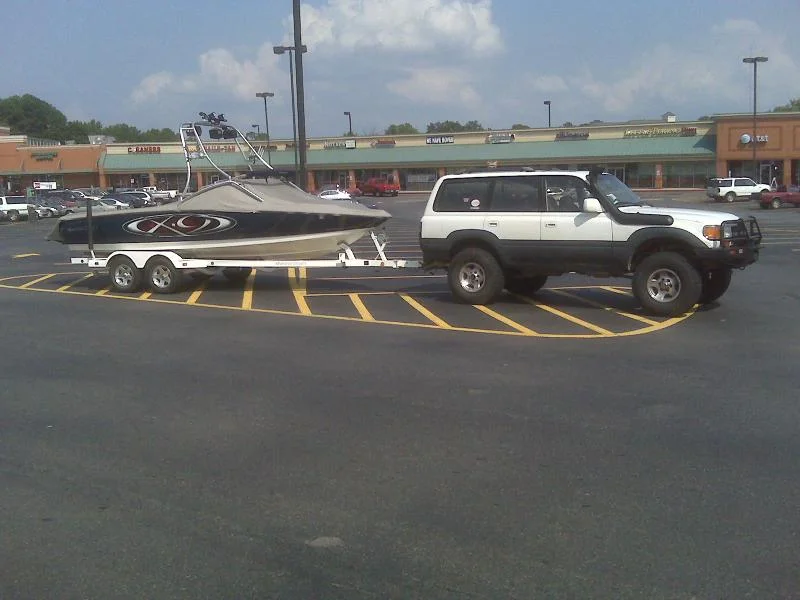

I've towed our 21ft Mastercraft behind the 80 several times in the mountains. It has dual surge braked axles. It towed fine, even with 4.10's and 315's.
Even though it is not a light boat, total weight w/ trailer is probably around 3k lbs, not the best comparison to the FJ40 on a heavy duty trailer.
I've already got access to the trailer, what I really need to borrow is an 80 like mine with 4.56's, and one with 4.88's.
Bailey, how much does your ski boat/trailer combo weigh? You've pulled it with the 80 right?

Before I had my duramax chevy, I would tow my 5k lb boat on a regular basis with my fzj80 315's and 4.88 ratio. I have surge brakes on the trailer and it did fine. I even crossed the mountains a couple times a year and it was tolerable, but not ideal. As for gearing I really doubt you'll have any better fuel economy with 4.56 vs. 4.88. I also had towed a 4runner on a trailer short distance a couple times, but had no trailer brakes, and it was kinda sketchy.
Great, thanks. That is the kind of input I am looking for. Good to know re the 4.56 vs the 4.88. I guess if I am used to driving slow anyway, my highway mileage shouldn't suffer much with the 4.88's, and around town should improve.
