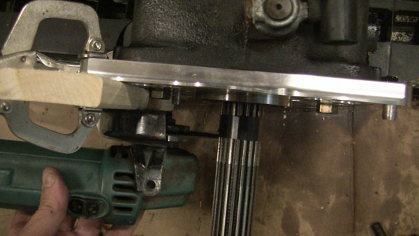

A question before I cut the shaft
I'm prepping to cut the output shaft and I just wanted to be sure I'm cutting at the right location.

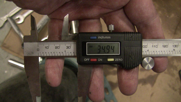

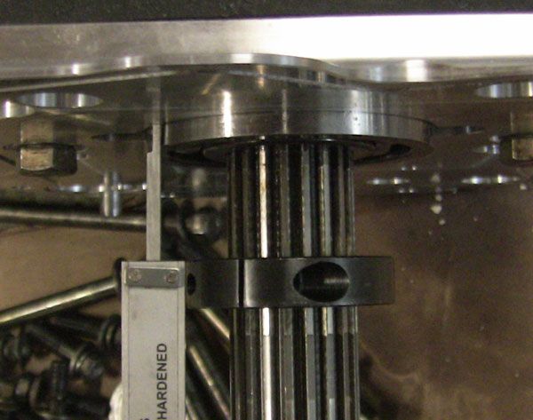

Cam said to cut the shaft 35mm from the face of the trans portion of the adapter plate. So this is how I came up with it. I locked my caliper just under 35mm.
Measured that distance off of the adapter plate and clamped the ring in place as a guide.
I then used the ring clamp as a guide for some electrical tape and removed the clamp ring since it's needed later. I rigged up a piece of wood to rest the grinder against for stability.
Is this the correct place to cut the shaft? I've read elsewhere that people have measured the depth of the receiving splines in the Toybox instead of using the 35mm depth measurement. I measured the depth of the input splines on mine and they are 42mm deep, a difference of 7 MM. Does this matter? Should I cut the shaft at 38 - 40 mm instead of 35?
Thinking about cutting at 42mm

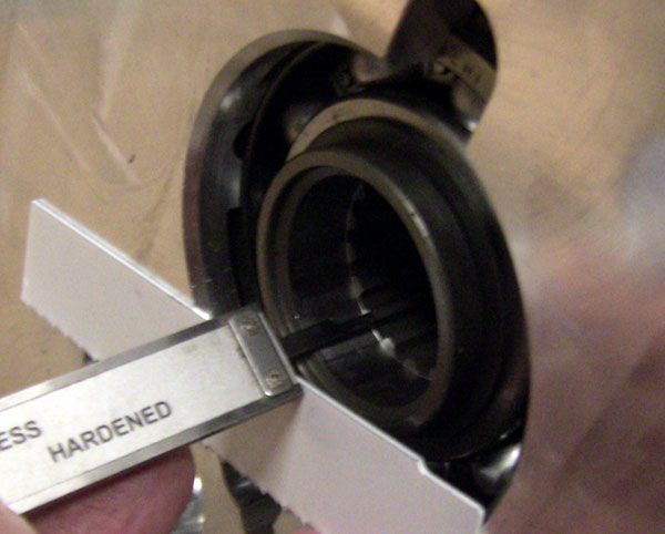

I'm thinking the cut should be in the 40 - 42mm range. I took some more measurements and snapped photos to explain the method to my madness.

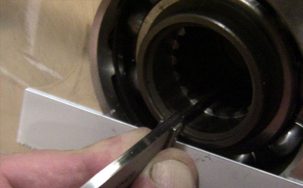

The input splines in the Toybox start at 17.8mm from the front face of the adapter plate. (I have deducted 1.1mm for the thickness of the saw blade I'm using as a straight edge.)
The Toybox input splines are 44.7mm deep:
If I were to cut the H55 output shaft at 35mm I'll end up with only 17.1mm of engagement between the shaft and the input splines. If I cut at 42mm I'll have 24.1mm of engagement and 2.5mm of room before the splines bottom out to leave room for expansion.
35mm might work fine but wouldn't 40mm - 42mm be a better place to cut? Am I missing something in my measurements?
I ended up cutting at 40mm. It fits perfectly.
I did measure the diameter of my output shaft in a few places. It was slightly larger than 35mm in a few spots ranging from 35.02 to 35.08mm. I spent some time with a file and 80 grit plumber's emery paper. It took about 4 hours of sanding and filing to get the output shaft to the point where I could remove the Toybox without a bunch of prying.

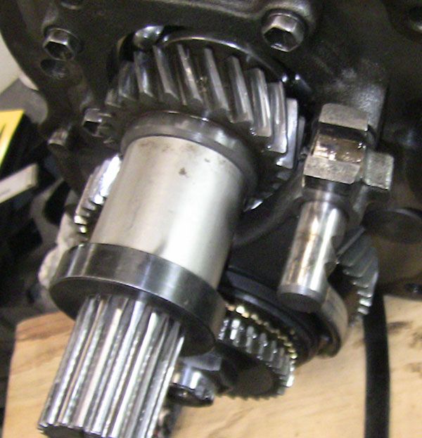

Once you have done this you need to dis-assmeble the plate and hardware thorughly clean all affected areas focusing on the fith gear area. Now remove the last bearing on the output shaft, and the steel spacer sleeve. It is now time to install the Clamp Ring.
Installing the clamp ring
The clamping ring will slide most of the way on, but sometimes needs to be tapped the last 1/2 inch. Tighten this with a 3/16th's inch hex key wrench pritty much as tight as you can possibly tighten it.

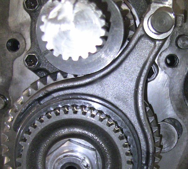

I removed the steel spacer and slide the clamping ring down the output shaft. This doesn't work. (The spacer doesn't easily fit down the shaft at this point, it's .5mm too small so you have to pry it open.) When you get the clamp ring down the shaft it interferes with the 5th gear shift fork. I think the spacer needs to stay in place. Is that correct?
