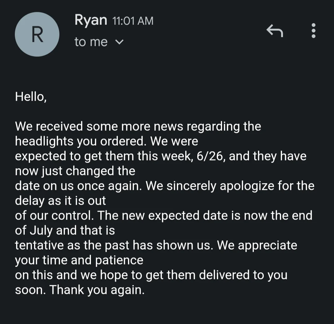

I have been waiting for LCE to ship me their H4 conversion kit... just got an email it is still on backorder.
Soooo now I am looking at other options. I'm in the same boat, I have a '92 LN106 Hilux. It takes the 5x7 rectangular sealed beams.

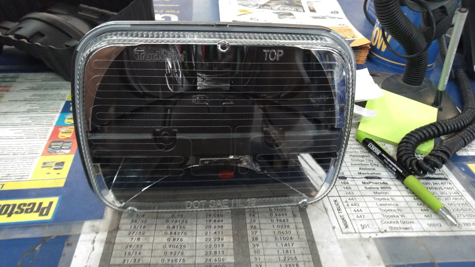

There is a company called Rigid Industries which makes a high-quality LED for 5x7 applications. But it runs over 600 bucks. My concern with LEDs is they don't get warm, and won't really melt snow off the front of the housing.

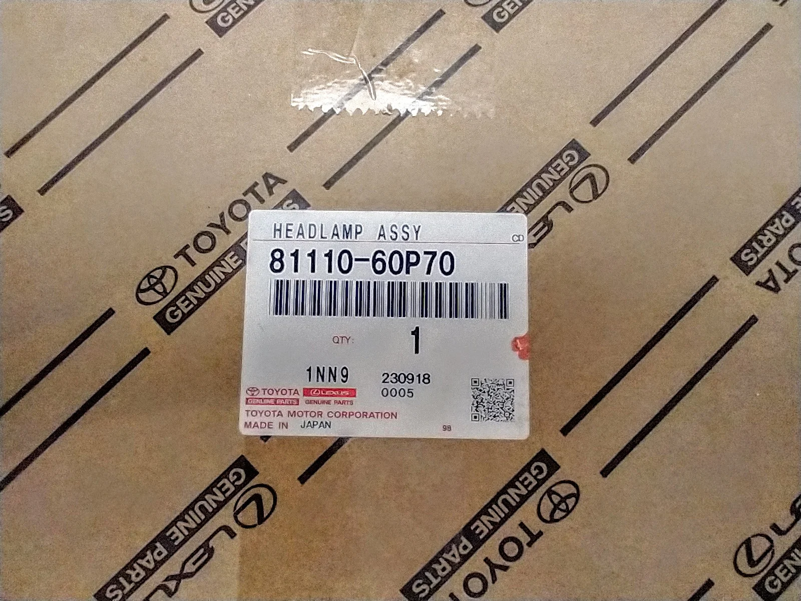

Problem solved. Part number is superceded by 37455c.

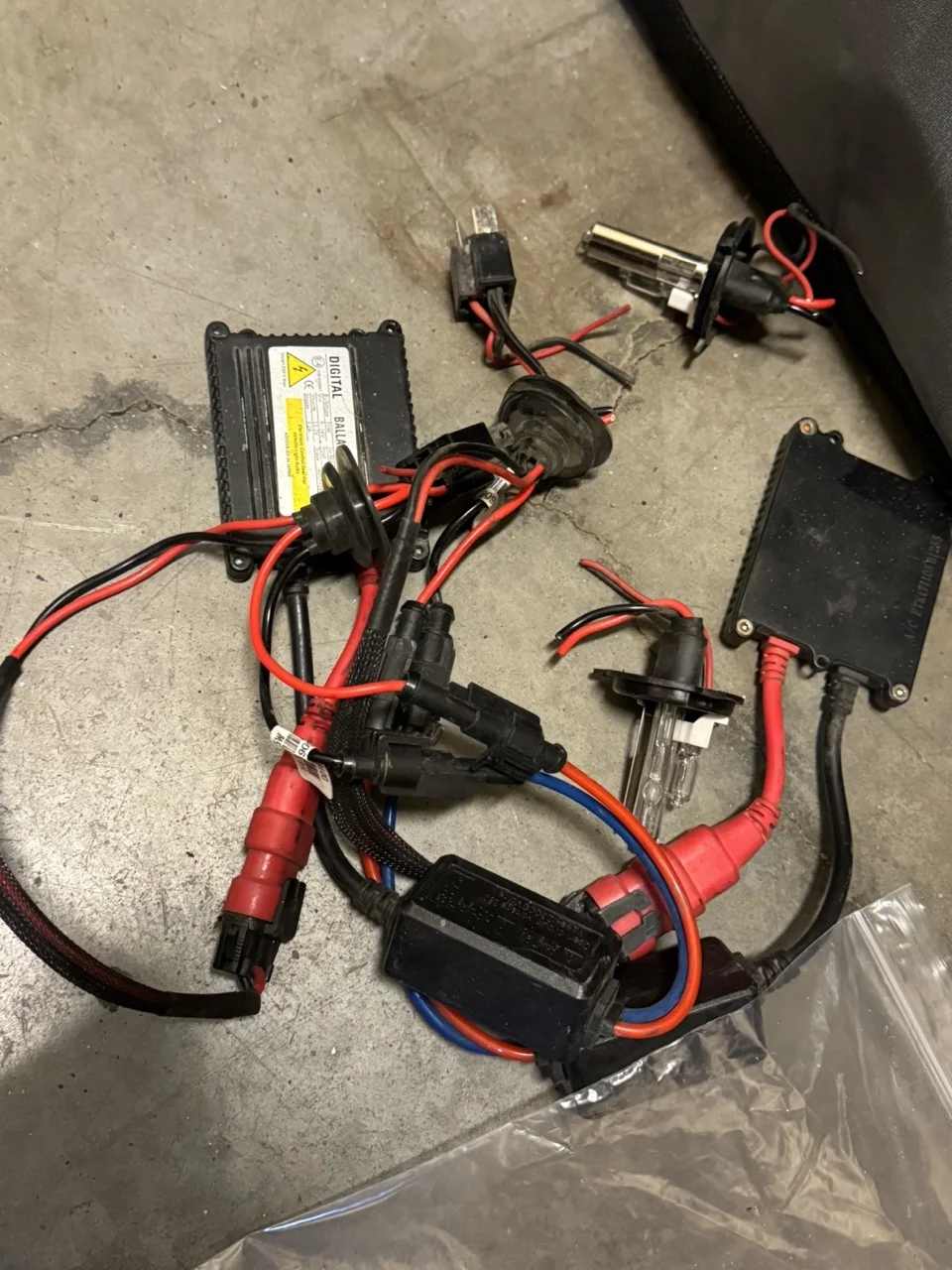

My Hilux came with a previously installed aftermarket HID kit that gave me tons of problems, and was not bright nor melted snow off the lenses (HID doesnt get hot enough to heat the lenses). It had to go.
Out with the old:

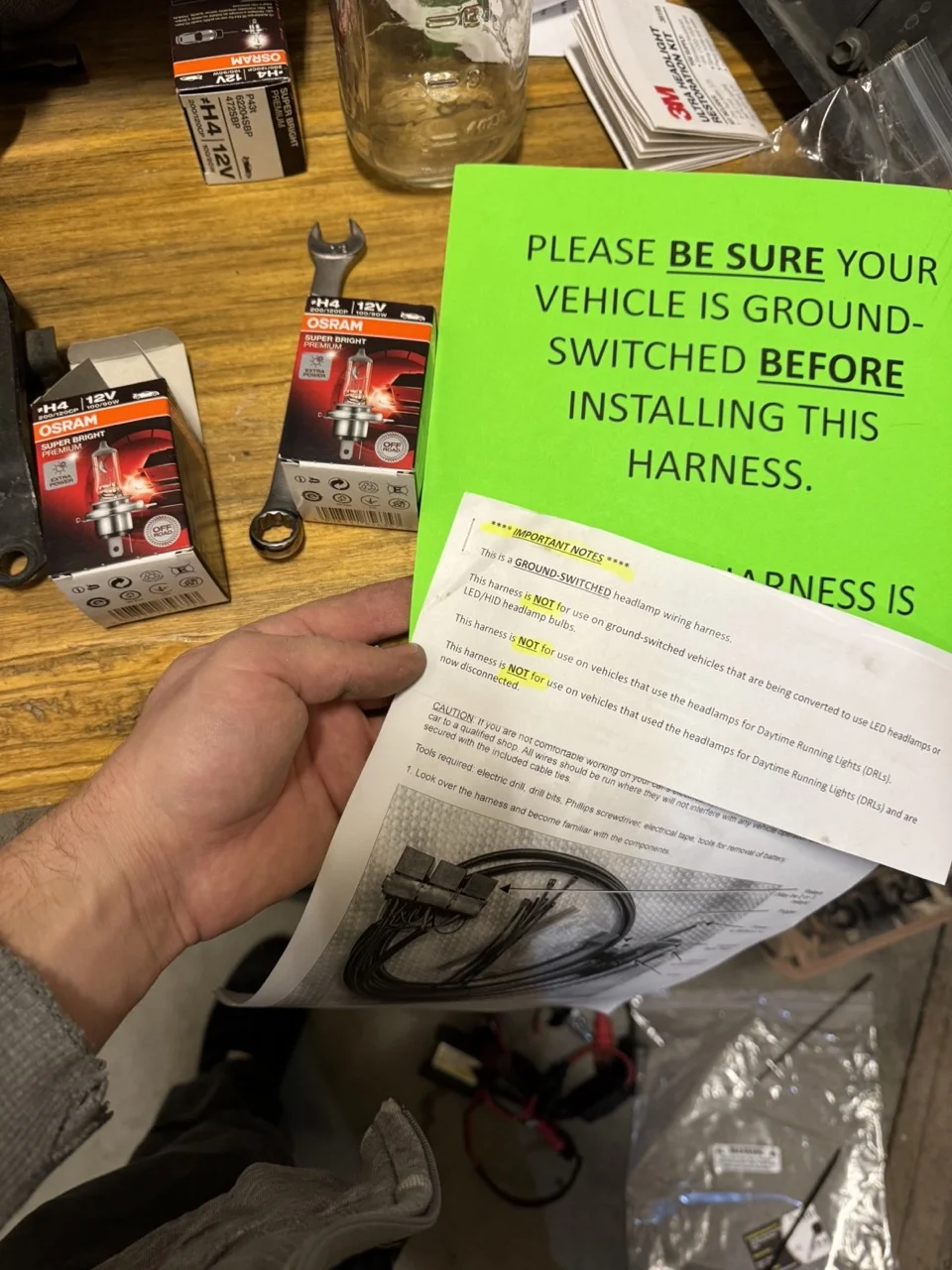

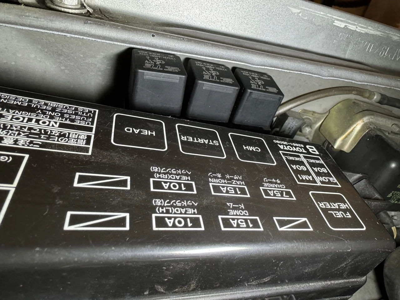

I went with a Headlight Services LLC hand made harness, these are made in the USA right here in Colorado, and feature really high quality components. link to his products: GroundSwitched - https://headlightservices.com/GroundSwitched.html
This harness was plug and play, and fit perfectly in the Hilux.
Relays fit nicely behind the factory fuse box.

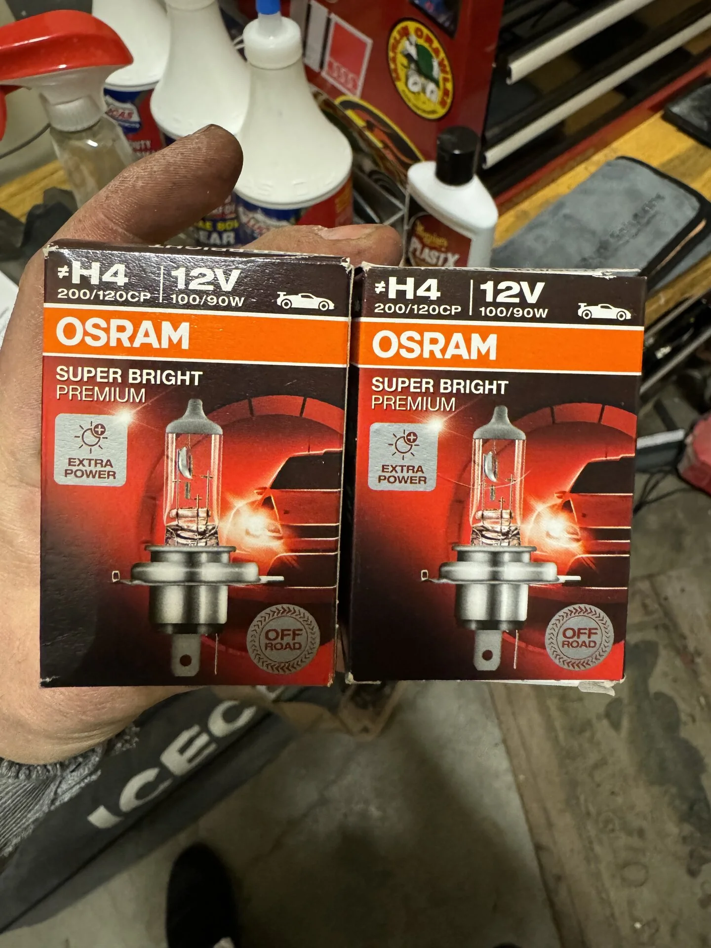

for bulbs, went with OSRAM H4 Premium SuperBrights from Germany. These bulbs are affordable, and BRIGHT. got em' from Powerbulbs.com and were 9 bucks each. OSRAM Super Bright Premium H4 Headlight Bulb | PowerBulbs UK - https://www.powerbulbs.com/product/osram-super-bright-premium-h4

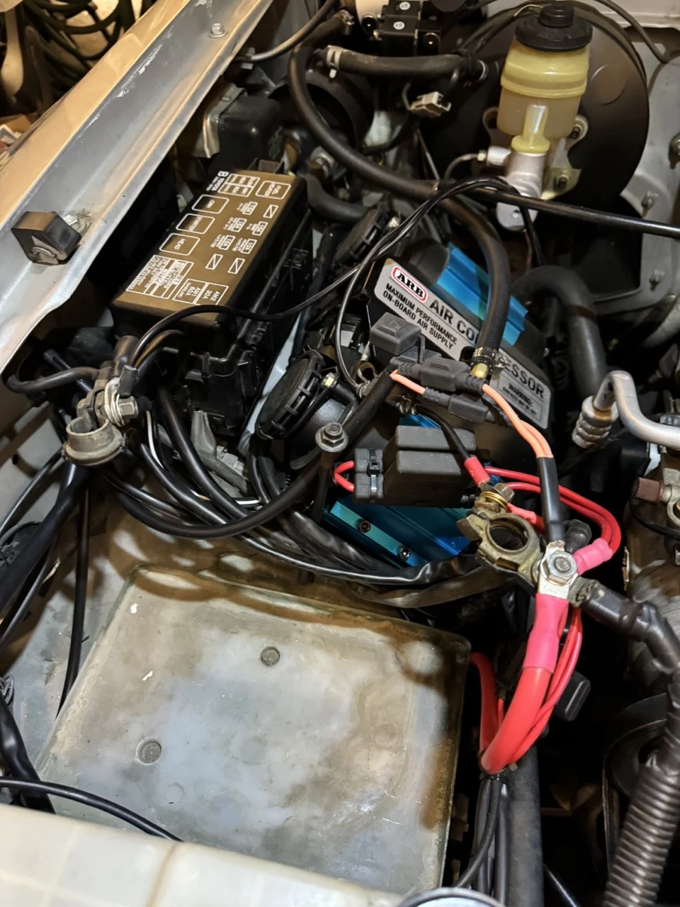

New harness plugs in and fits perfectly behind the factory dual batteries
