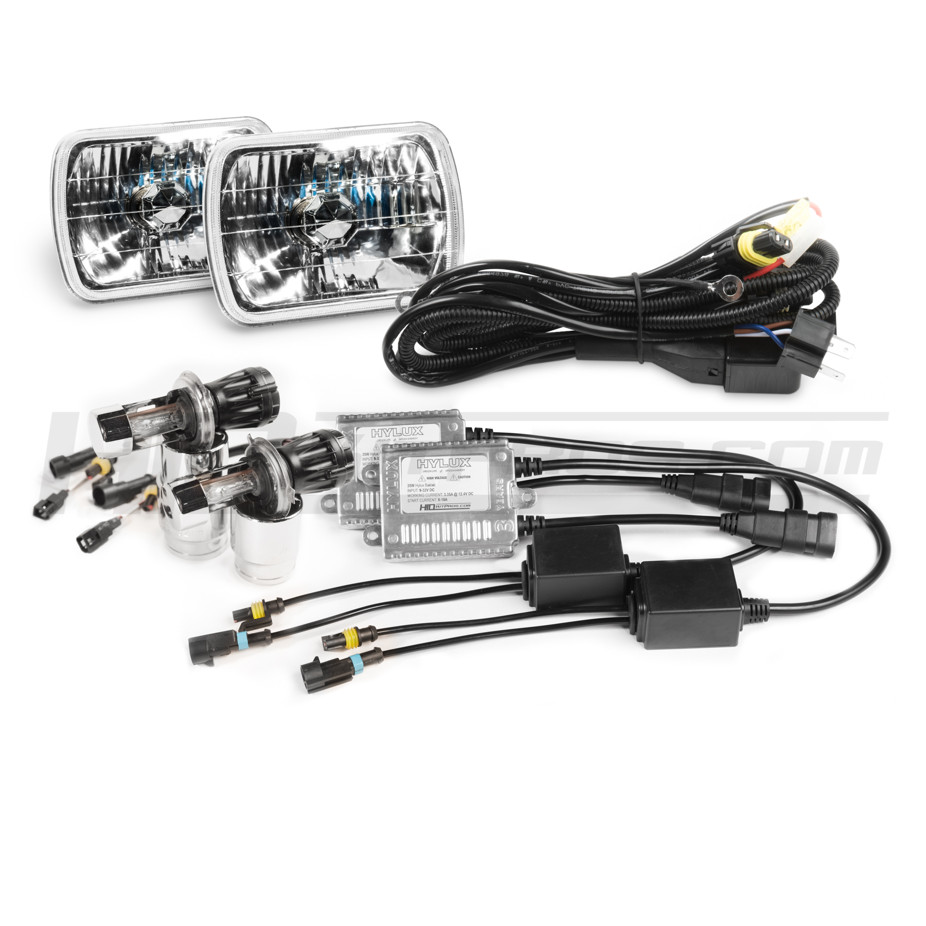

Last year, I upgraded the headlights and harness in my '06 100 with H.I.D. KIT PROS (hidkitpros.com) at Dugan's (ACC Garage) suggestion. It was a huge upgrade. They make a kit that works for the 5x7s for $175. I'm tempted. Anyone try this one?

Fine! I'll be the guinea pig... sort of.
I called HID Kit Pros about the kit and the guy said that since I'd looked at ^that^ kit a year ago, they have more options. Both are meant to look like traditional 5x7 headlights. The $400 version is a bit more retro I guess - probably upclose. The other is a $200 LED conversion - and does not require drivers, a harness, etc.
I bought the $200 LED conversion - BP7118. This has High and Low beams.
