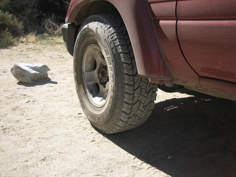

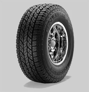

2) Yokahama Geolander AT- From Vendor website
Maddbaggins input to the FAQ:
Yokohama Geolander AT 285/75 r16 on black steel rims
Considerations
At the time I purchased it was a toss-up between BFG AT's and these. I went with these because the manager at Discount (a family friend) has them and recomended.
Performance
I have very little road noise that I can hear over my exhaust
I get excellent traction in the dry rocks and dirt of Southern AZ and have very little trouble with wet surfaces either. I run 40psi street and about 16-18psi offroad.
I wheel on a lot of nasty rocks down here and have lost a few chunks of rubber here and there. I have about 16k miles on them.
They are only a 2-ply sidewall however as compared with the BFG's 3-ply.
Overall I am happy with them and would recomend them.​

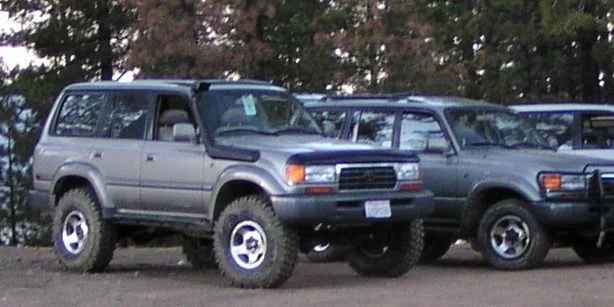

Alia176 input to the FAQ:
Yokohama Geolander At II+ tires 315 75 16 (34.7")
1996 FZJ80 850J/863 Lift
Considerations for Purchase:
The purpose of these tires were to get me to the trail head in peace and quiet with excellent hwy manners. Trail head from my house is a min 1,000 miles (Chicago). They have to handle snow/ice/slick rock and little mud; basically, Jack of all trades but master of none sort of thing.
Performance:
These are excellent tires and wear nicely on the 80. I do rotate the tires religously and keep the front end aligned. I have about 30,000 miles on them and they're wearing great (currently at 14/32" out of 19/32"). Hwy noise is very minimal and traction for off roading is superb. I don't play in deep mud but have run trails in AZ,UT and CO. Just did the Crown King trail in AZ and noticed minor chunking all over. This trail has sharp rocks on it but I didn't have a flat tire and that was a large concern of mine due to the thinner sidewall. Traction in Moab is superb, even when wet. The attached pictures are of the tires doing a short climb while being wet.
Normal air pressure is 34/38 and I bump them up to about 38/42 when heavily laden. Depending on the trail, the air pressure can be anywhere from 18-25 psi.
Recommend:
Yes but do keep in mind:
- max load at 35 psi and 2535 pounds (may not be enough for some folks)
- nice side lugs for light muddy trails but not for super deep, gooey stuff
- center lugs great for wet traction and quiet operation
