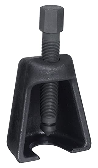

I both the OTC 7315A to do the tie rod ends (it does not damage the rubber booths), and Steering Stabilizer.
The 8150 is huge and I got it to be able to separate the Pitman Arm from the Steering box.
I have this one and it's always worked on the tied rods and steering stabilizer. I much prefer using one of these over a pickle fork.
