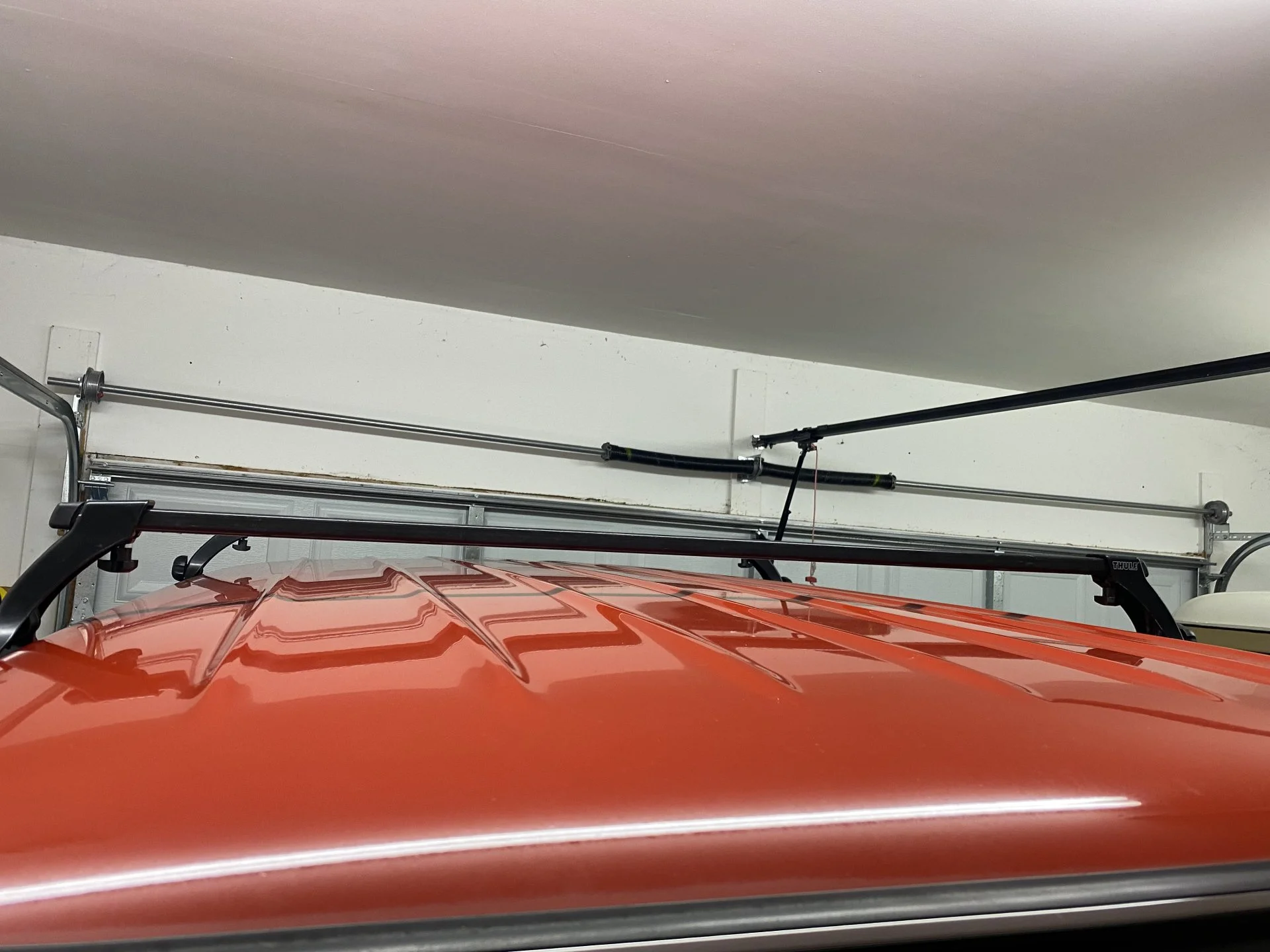

So I took a chance and bought a set of pre owned Thule mounting towers model # 300/1050 and they will work on a 60 series. I found the bars used as well. I set everything up today and they mounted up perfectly on my rig. I wanted to share the information in case anyone else is looking for some mounting towers/ rails but unsure of the model numbers.
