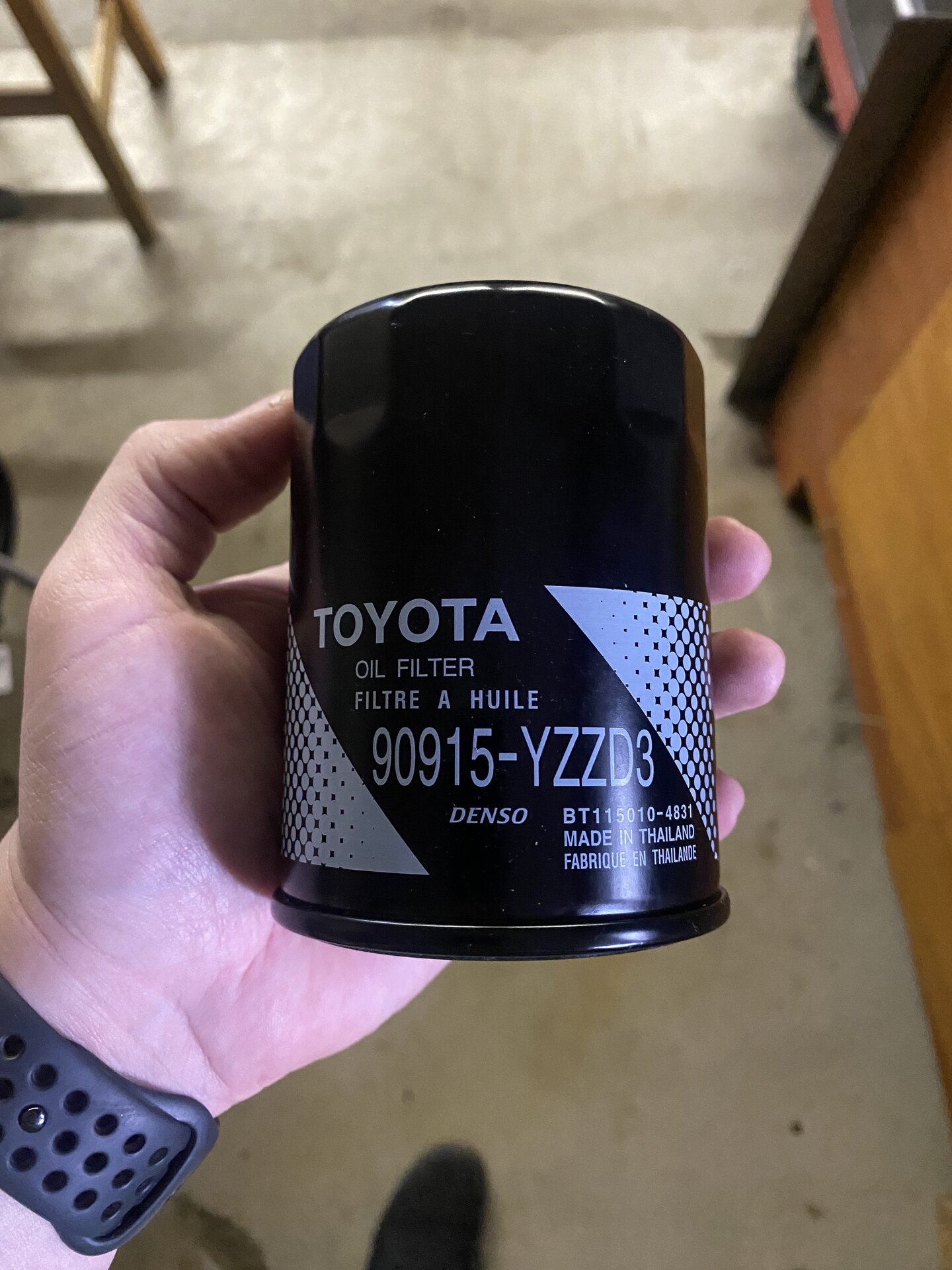

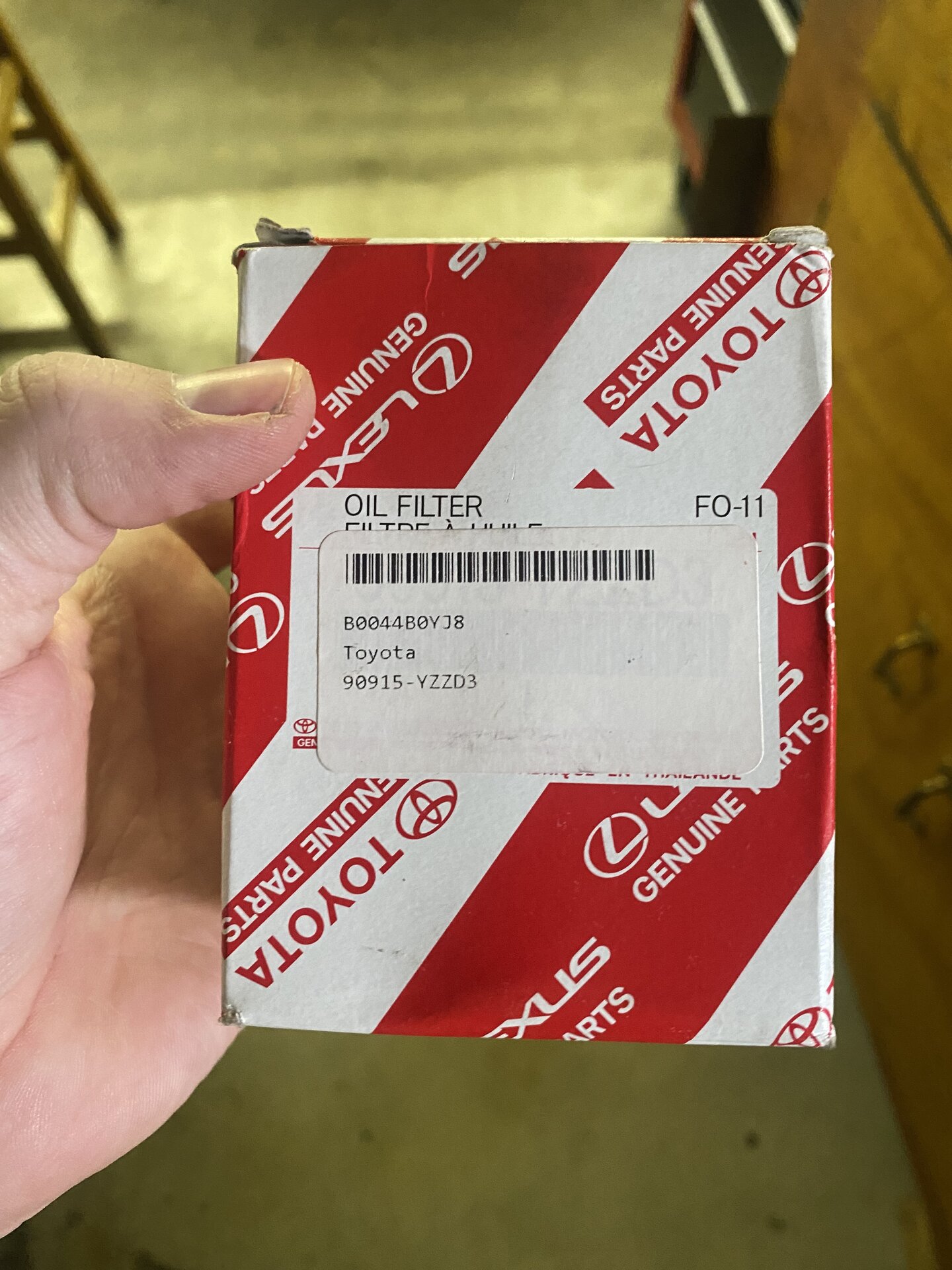

So I was doing an oil change on my 80 today. Everything was going great till I needed to remove the oil filter. I can not get it off. I've been trying to use the rubber strap tool that wraps around it and then you pull it tight and turn it. But there's not much room wether you go above or below. But it put a dent in the oil filter and I just can't get it loose. So I figured I'm done trying that, and just need the socket already. I went to O'reillys to look for one and the one they had for Toyota/Lexus but its 65mm x 15 point. But it was too big for the oil filter. I google the SST from the FSM which is SST 09228−44011, and it says it's 94mm x 15 point. So it seems that is even bigger than the one from the store. I just want to make sure I'm getting the right tool and not wasting money. Below are a couple pictures of the oil filter I use.

The large filter IIRC takes a 15 flute 92/93mm filter wrench IIRC
Smaller filter may be 14 flute ~ 73-74mm??

80mm way too big. This 74-76mm is almost perfect fit but just won’t bite. Maybe if you tapped it on. I guess I only used the largest of this 4 pack of sockets when the big filters were readily available.
Take a looks at 14 vs 15 flute/flat. Just counted the filter and wrench and noticed the difference. Filter is 14. Wrench I have is 15

The large filter IIRC takes a ?15 flute 92/93mm filter wrench
