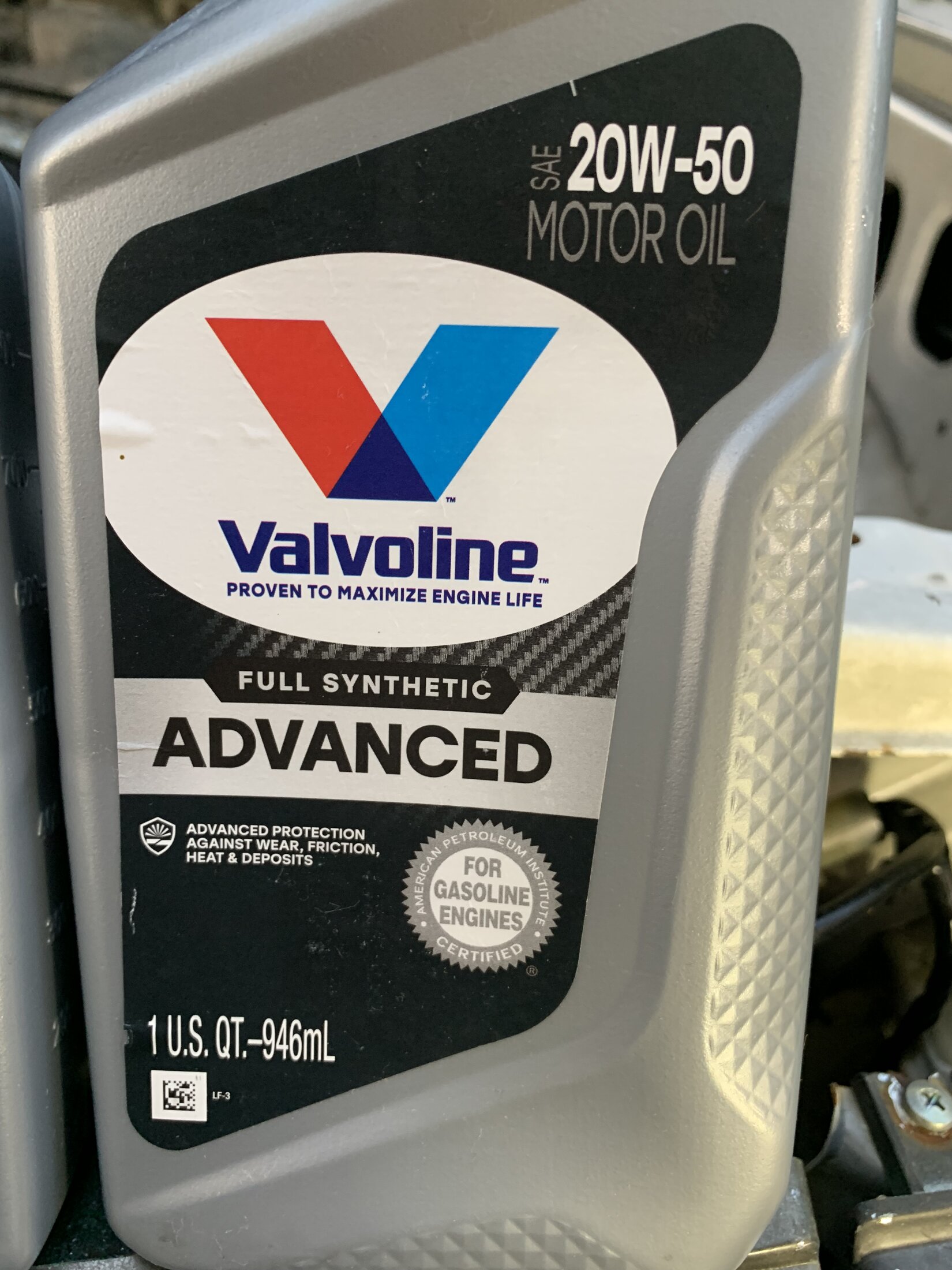

Below is the Highest Quality Level Motor Oil for a 1961-1997 F-Series Gasoline Engine currently available on the market today ....
- 20W-50 has this highest protection level on your owners manual's Viscosity Chart , Based on the Temperature Rating Scale ( you of-course adjust accordingly )
- The Full Synthetic Motor Oil Rocket Science is real and now common place , TOYOTA now spec's Full Synthetic oil in ALL of its current , & last 8+ years vesical line up .....

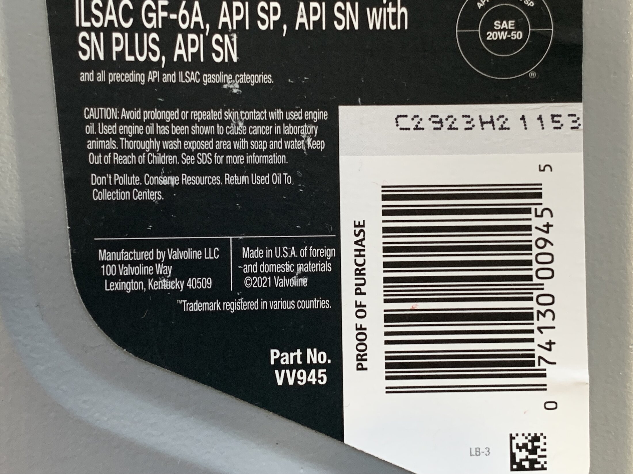

- this is the Only API ( American Petroleum Institute ) Certified 20W-50 Motor Oil offered in the North American Destination Market
- the current API rating coverage is
SP / ILSAC GF-6A, API SP, API SN with SN Plus, API SN
- the Zinc content correctly protects & meets the requirements of a solid lifter , solid tappets, in-block Camshaft , Timing Gears , & rotation-type push-rods inline 6 Cylinder Engine , but Not in a excessively harmful way ...
- i have personally been using this in All my personal Toyota family fleet for more then a decade , ( in the correct viscosity weight based on the engine requirements of that said TOYOTA engine )
- if there is another motor oil out there that meets or exceeds Valvoline Advanced Full Synthetic overall specifications & engine protection as it relates to a Gasoline 1961-1990 F- Series Engine ? please share here in this important discussion

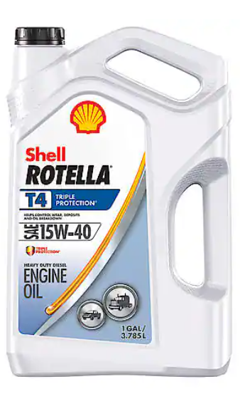

Just run an oil that says it's for older engines ... The T4 Rotella is good. M1 15w50 Lucas Diesel
I think the Rotella 10W-30 I purchased has an adequate amount of Zinc
I know for a fact the Rotella 15W-40 has the proper amount of zinc required, but cant confirm the 10W-30 Zinc content for some reason.

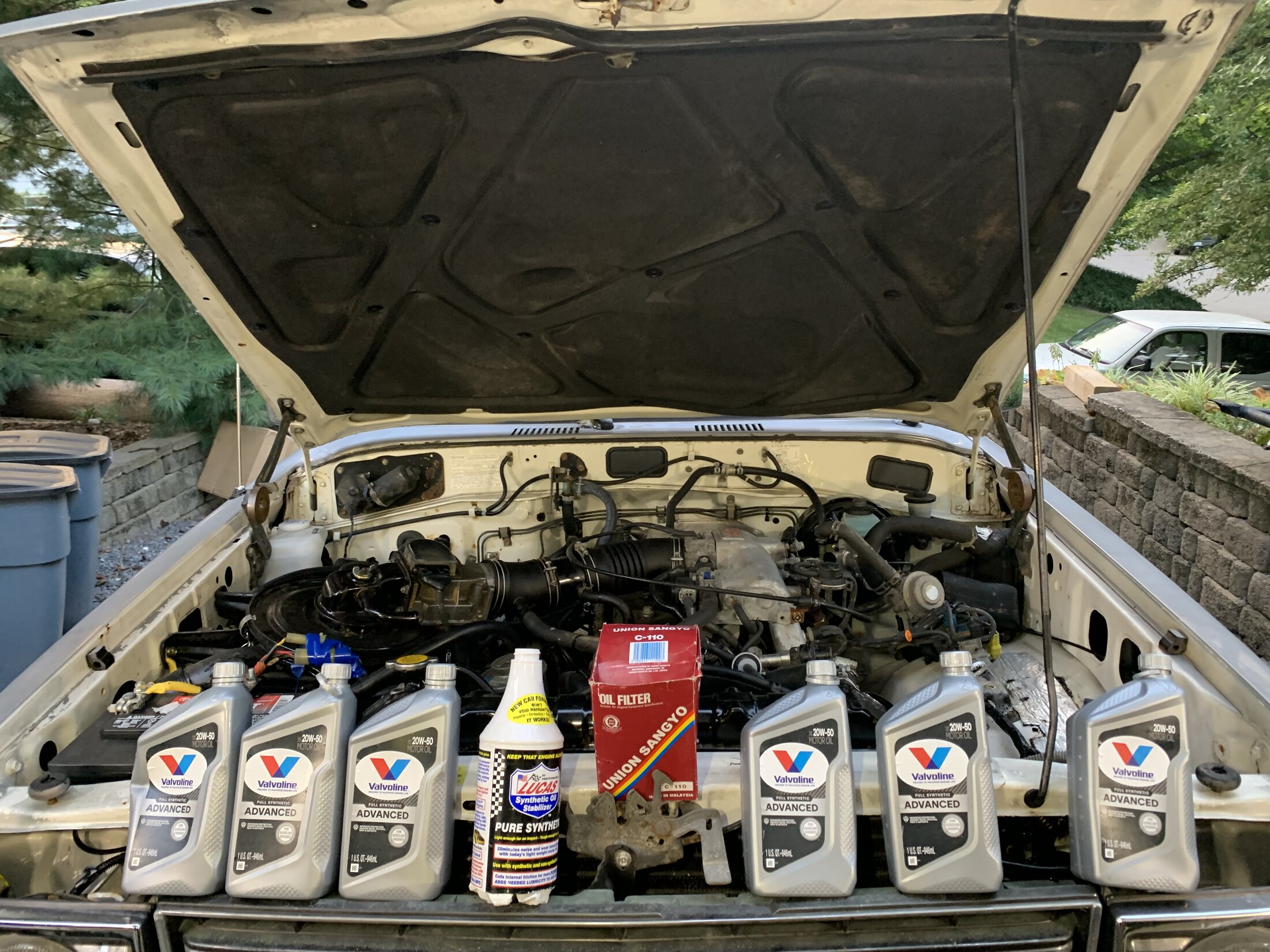

Regardless the first lube job in 15 years im going to use Rotella 10W-30 + Marvel Mystery Oil + Toyota Filter
My goal is literally to get her fired up once or twice, not much driving beyond a few feet may accour at the moment so I think its all good.
