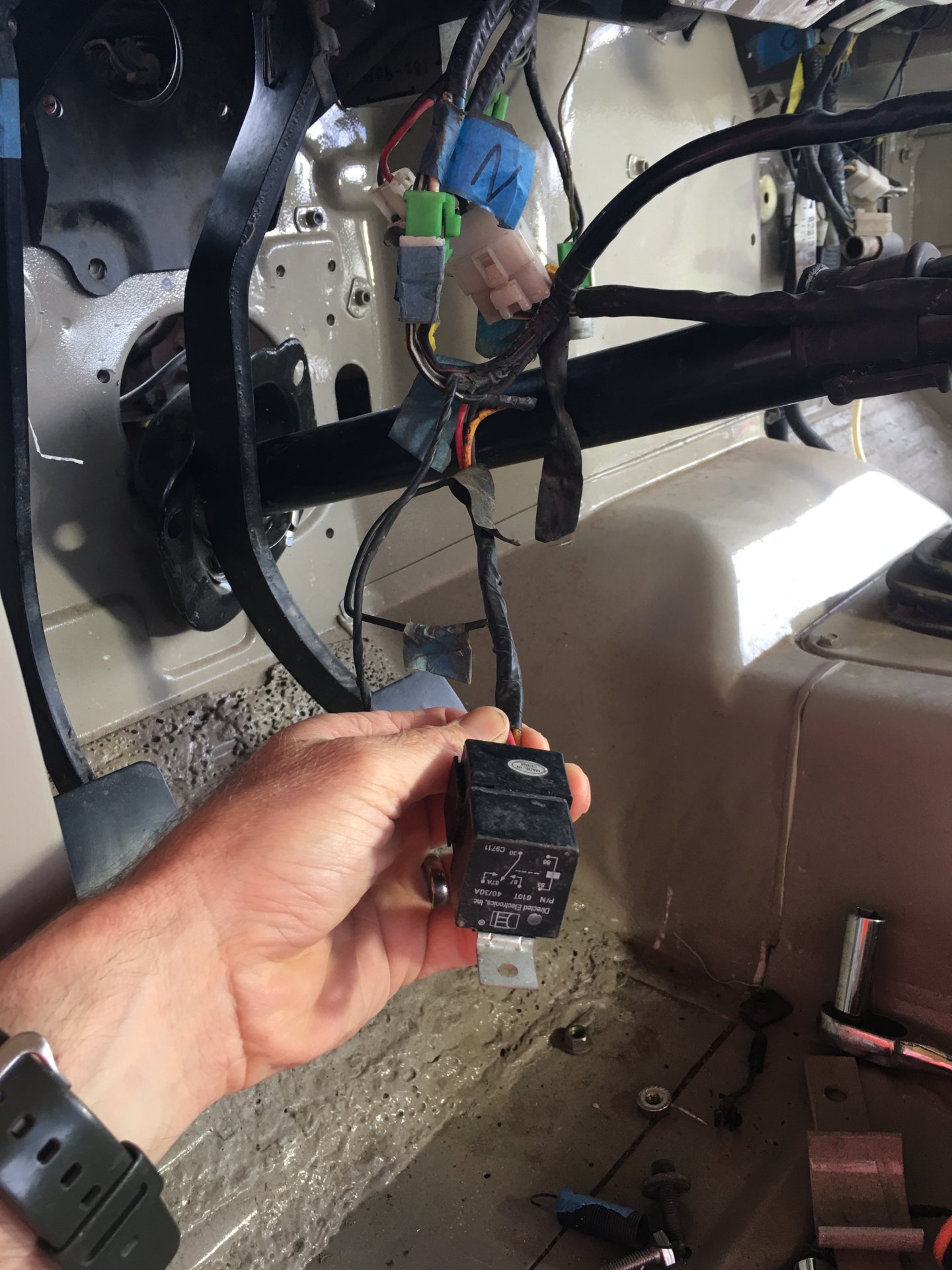

Where does this relay attach to firewall? Feb 79’.
I'm thinking that is not a stock item.
I don't recall any relays like that on any of my 40's
interesting. thank you. That explains why it does not seem to have a place. must be with the alarm? tied into the column wires.
Looks like it is a multipurpose relay that could have been used for a host of things. I wish I could help more other than positive ID that it’s aftermarket.
didn’t even notice 😂
There are a number of ambiguous small pieces like this intermixed with the electrical parts. This one didn’t strike me as all that different. It will get deleted.
The wires don't look stock either but follow them to their end just in case.
The black/white wire goes to the starter from the ignition switch. Maybe some kind of demobilizer?

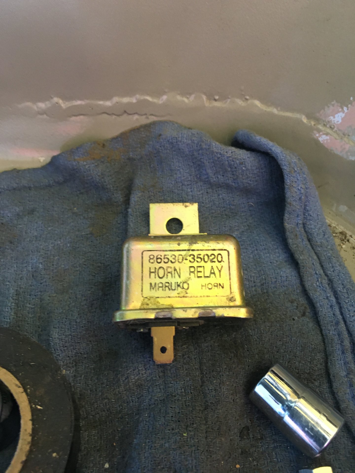

Here is the real thing :)
Searching for a home for these too. there is a three slot free on the drivers side fire wall. The other one (identical to this) mounted just above the brake pedal near brake switch. Also looking for a home for my horn relay. Wire to wire connections are more or less intuitive but these relays not so much
