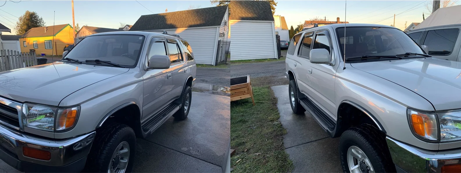

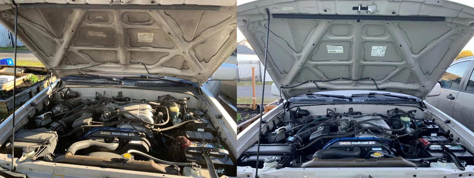

Ok so here's a few pictures. Got it home and haven't moved it yet. Just checking things out and cleaning. Its Friday today. Waking up tomorrow and starting the steering bushing replacement.
