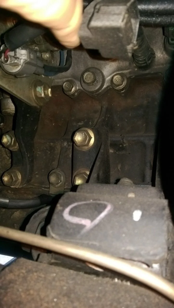

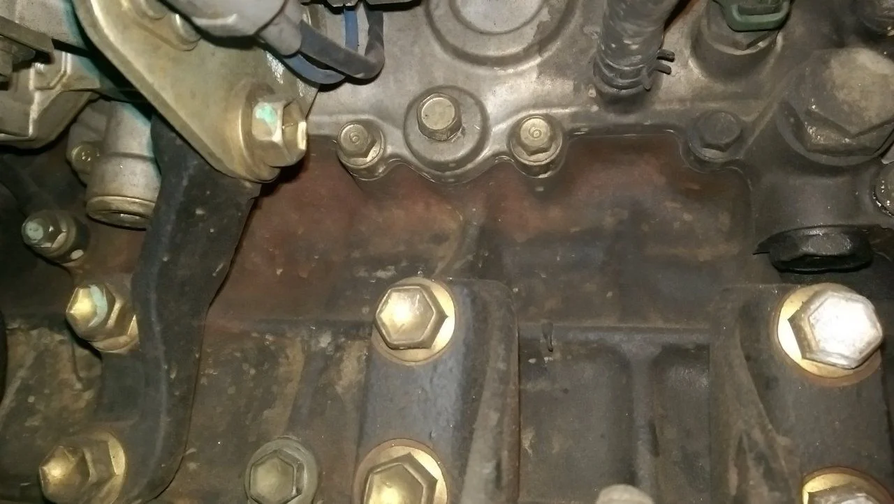

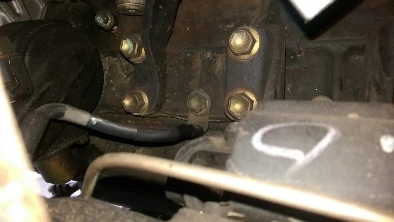

So... After all of the info you guys posted. I don't think I have a drain...
Here are some pictures of the area it is supposed to be. Am i missing it or did a PO put a bolt in instead of a drain? Could I not have on on this engine?

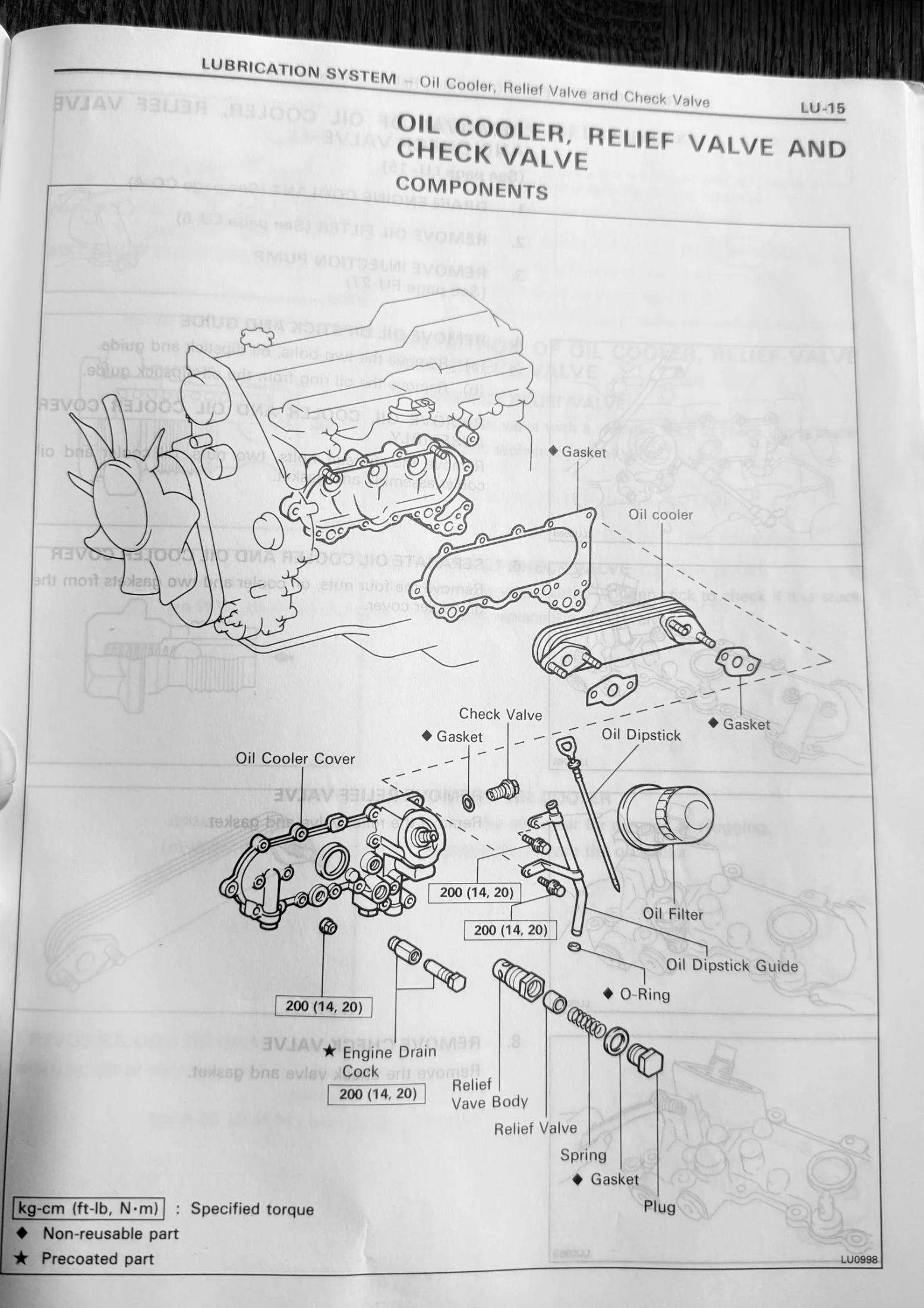

Do you have a 1HZ FSM? It is clearly shown in the Lubrication section in a diagram on page LU15. If you dont have a manual,there is the page you want in IanB's link.
LU17 has an even better diagram showing the bolt inserted into the oil cooler
From memory ,the point at which the drain is , is the lowest point of the coolant system in the engine block.Obviously it is in the oil cooler

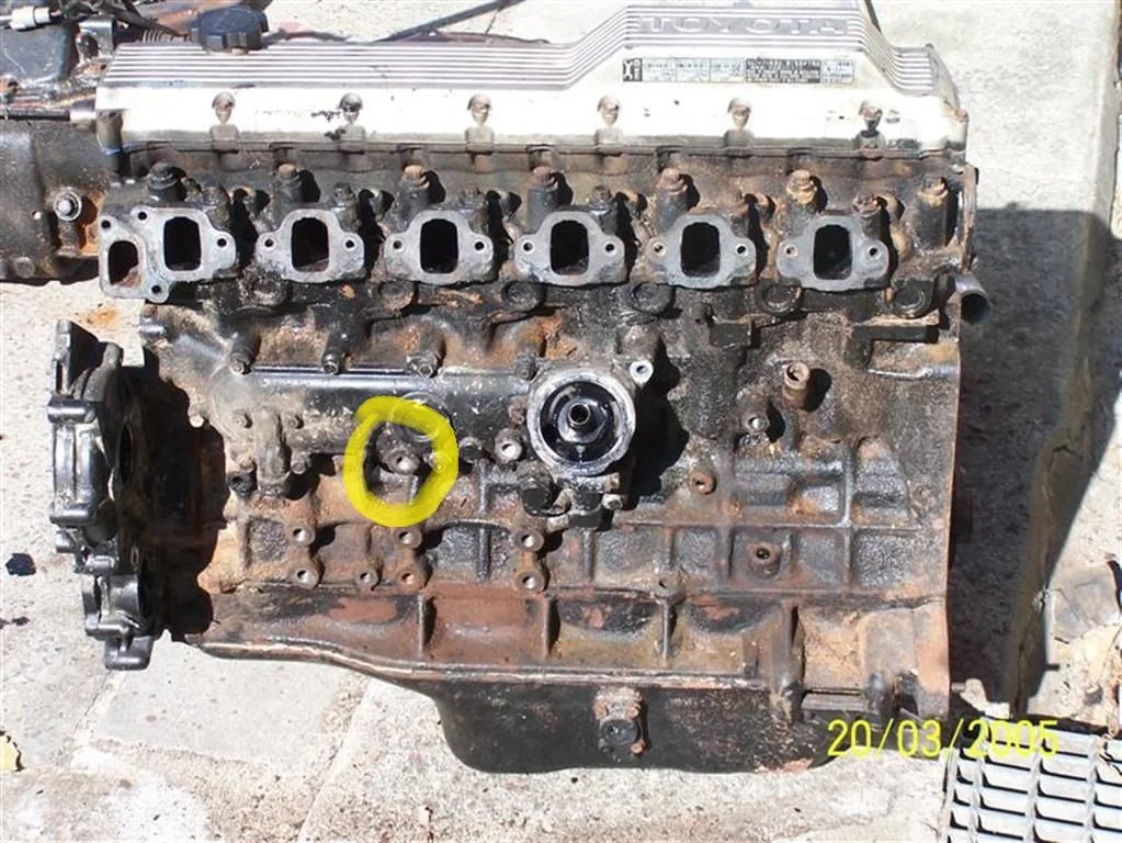

Pictured circled in yellow from an engine I rebuilt a few years back.
After studying your pics ,it does look like someone replaced the brass fitting with a bolt

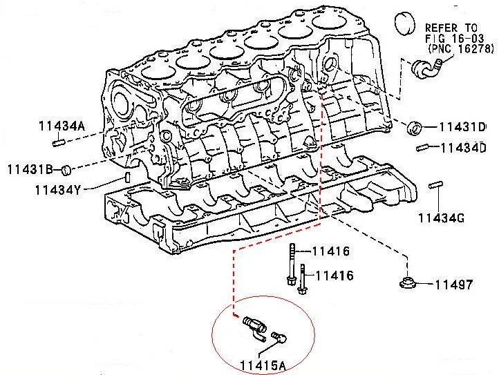

Maybe that introduction date changed with the market because here's a General-Market image from the EPC showing the block-location for the drain cock for a 1HZ occuring from January 1998:
Looks like it's just down and forward of the heater feed elbow..
I could be wrong, but I don't think any of Kraig's photos look quite at this area.
I should have known not to rely on other Internet posts. ... (Much better to refer to Toyota's own information.)

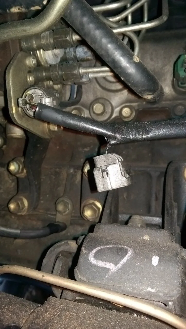

The one in Marble's diagram appears to be where the Australian 1HZ had a water temp sensor for the glow system on the older models circa 93.
I remember removing it when I stripped the engine down for a rebuild but the sensor was non functioning. I might have it somewhere in my nut and bolt bucket.
So I checked the other location and it seems that I have the sensor on the rear location (my engine was set for superglow) and that bolt on the front. Looks like I need to source a drain to make sure I can clean the block properly.

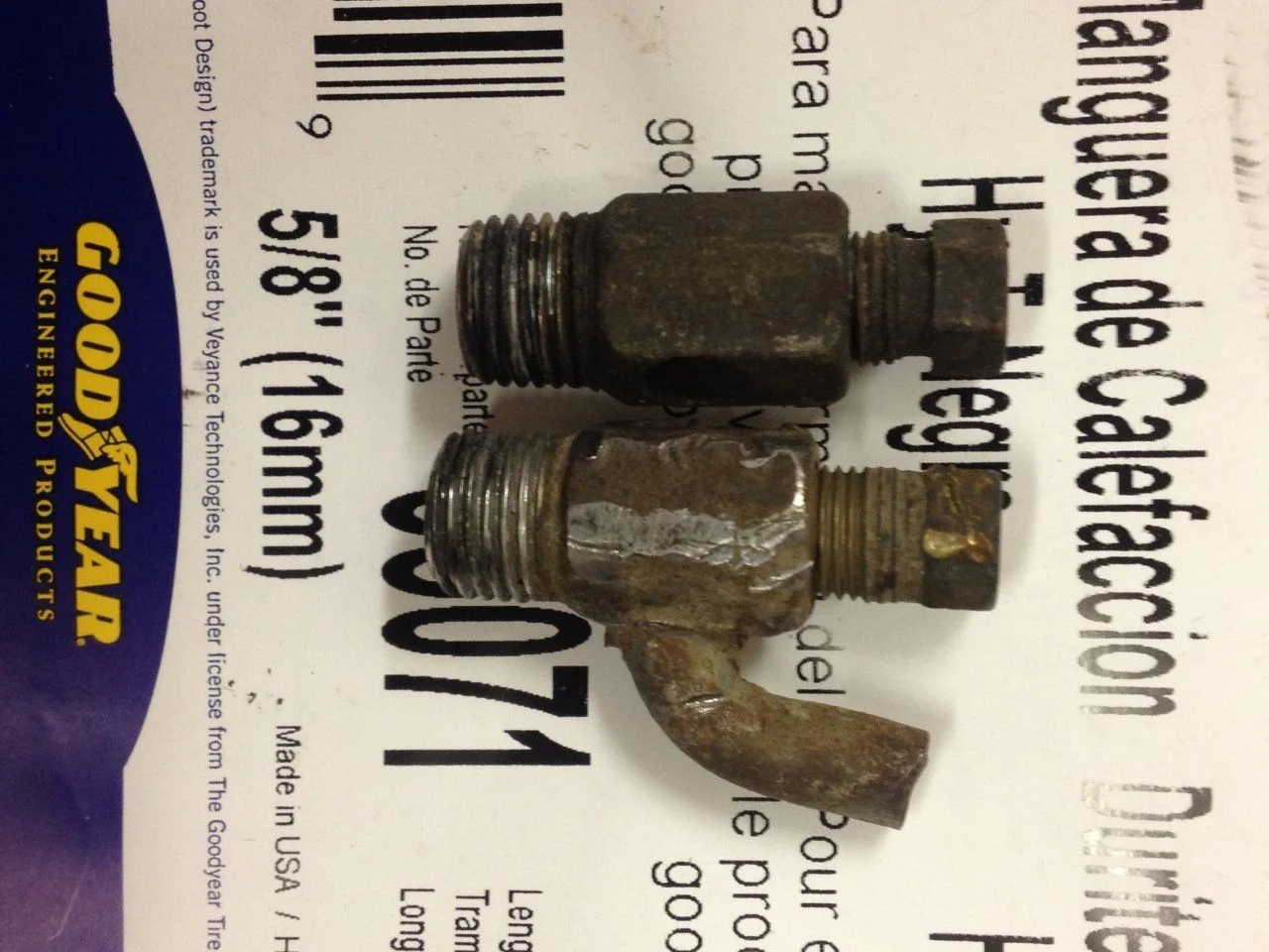

I realize that this is an older post. I got here looking for block heater options. I'm considering putting an inline circulating heater on my 1Hz. That would entail connecting it from the "Engine Drain Cock" to the heater hose before the cab heat control valve. Anyway, I was trying to figure out the specs (threads) for the drain. Then I went to my service manual, and I still wasn't able to find the information I was looking for. However, I found this and thought it might be relevant to the above discussion. Maybe it will help someone else; if not, feel free to ignore this post.
