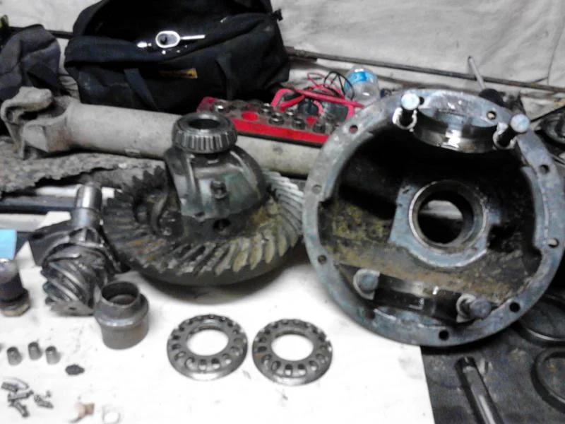

The only thing that was re-usable in this picture were the 12 ring gear bolts. Everything else went on the scrap pile: mashed carrier, distorted housing, trashed R&P, bearings....

WOW! Only the bolts were reusable. Chris, maybe you can add the phrase
