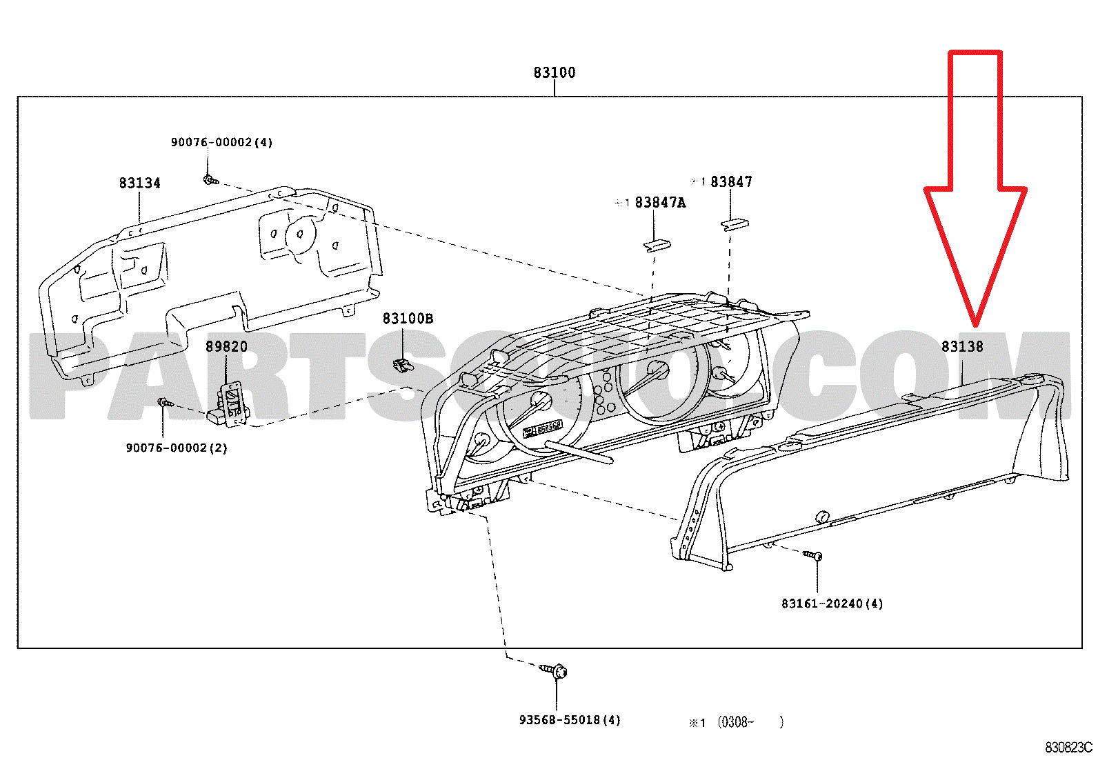

I joke about the instrument panel cause one of my motors has a tick that is irritatingly loud. I accidently popped the needles off 4 of the gauges, it's never been the same.
I seem to be waiting until the combo meter prices reach stratosphere prices before I buy a new one. Yet there's a booster assembly sitting in a box. Yes, what's the world coming to.
