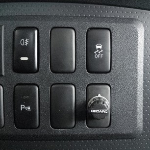

Here's where I mounted the Redarc button on my 2010 LX. All of the slots were used, so I removed the button that disables the automatic rear hatch. I never saw any need to do that. Just in case though, I zip tied the switch so it wouldn't accidentally enable and stashed the switch just behind the panel within easy reach.
I like this location because in an emergency situation I can easily hit it with the back of my right hand without having to search for the button. I even practiced a few times and it is a very natural action.
Hmm. Just noticed that gap in my panels. I'd better go check that out. :oops:
