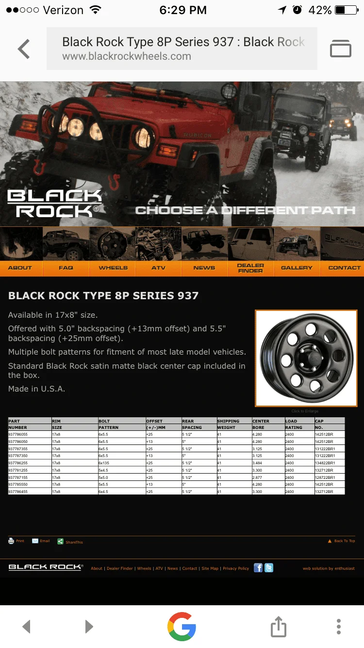

Which one of these would work without any issues, I'm planning on a 3 inch OME lift on a 1991 HDJ81
What width tire are you planning on using? The +13mm offset would be your best bet but depending on the tire you use you might need wheel spacers. Factory backspacing is 4.5". Depending on your setup will depend on if you experience rubbing on not.

Those rims will fit fine but a bit of negative offset will gain clearance for wider tyres in the wheel well.
