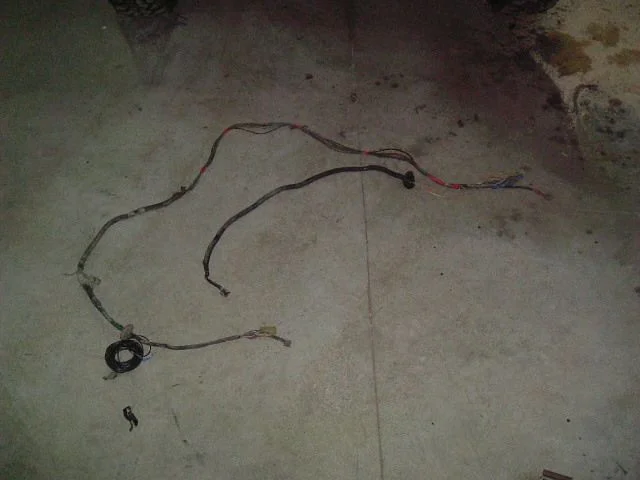

I also spliced the rear harness to route it all inside except for the fuel gauge. I will have to lengthen it and move it up into the C pillar, above the doors then down the LHS when I rework the electricals. For now it will stay on the floor under the carpet :D
