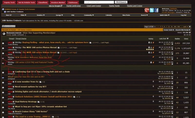

there have been approximately 1.1M threads about this or something extremely similar...I am not usually one to suggest the "search" function....but for this I would definitely recommend it.

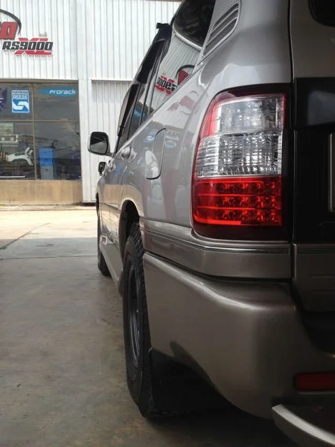

These pics may help you in your quest. godspeed.
I searched and checked the faq but was not able to find the answer to this question(s). Its more specific than I think you realize. Whats the max tire and offset combo on a 18" wheel w/o rubbing and w/o a lift? Its just not clear after reading a bunch of threads what the answer is. Thanks for the help.
