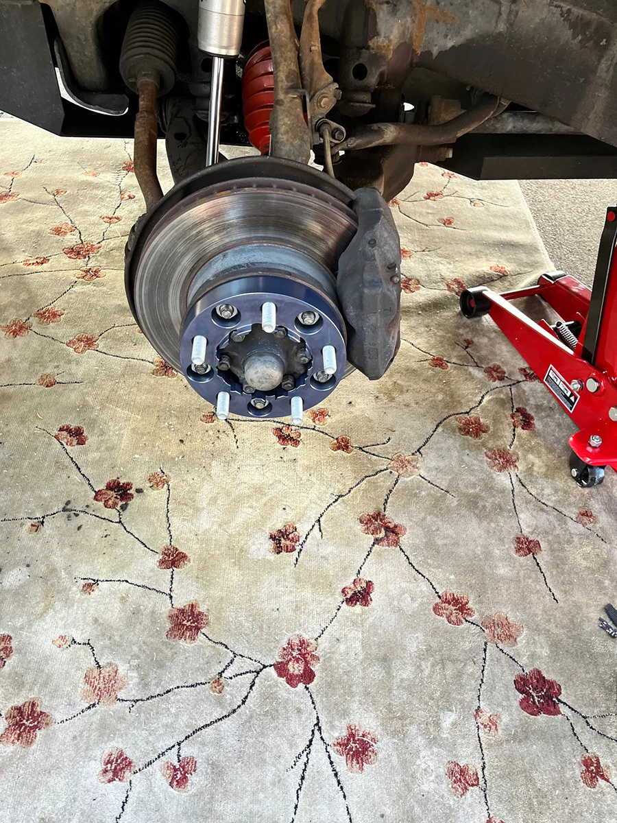

2005 lx470. I've been running these 1.5" spacers for 3 years with no problem. I now have a kid and am going back through all my sketchy decisions and noticed the nut threads about 90% of the way on (3/4 of a turn until flush). Is this a death trap? nut is 3/4" and stud is 1/2" so i got almost 1.5x of grab on them. I know the overall vibe of spacers is not great to begin with but want to run these until i get real offset rims.

I would be happy with 14mm of thread engagement for a 14mm-1.5 stud. So 14/1.5mm=9.3 full turns of the nut.
I just reinstalled with 95ft lbs (spec but trusting Chinese manual) and they all were 9 turns before torquing. So about 9.5 each

Yeah these are off brand amazon ones. I think to be totally proper i would get SpiderTrax or maybe longer lug bolts. it could be the 1.5" vs your 1.25" spacer. I have 9.5 turns on each of the nuts and them all being fine for over 3 years is probably ok?
