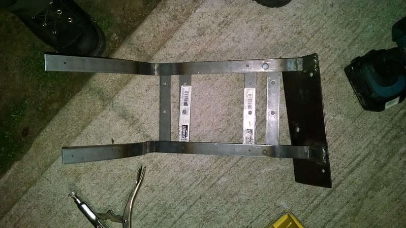

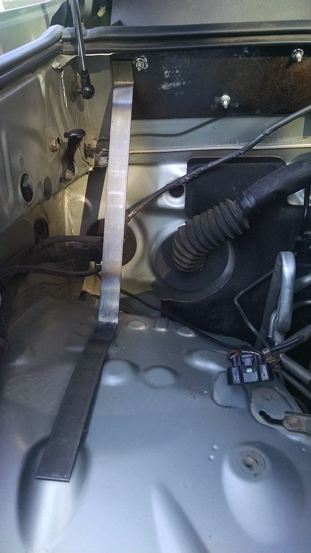

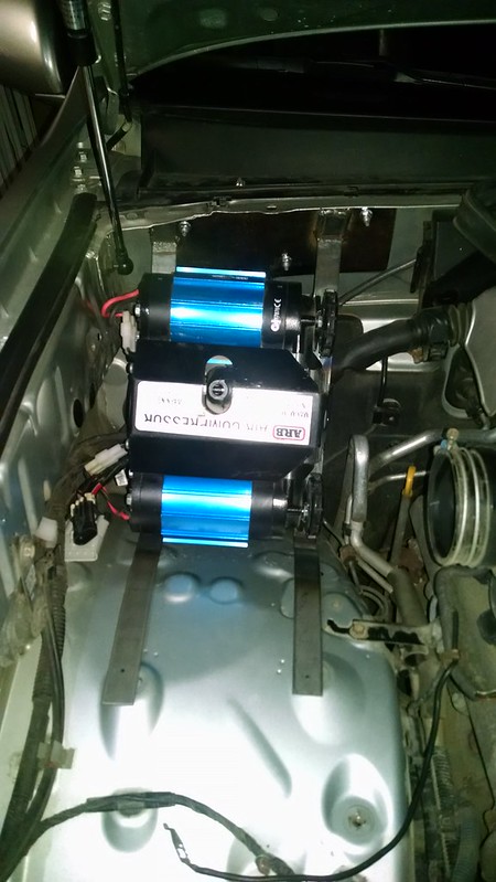

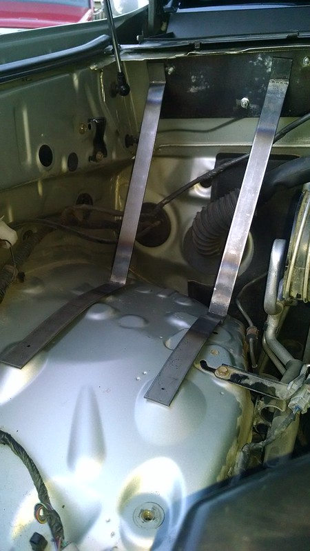

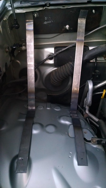

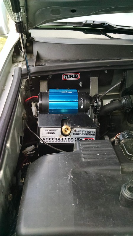

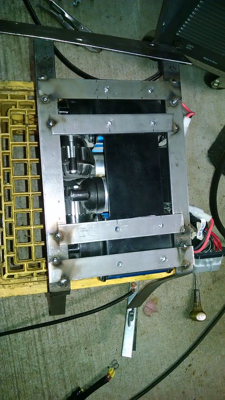

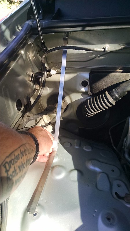

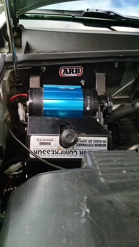

so today im gonna try and fab up a mount for my ARB CKMTA12 under the hood. im gonna try to put it between the fire wall and the back of the air box. my hope is to get it to sit low enough that i can also have that engine cover still fit. i plan on using the 3 studs on the fire wall(2 that are there for the plastic cover, and the other center/lower stud is just supporting a wire) to be my top mounts for my bracket and then the other mounts will be bolted directly into the fender maybe using the air box mounting holes... im not sure if im gonna try to cut a hole in the cover for the air chuck port or if im gonna pipe the chuck port to another location that is already open. i have a CO2 tank but the last time i went to use it somebody(insert probably me) forgot to close the valve on the top of the bottle so it leaked out and when i went to go fill my tires after a short wheeling trip on sunday i was met with such an unpleasant surprise, especially when i had lowered my tires to 12psi... FML thankfully someone close by had a portable compressor that i was able to at least get all 4 tires up enough to drive home. but this left me with the increased urgency to get the ARB mounted up. so yeah that is my project for today...

Welp got a bracket all fabed up and mounted... I can't upload pics from my phone so it will have to wait until tomorrow for pics. But I'm supper happy with the outcome
so i gots it all painted and installed and wired up! works wonderfully! its only about 30 sec slower than my Co2 tank on filling a tire from zero to 40psi... and aft
er about two tires i start to get frost issues with the Co2 so i know this will be way faster than my Co2 tank... so that can get tossed into the back of the 4runner and sit and sit and sit lol.
ok ok on with the pictures cause i know thats all you care about!
