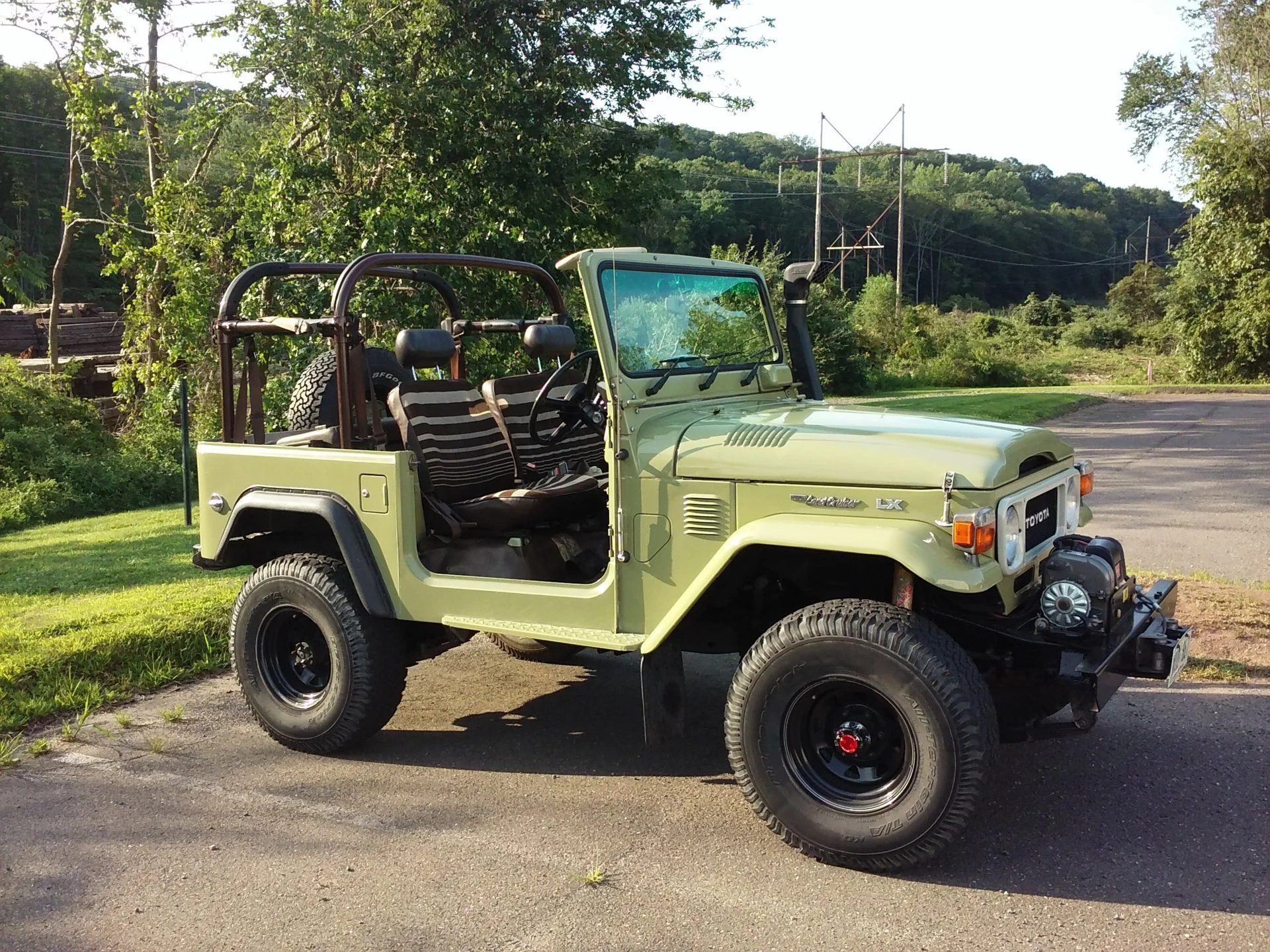

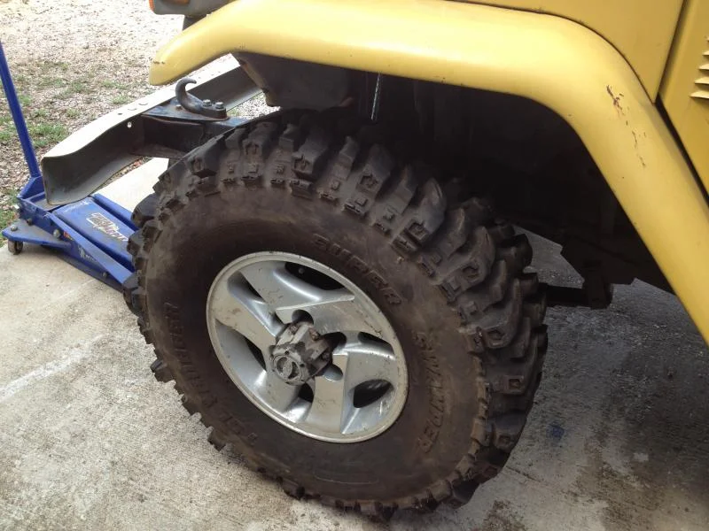

Anyone used 80 series alloys on a 40? 16x8, and I'm sure they'd require spacers.Trying to decide whether I like this look.:hhmm:
FJ Cruiser Steelies are 17 inch, the aluminum wheels are 16s.
They appear to fit from some of the pictures that I have pulled up

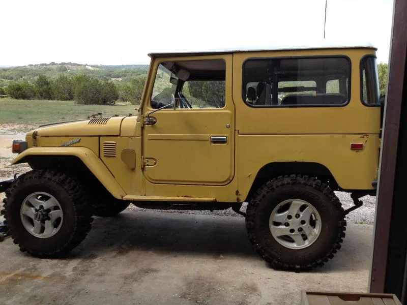

Just to make sure, because I really like the wheels in this photo, what exact vehicle are they from and are they 16" or 17"? I am guessing from the context that they are 16" from an FJ Cruiser but want to make sure. And the offset is 3.5"--correct? What size tires are in this photo? Lots of questions and very grateful for your answers. Don
Don, the wheels are the standard six spoke FJ Cruiser alloy. They're 16" wheels. You will need at least an inch of spacing between the wheel and hub (AKA a big spacer).

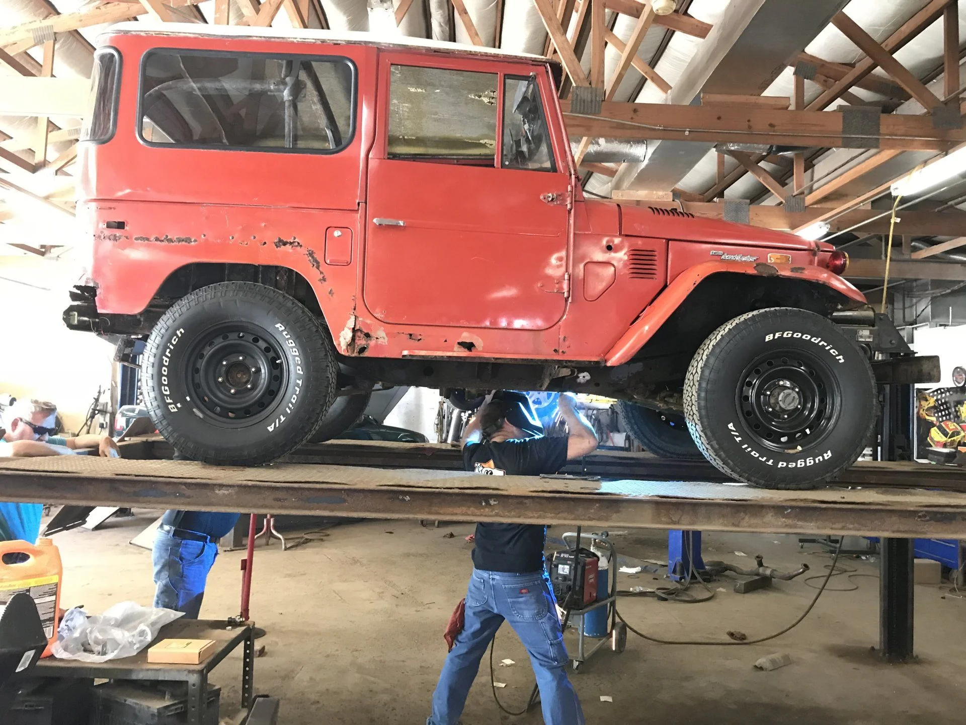

I am looking at installing 17" X 9” wheels on my 1970 axels with 34” X 11.5” tires with front and rear disk brakes (rear is a Man-A-Fre conversion). I have dry fit the wheels (wheels Only) on the front hub/rotors to see if the will clear and the 17” wheels moves the wheel lip beyond the tie rods with no spacer, so I assume no problem there.
These wheels have a 4.5 inch backspace with a really thick aluminum center hub. Because of the thick center hub the wheel face extends out about 1/4“ over the manual lockout hub bolts, no real issue there other than appearance (see pics). I am doing a frame off restoration so I can’t at this time tell if there is going to be any rubbing issues with the fenders or body. I have a 2” Old Man EMU spring lift kit installed and plan to install a 1” body lift. I have attached a few pictures if that helps, any advice will be appreciated.

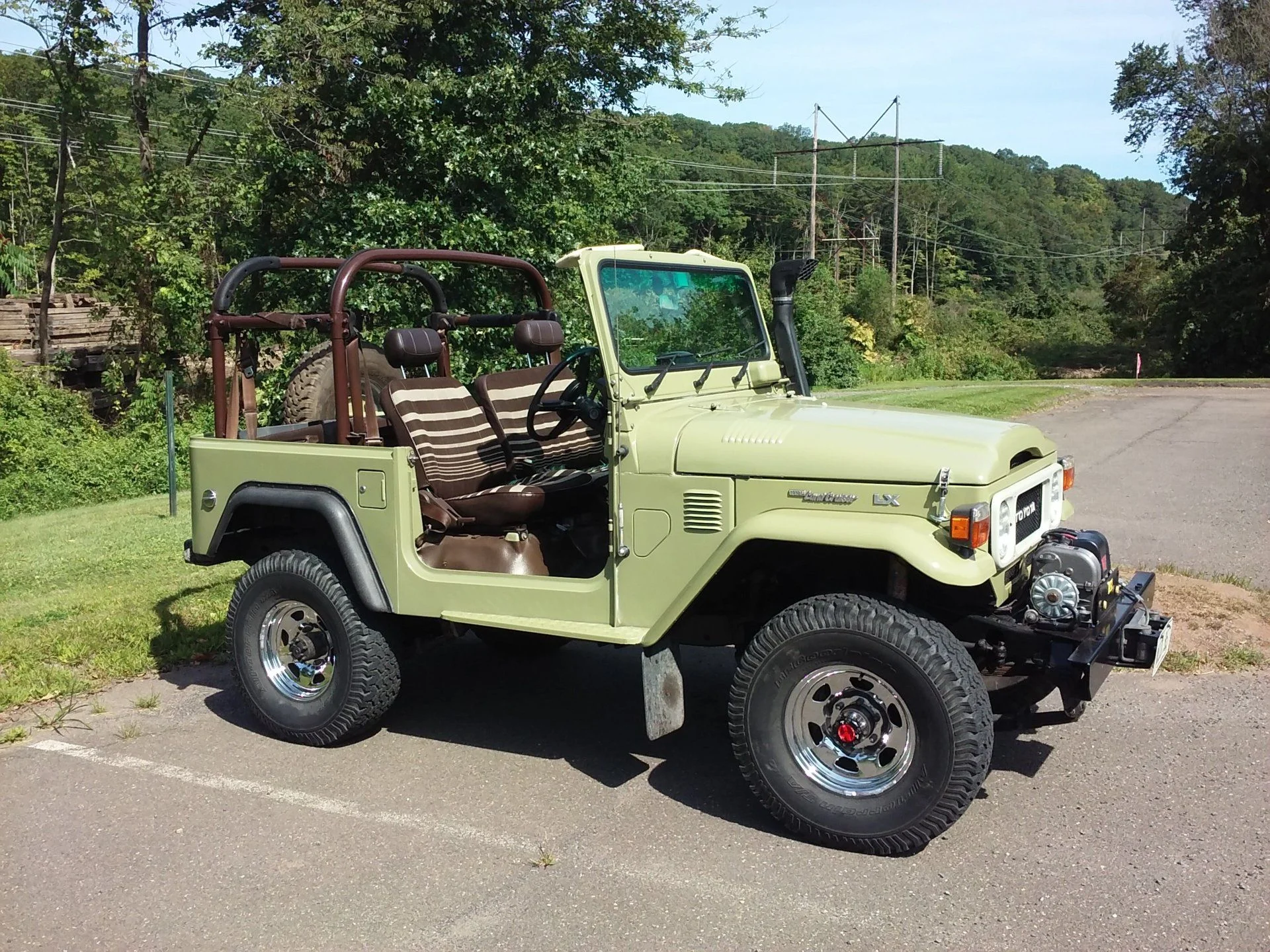

Another option may be the 16x8 steel 5 slot rims off the T100 pickups from the late 90's. I have these on my solid axle 4Runner. They have a back spacing similar to the stock wheels I think. They look good and can be painted easily. I recently put a set of the 15x6 chrome Toyota Fj60 wheels on my FJ40 with 33x10.5R15's. Looks and rolls nice. The truck had some great black 15x8 steel aftermarket with the proper FJ40 offset but I opted for a brighter "color" wheel tire package. Black wheels in storage in case I change my mind. You can see the slight sidewall bulge on the chrome wheels which are 6" vs. 8" wide.

Some 15” rims rub on the tie rod ends. A 17” rim should have no issue there. The rim size should not make a difference w clearance w the leaf springs, steering mechanism, or fender wells but the tire size and back spacing will. My guess is that 4.5” back spacing and 34” x 11.5” will be fine on back. On the front, I think you are just going to have to put it together and see.

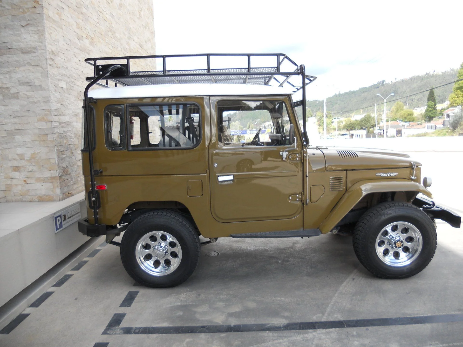

My '70 came with ION wheels, 15 X 7". No clearance issues, no spacers required. My '79 had a stock type of wheel. They do not have hubcap clips and are stamped made in Colombia (the 40 tag says made in Japan, but it is definitely a non-USA model). I had the steel wheels powder coated and mounted 215/75-15's. In the picture you see the Hankook MT's 235/75-15. They are definitely larger in diameter as well as a little wider. I'm not happy with the 215's. I am looking at ION rims in the 16 X 8 size. When looking at rims, and going wider, one has to keep in mind the effect on offset and backspacing. The stock rims are centered (5.5" + 1" for rim flange divided by 2 equals 3 1/4" which is factory spec for backspacing), so if you add 2 1/2" AND it is still centered you are moving the wheel outboard. I am happy with the General AT-2 tread, much quieter than the Hankook MT's. So I am looking into the 235/85-16 tire, but only if I can get the ION rims. Not so easy here in Ecuador where we have a much smaller market than the USA.

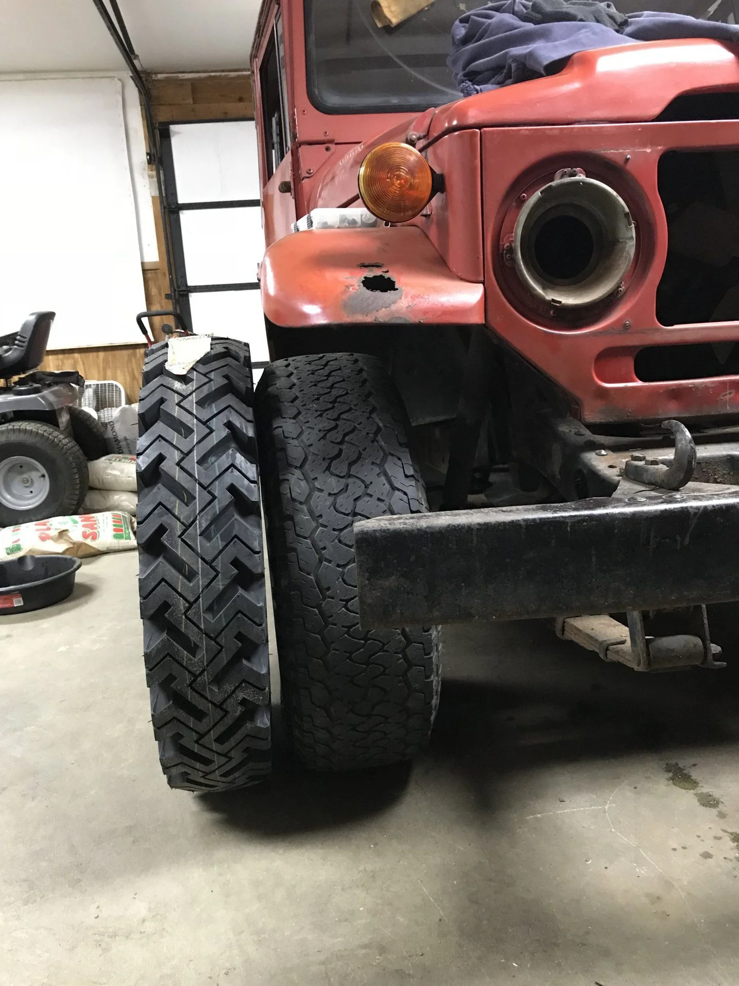

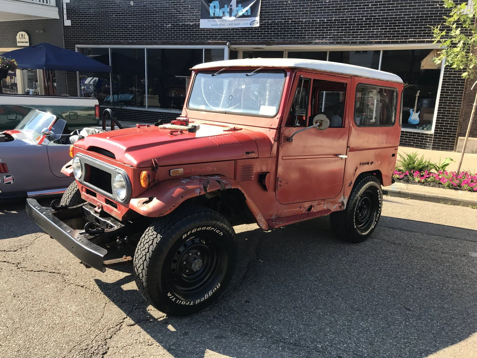

Hello, so I finally decide to register here after years of just feeding the great info that this forum has. Between this one and Tacomaworld I can probanly find DIY answer for anything. I just bought my first FJ40 2 months ago and I cannot stop working and thinking about things I want to work on it. Here is a pic of my new tires. I decide to get te real pizza cutter. This will work great especially for this Ohio clay/mud mix
I might start a tread about my built so people can alway suggest things and see the progress many dad my little brother and have on it

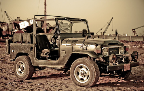

on the 17" FJs (BJ44V)^^^ can you squeeze a skinny on those, like sub 10.5"? nice looking 40 BTW dig the blue, those wheels look like the 100 series split style. ANybody tried mounting OE wheel caps on those?

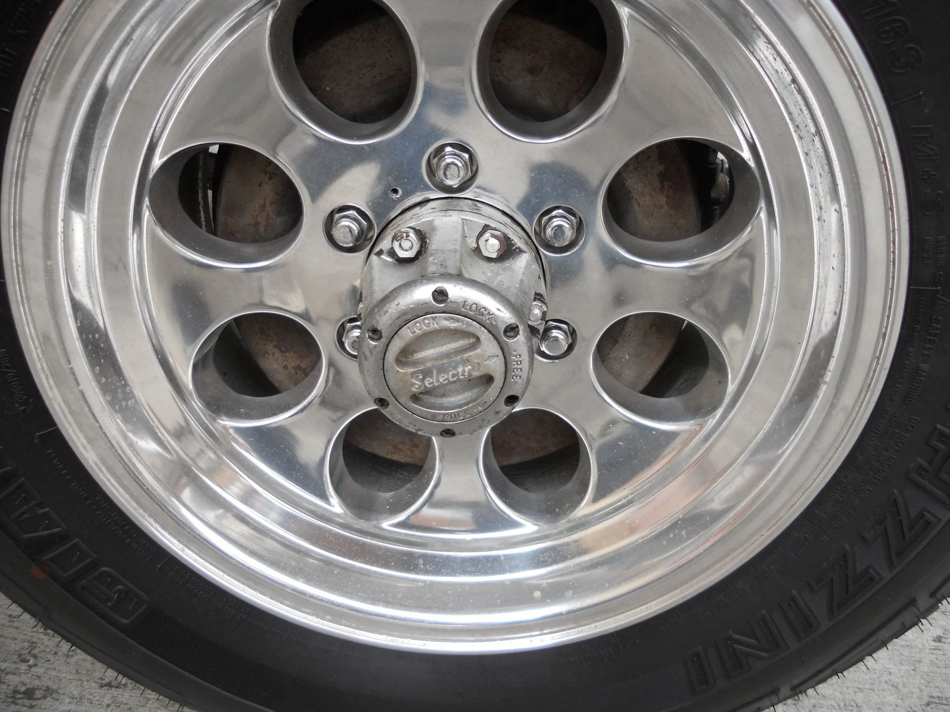

ION 8" X 16". I think they sell for less than $100 each in USA. I paid $1,150 for wheels and tires here in Ecuador. Second picture shows the "original" Selectro hubs, the ION cap would not clear them so I put new Aisan freewheel hubs on while doing the knuckle/wheel bearing stuff. This is a non-USA 40 with FJ45 drums on the front (larger and wider than the rear).

What brand and size are those new tires?
